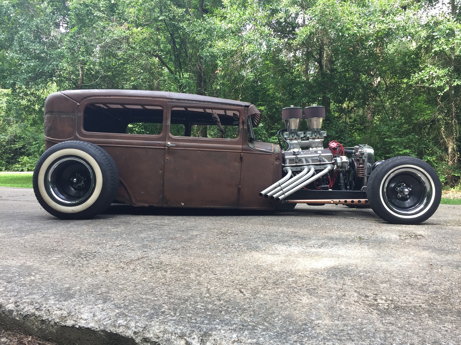

    mike yeah I plan on running a z frame but still want channel to hide the frame, I have been looking at a really low laid back seat, kind of like I ride now with my acura lol big guy little car,. moparobs a great guy and full of knowledge im sure glad that I was able to becomes friends and that hes willing to help me out
  17. If you are open for suggestions, I realize that yours is not a coupe, but you could do something like this with the full fenders and still maintain some headroom while still looking bad.

  19. coolbreeze1340
    Joined: Aug 18, 2009
    Posts: 1,340
    coolbreeze1340
    from Indiana
  20. Mechman_22
    Joined: Mar 18, 2014
    Posts: 205
    Mechman_22
    from Nc
    thanks I got some lower door patch panels and quarter panel patches. got to scrape some more penneys to get the rest of the patch panels needed to get the lower section of the body fixed up, coolbreeze1340 that car is great looking. I love the 32 frame,

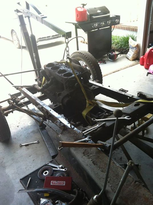

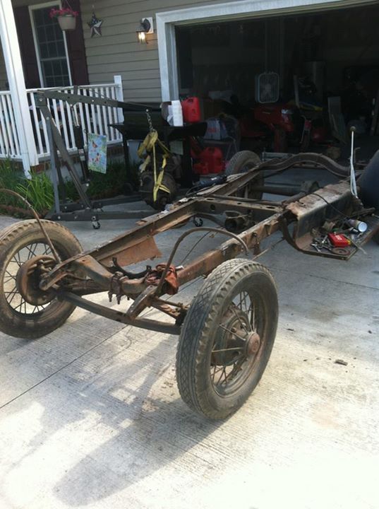

    got couple hours in the garage sunday and was able to pull the old four banger and trans out still have to get it down to frame but closer than i was when i started. on to the pics

  25. you asked about the serial number... it is stamped on top of the left frame rail behind the steering box.

    once I pulled the body off I looked for the numbers on the frame in that spot but nothing is there

    I didn't see the numbers on my 32 woodie frame until I went over it with a wire wheel.

    did that as well and nothing but ill keep look out

    "moparob"- that green sedan is killer" ( slant window with a serious chop?) There's some inspiration for ya, "mech-man"! And don't sweat the numbers too much- once the body is on, you'll never see them anyway. Buy a body number tag from an "A" parts place, stamp your own ID tag , and put it either on the top of the frame rail, or on the firewall. I do it all the time and have never had a problem
