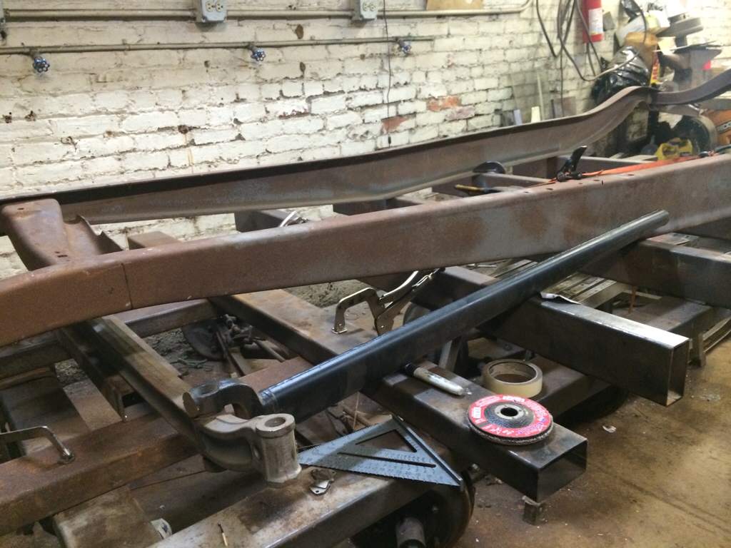

    47 Lincoln wish bones 36 front axle .
    41 x member
    Everything will be riveted . Trying for no welds on the frame
    331 caddy with a t5 . Undecided on the rear end still .

    All the bolts will be replaced with rivets . Gussets will be tig welded in .
    That should stiffener up !

    Just noticed how the X member gussets make the firewall meeting look a lot nicer. Never noticed how the front legs attach on '32 chassis that used a 35-40 X, is the 41 longer? Bob
  19. Flop
    Joined: Jun 8, 2006
    Posts: 3,885
    Flop
    Yes windshield will open just like any other early ford !
    No idea in the length Bob but I really like the look of it coming forward . I placed the x member where I wanted the pedals and where ever the rest fell into place is where it went !
