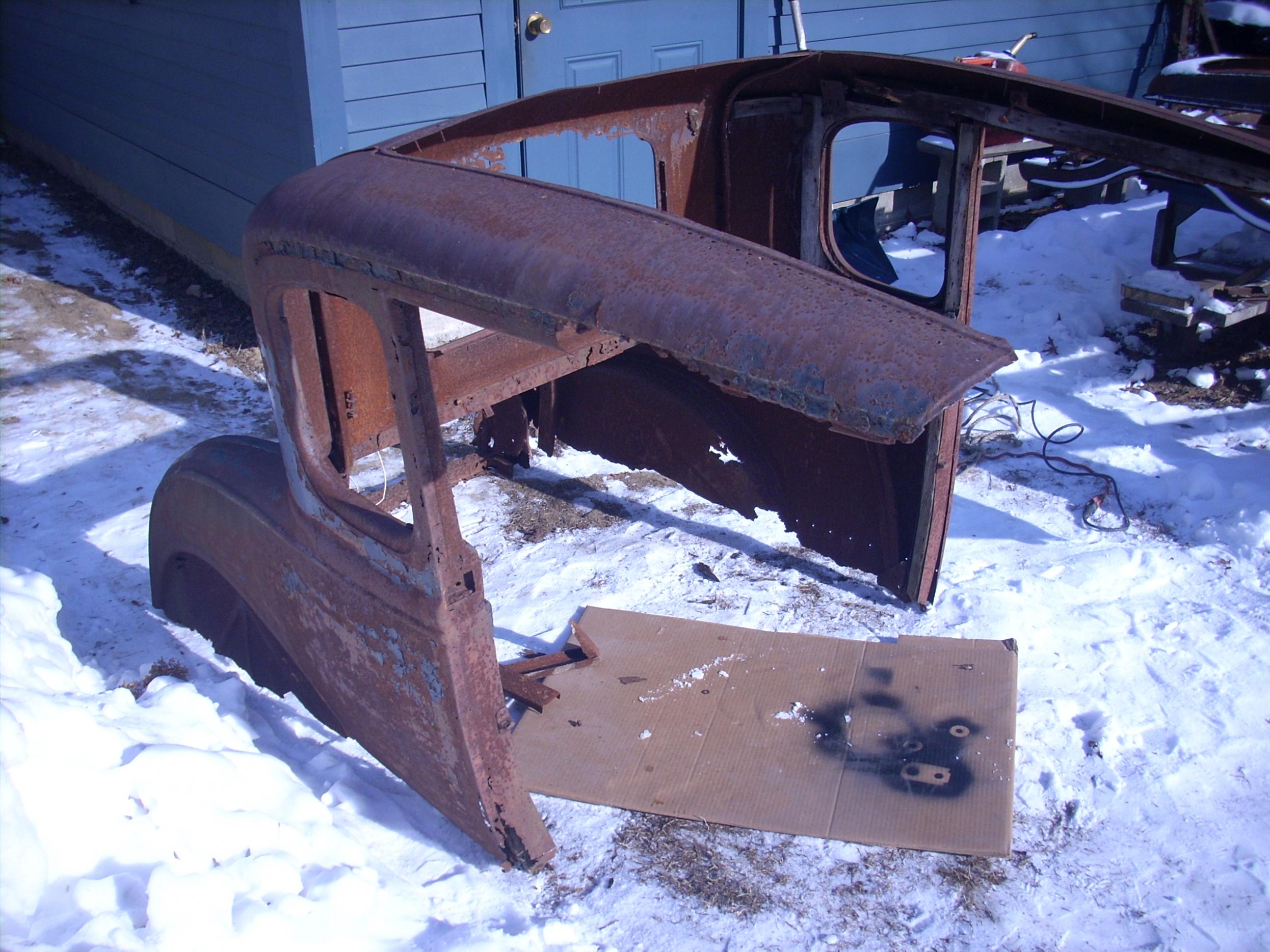

    woods coming out .. you know what that means .LOWER ROOF !! pics are just kind of a reference so i know how it all goes back together

    Dash looks great, that was one of the better Hershey finds last year. Chop looks great too. Bob
  9. Chop looks great.
    Maybe a stupid question:
    How are you dealing with reassembly of the wood where it needs to be cut?
    Are you making your own key pieces, or cutting down a purchased wood kit...(or maybe not replacing the wood at all)?
    I ask because I haven't chopped mine yet. My thought was to cut down a prefab wood kit and then drill and dowel as necessary to modify for the chop....

    i will be getting new wood and like you said cutting it to fit dowl pins and wood glue
    door top on
    i want to focus on one area each day i work on the car
    remade the top skin of the pillar due to the fact of pillar taper and a 6 and 3/4 inch chop . pie cut the inner pillar as well to bring it out
    pillar finished up

    so apparently where i cut my door was about the thickness of tin foil ... whats a man to do in this situation ? splice a new piece in of course !
    slowly when i have an hour or so of extra time work gets done

    little more time to work last night
    now to finish the inner and get all the dents out of the top of the door !

    Wow... Just wow! Just went thru this whole thread. Im a beginner and trying to pick up tools/equipment so I can tackle a project like this. What kind of tig welder are you using? Any pics of your other tools...hammers, files etc... Sorry for the newb questions, just want to do it right the first time. Learned a lot from this thread thanks for posting

    dark wing using a miller synchrowave . just your typical hammers and files nothing out of the ordinary . Thanks!!
    thanks paul
    creeping along on the chop

  28. Flop, looking at your bare metal finish work makes me realize how stretched out of shape my quarters really are. :)
    I keep seeing shrinking hammers for sale..but I've never used one...Are you using a disk, torch, or hammer when panels are stretched?
