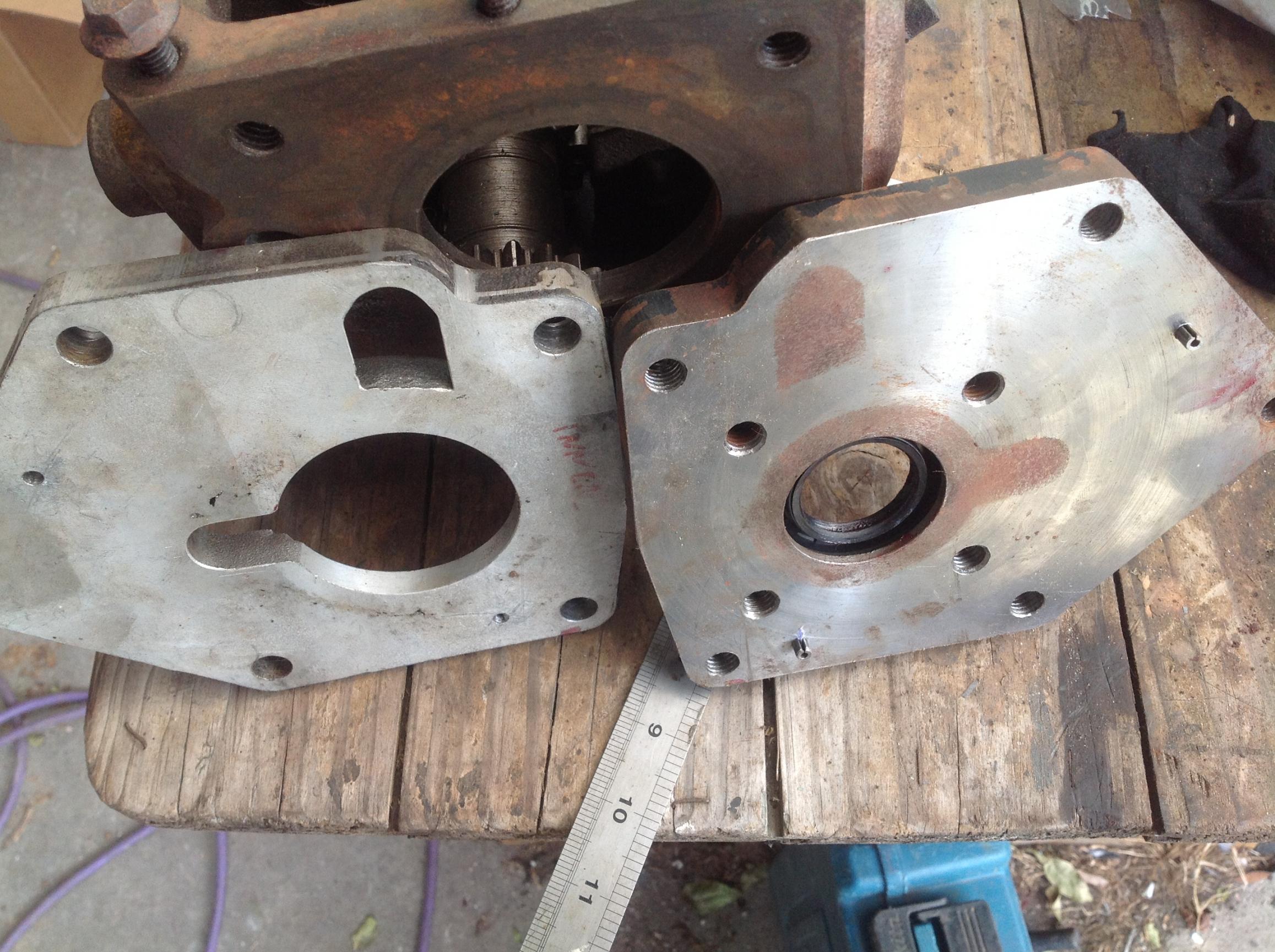

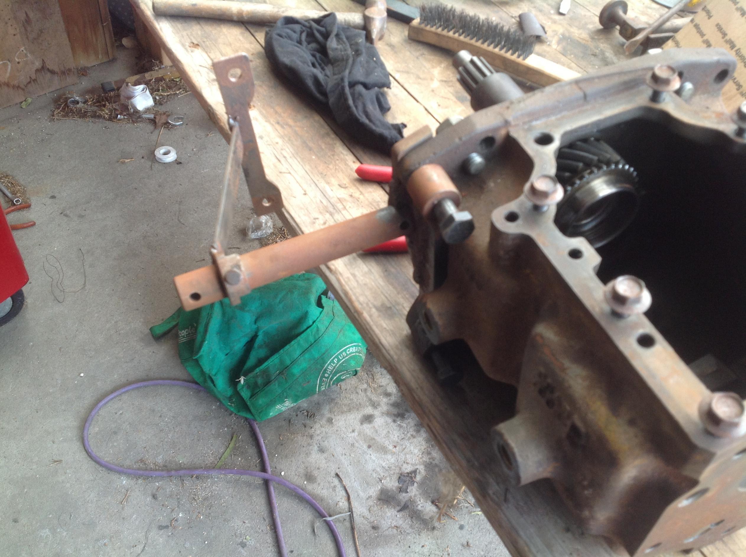

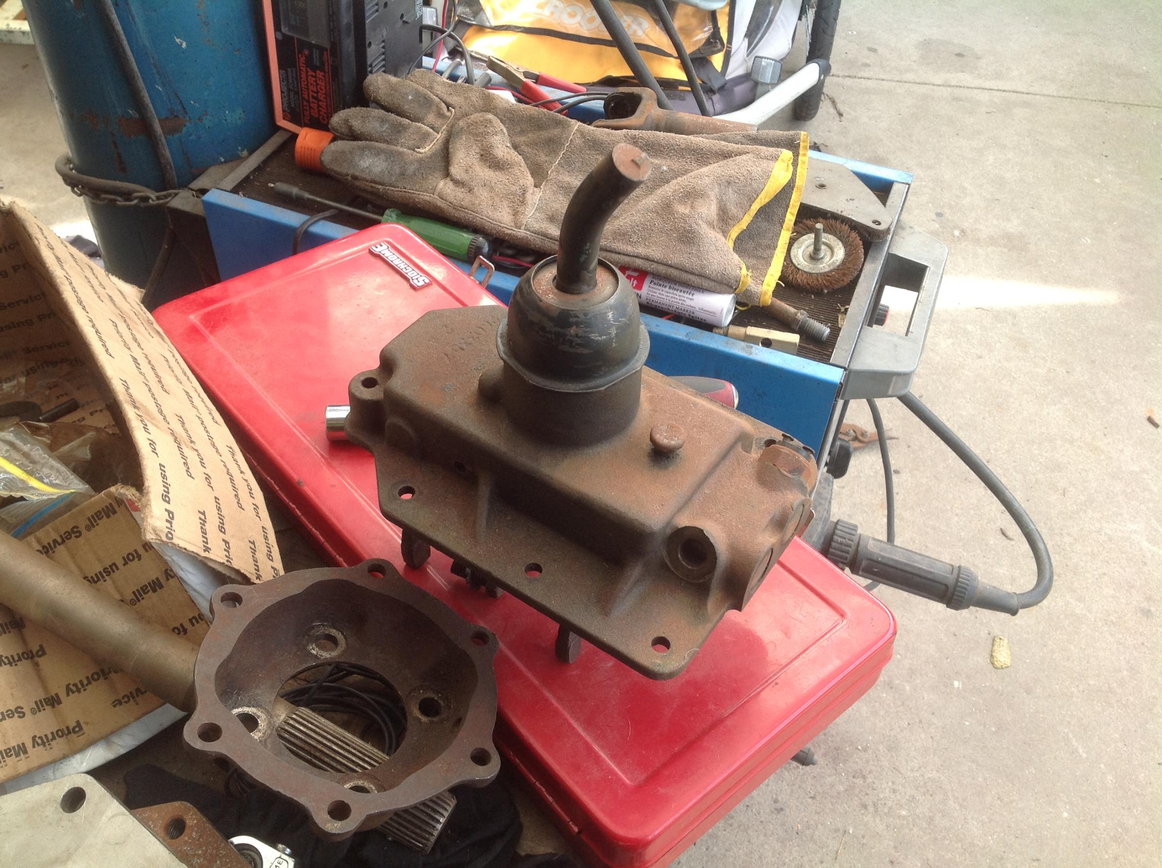

    i am almost done on a 3 speed late model all synchro conversion for my sons A coupe ,,AA B/H ,,Jeep T150 top shift,, image-10.jpg
    on the left is whats left of the extension housing ,it forms the support for the bearing ,and the steel plate has a raised area on the other side to mate with the clam shell ,,,i cant get the pic to load of the other side of the plate,,will keep trying,,

    image-4.jpg slow process pics arent loading too well ,,,

    as i couldnt get a F150 O/D over here i chose this trans. its from a 70 maverick for $40 US .shipping and a reco kit added its still a reasonable cost ,,the shaft mod cost $200 at a local machinist ,,he said it was pretty hard,,,its not 5 speeds but it will be an improvement over my existing trans.

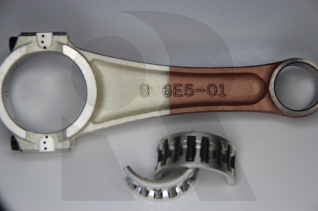

    I am thinking of using roller bearing style connecting rod instead of drilling the crank
    they can be made to suit a banger
    the crank needs to be nitride
    but they only need oil splash
    what do you guys think
