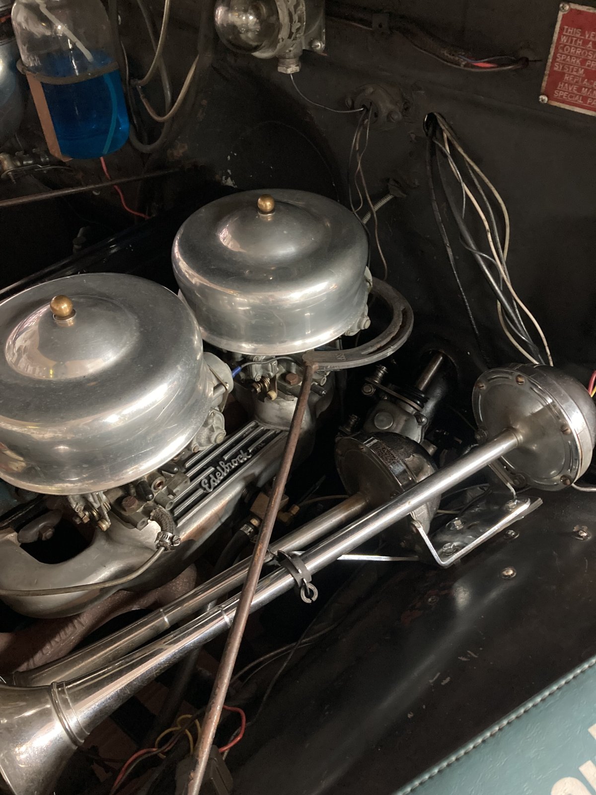

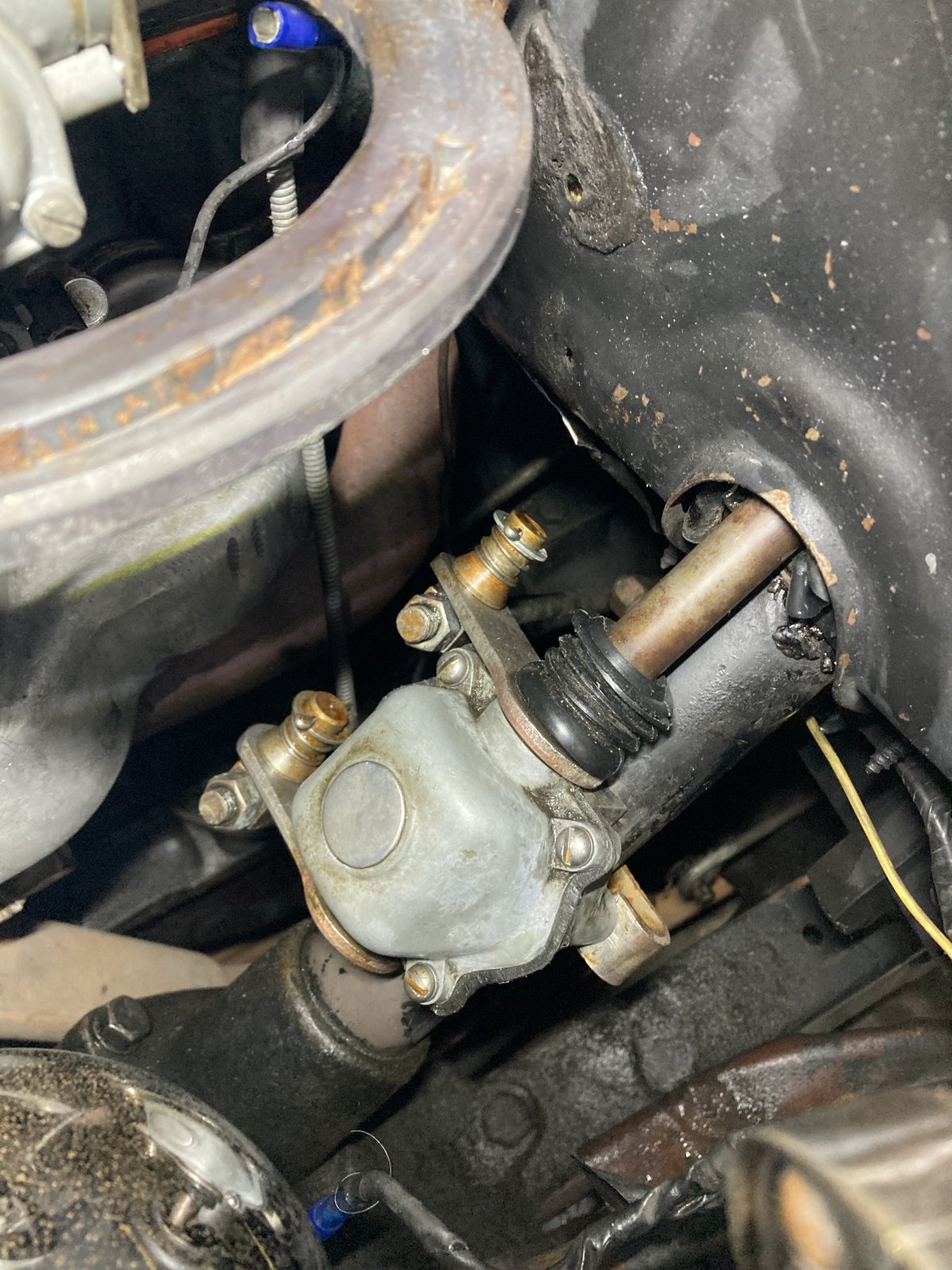

    I recently made a reduction in length to the column shifter arms to accommodate a 1962 261 engine with a Clifford intake.
    Here is the present 1956 235 with the shift arms reduced in size.

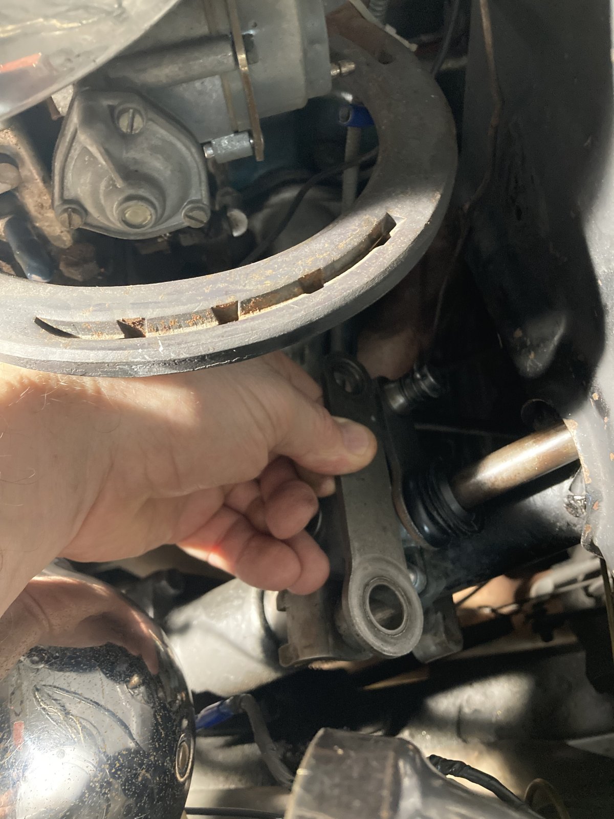

    Here’s a picture of a stock Reverse/First arm for comparison. I moved the pivot hole 1 1/4”.
    These pivots are worth their weight in gold.

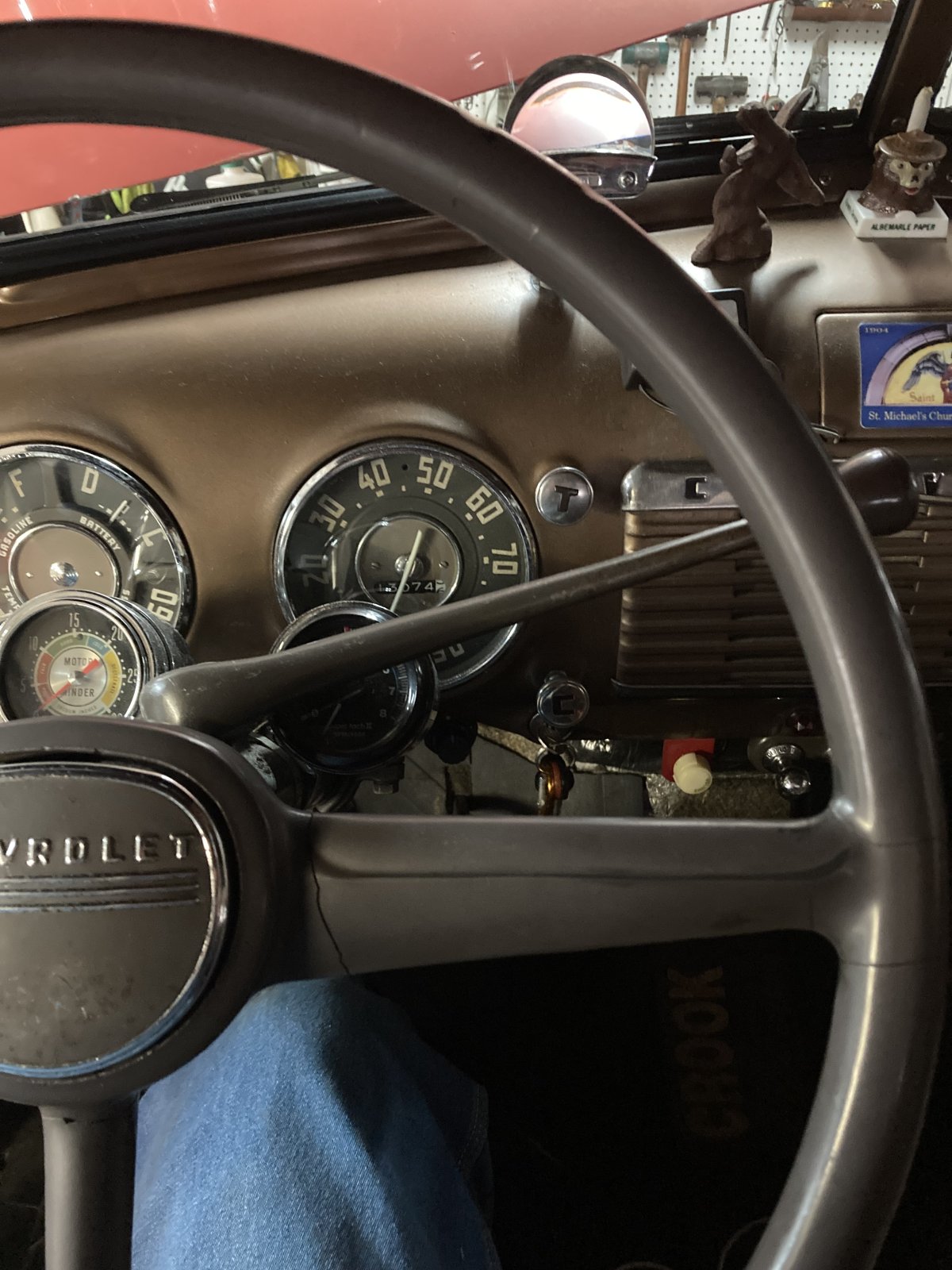

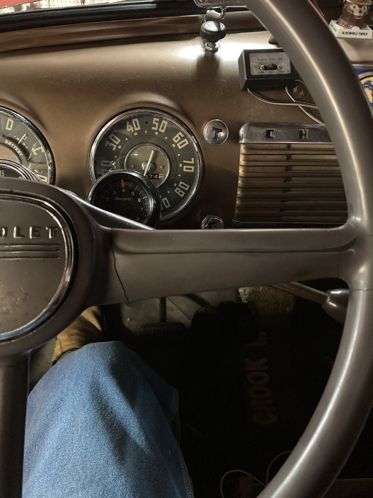

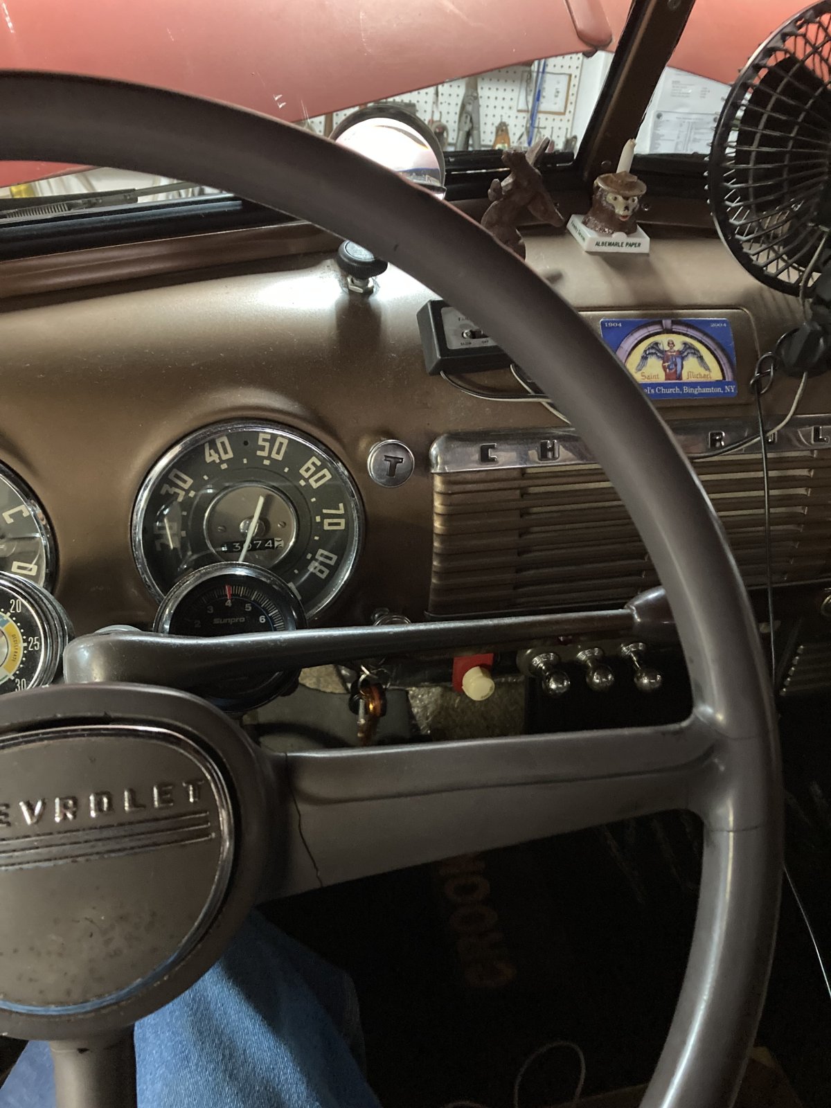

    Business seat, 3 o’clock, Neutral position.
    Reverse or 2nd Gear (same throw).
    First or Third (same throw).

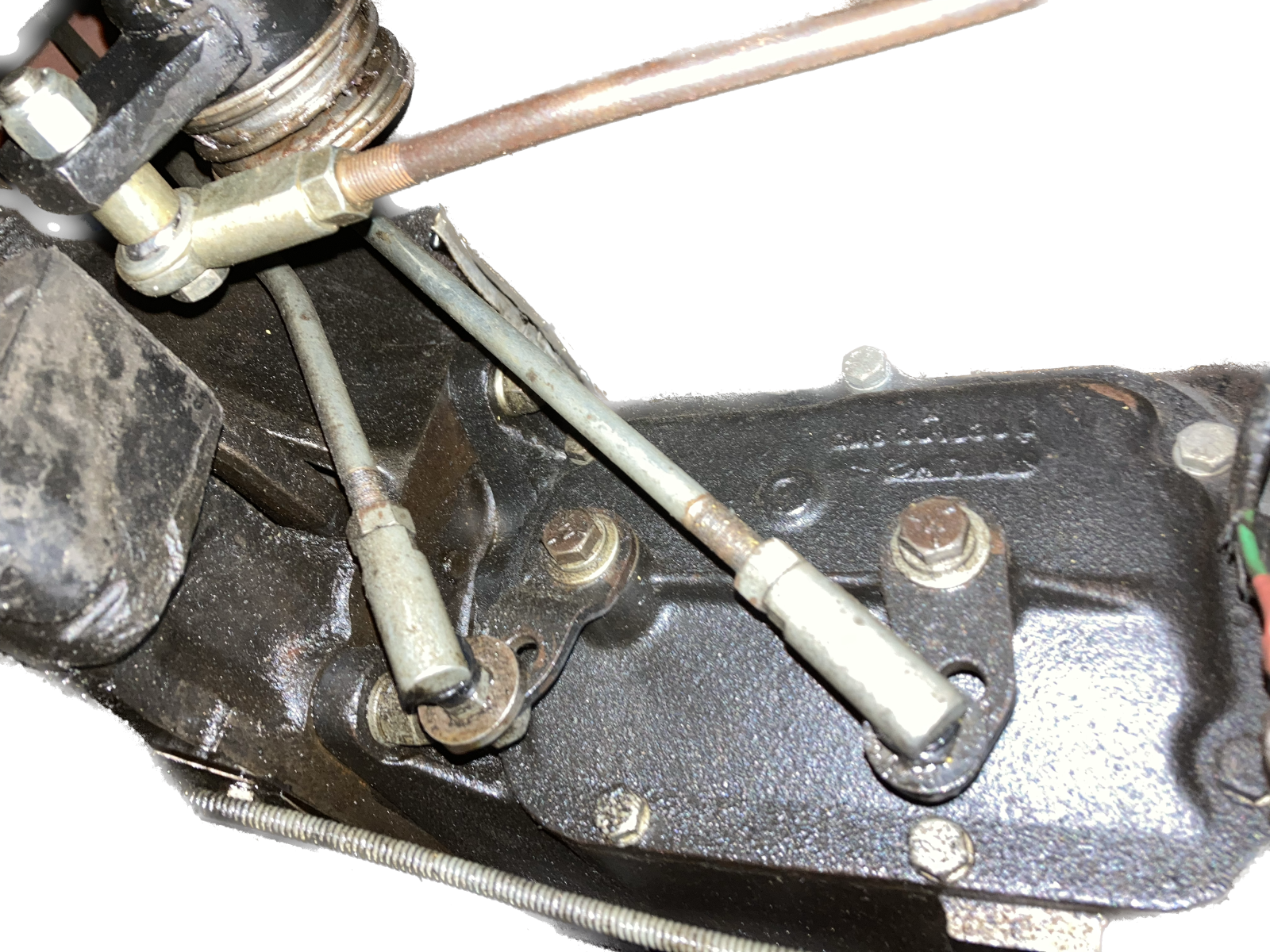

    I cleaned out the shift box and topped off with Cornhead Grease, good for another 74 years or so.
    This is a non native 1969 Saginaw/Borg-Warner 3sp+overdrive shift plate. I made my own rods and used Heim joints that are smooth and easily adjustable.
    Shifts like a hot knife through butter on the table of a non air conditioned 1950’s Virginia home in summer.
