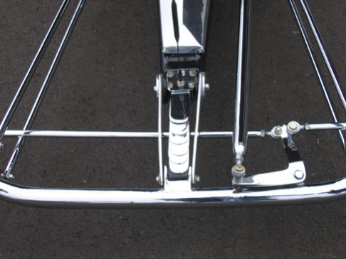

  8. I know here we go again but I cant help it. Ive been around a long time.
    I have it on my senior dragster. I am going to the shop now to get you a photo. hang on. You still need shocks though. I put mine on a 45 degree angle to give control in both planes. Bottom link in centre is a 1/4 eliptic spring made from a 69 Dodge Dart rear spring. It is quite short but works about perfect for this car and its weight. Car handles very very well. in fact if you watch the video from my website you will see it goes very straight. Suspension still works as can be seen in both the video around the yard and the last race video. It drives like a normal car with no bad habits. Tis a long story how I got to do this design but I will save that unless someone actually wishes to know. So anyway yes it works and it works well. You can blow these photos up for a better view.
    Don
  9. here are the pics
  10. Don,
    I can see the front end of your car working based on the fact that you're not putting big lateral loads on the suspension, and like you said, the distance from your axle to the pivot is very short. wsdad is building this for a street car which will see much more cornering and braking loads, not to mention all the other things a street car would see above and beyond what a drag car would see. Not trying to discredit you at all don, I think your setup works fine for what you use it for.

  28. Allstar, Ed Roth built several cars using VW torsion bars to spring a drop tube,
    I would have to re-read his book, but I have this feeling that he got the ideal from someone at the local drag strip.
    The 1/4 centre mounted spring, I like, I have seen all the arguements against it,
    and some of the points are valid, but I actually like the thinking, it's a very simple design, it constrains the axle in all the right directions, I am not that keen on 1/4 springs, but using the spring as an axle location is quite a neat way of making use of it's properties, I don't think I would want to try this set up on the street with brakes on the front axle, but for some thing fairly light on the front with little or no front brakes I could see this working.
  29. I must confess it is a bit funny reading how something you have already built and used succesfully wont work. Always makes me smile. I agree though it is not a street set up , just an intersting experiment. Of course lots of dragster front suspensions would not be practical in daily street use. That should not be a shock to anyone.
    I am anxious to see how the double 1/4 eliptic works in the new car. As far as turning the spring sideways and adding the rest. It would make little difference in this car since the load point is still in the centre . It would however add about 20 to 30 pounds to the car. And yes I understand that weight will be there with the double 1/4 eliptics so it may be a moot point.
    Don
