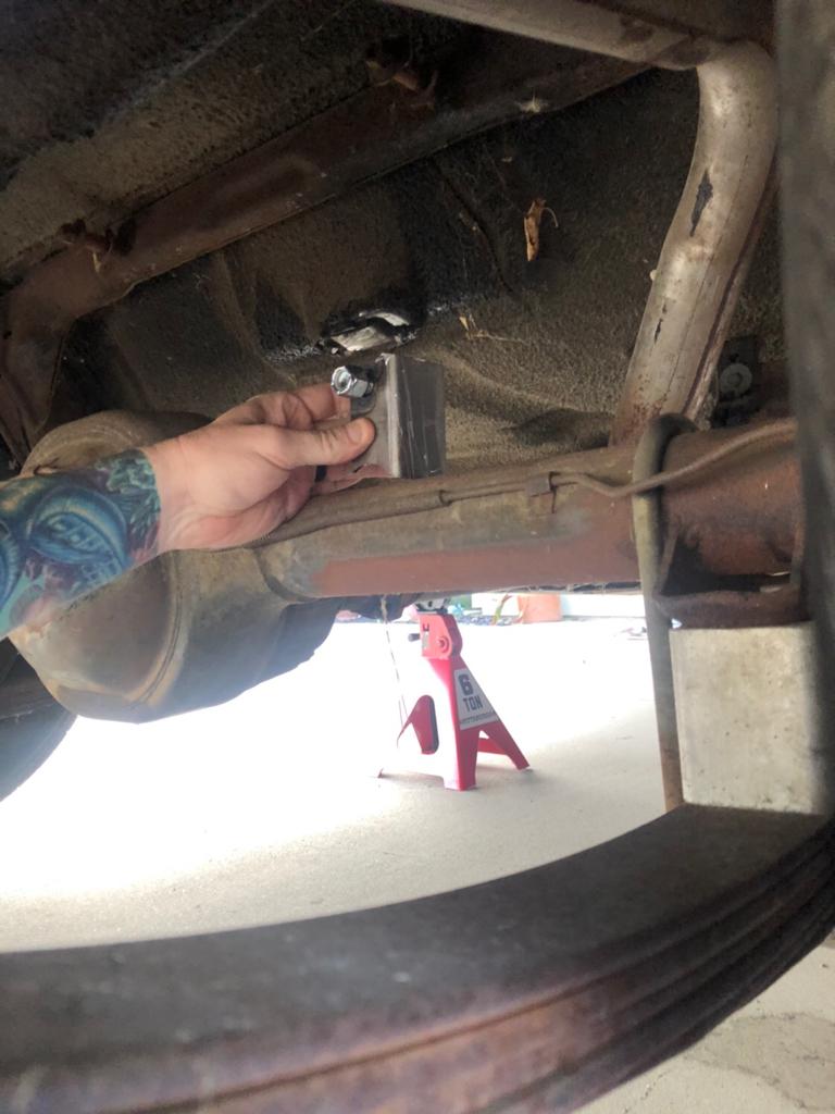

    My high school auto shop put 3 inch lowering blocks on about 12 years ago and then it sat, unfortunately. I like the stance and am scared to cut into the the body. I’ve been thinking of air shocks but I need to weld mounts first. I’m just getting started and don’t have a lot of experience...yet. Here’s a pic of my axel and where I’m thinking of mounting. [​IMG]

    Dude.... mount the shocks off the u-bolt plate... :cool:

    With no shocks that thing should be bouncing all the time even after you stop. Not safe and should not be driven. Mount them on brackets under the springs and at least to the body like the cheap Chevrolet’s. I cannot believe that car would not still have the upper mounts.

    Weld a stud and reinforce the lower spring mount and then measure distance to top shock bolt, at ride height.
    Then jack up car and see extended length, then load it up to see compressed length.
    Shocks will help ride ALOT.

    Shocks-yes, mounted to the top of the axle- no
    Even if it were a good location, your shock would be like 4 inches long.

    Those shock mounts (if that's what they are) go on the bottom of the rear end not the top.

    stop - do not drive until repaired - stance is important for the "Cool" look - damaging your ride in the process is not - where did the shocks mount on old rearend? - usually the bolt plate under springs has a bolt stud or eyelet for attaching bottom of shocks - there are aftermarket brackets that can be welded to bottom of axle housing for shocks - but, need to know how to weld good - not all cars can run 3" blocks without notching the frame, etc - shocks are not to be mounted straight up and down

    Stock shock mounts are on cross member right above hand in picture. Previous post of attaching shock mount to bottom u-bolt plate would be about right.

    And, of course, you need shocks. Your proposed location of the axle attachment point is not great; for optimum effectiveness, this should be as close to the wheel as practical. They can be vertical, or leaning in at the top, up to 30 degrees +/-. In theory, the more they lean, the stiffer they should be.
