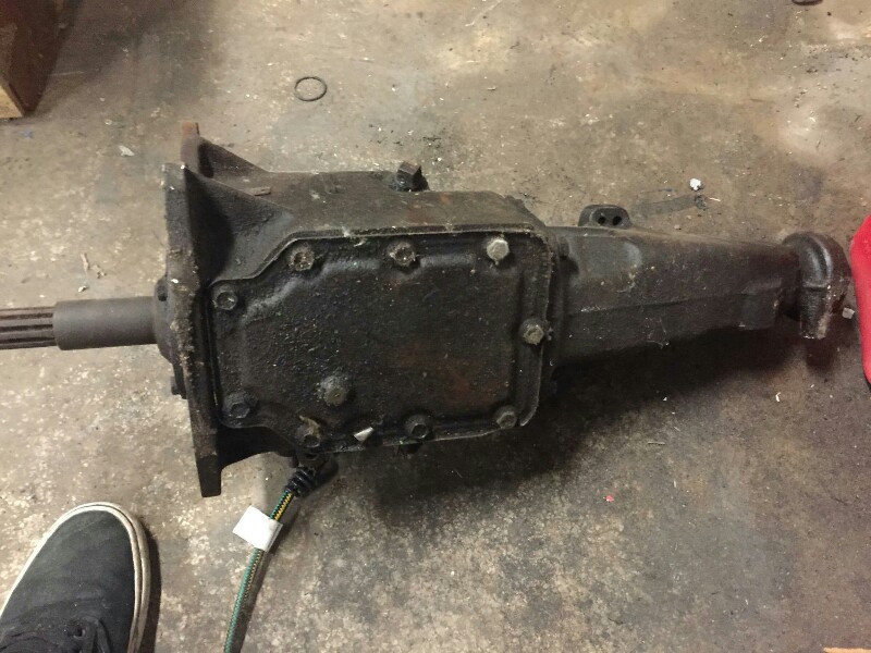

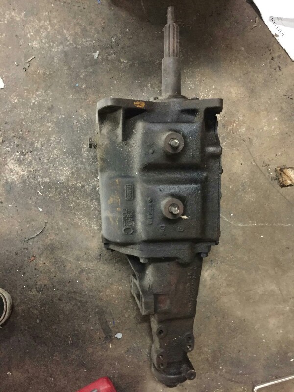

    Can anyone help with anything on this trans? What it came out of? Ratio? I don't have it in front of me. Just these 4 pictures. Thanks. 8332-600x800.jpg 8334-800x600.jpg 8330-800x600.jpg 8328-600x800.jpg

    65 ford fully syncrinised 3 speed , used for a number of years , as your tailstick indicates c8ar ,thus was out a 1868 vehicle .Chevrolet also used this transmission as they did not have a 3 speed strong enough for their pontiacs .I believe they only changed the input shaft to fit a gm clutch disk .try a ford disk out it and if it dont fit it is likely a gm shaft or vice versa

    That's a Dearborn I think. One of the Ford/Tremec 3 speeds that got put in the Pontiacs. They are basically a RAT code 3.03 with a different input and tailhousing. Should be GM style 1.125 diameter input and the tailhousing gives a mounting pad for the Hurst or Hurst style shifter.

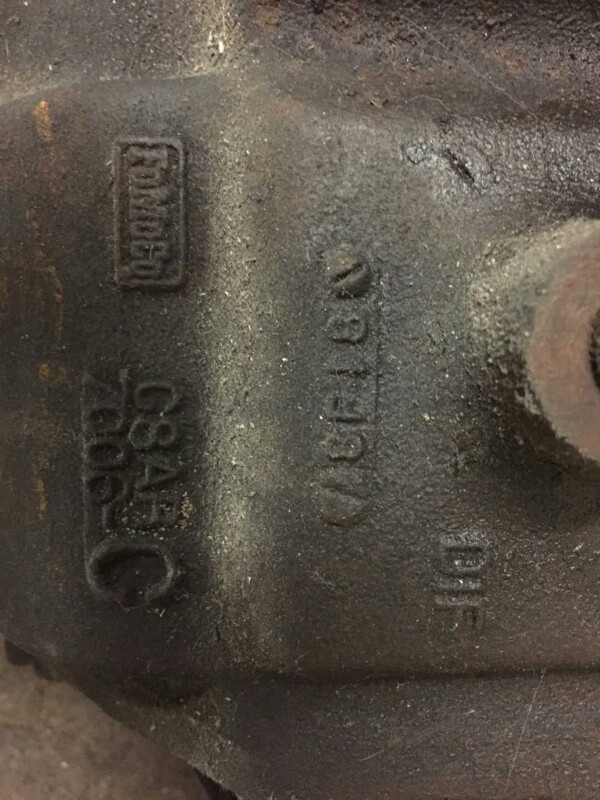

    In the second photo it looks like a tag is riveted to the passenger side near the front of the case. You want the numbers / letters off that tag to identify the transmission.

    Confirmed it is the dearborn m13 RAT. Anyone can't live without it?????

    It's out of a 68 or newer ford. The "C8" is 68 on the case.
  18. Looks like a '68-70 Mustang trans to me. Ford 10 spline input, shifter mount at the end of the tailshaft. Long pilot bearing shaft means it's for a small block, not an FE.

    It looks like it still has the tag on it. The code on that will tell you what you want to know.

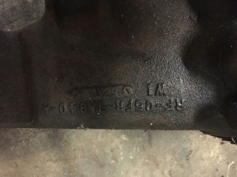

    The tailshaft has a very interesting casting number, RF-C5FR...
    The "F" in C5FR indicates foreign or racing application, according to the various Ford part number decoding references.
