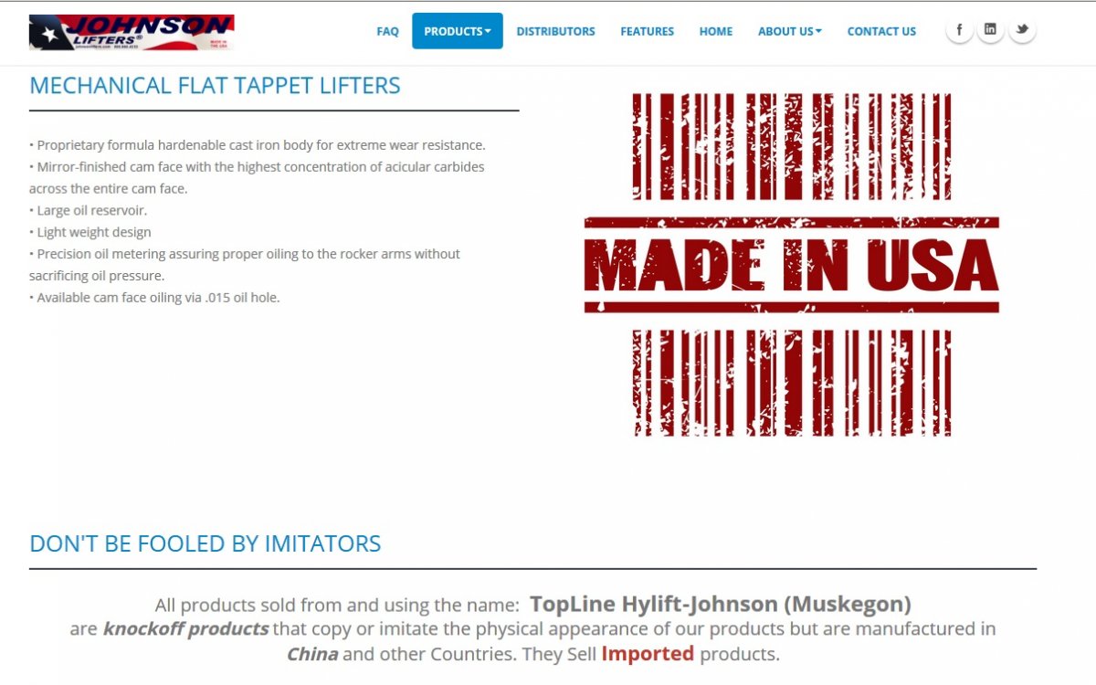

    I called Johnson lifter company and talked to the guy who owns the company. He no longer makes flat tappet lifters. Only roller lifters. He was really interesting to talk to. His reasoning for no longer making flat lifters is the foundries are not using the proper metals like chromium and nickel among others in the castings.of course he would like to sell me a set of roller lifters, but he was very convincing. Just so many of you have such different experience s that you have shared, makes me really consider the roller cam as the best way to go. Just so you know, I have used Elgin cams before and had very good service from them. And I did notice that the cam I used with the 204 and 214 duration, was listed by several manufacturers, at very different prices..
    ekimneirbo likes this.
  15. From their website (look at the bottom):
    ekimneirbo and Budget36 like this.

  18. I don’t mean to piss on your foot and tell you it’s raining, but..... Detroit went to rollers for several reasons, but because they couldn’t get good quality parts isn’t one of them. Fuel economy and emissions reduction are at the top of their list.
