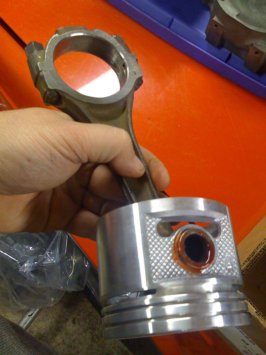

    heres a pic of the buick pistons assembled to C2AE rods. I used Wristpin P-2260 from Sealed power. The Conrods had to be narrowed a little bit, about 0.100", and the piston has to be honed out 0.028"

    I'm not trying to discredit what you are doing. I love your ingenuity. I'm all for cheap. I just wonder how much you will save, given all the machine work involved, over ordering a custom piston fo your desired cr.
  4. Pir8Darryl
    Joined: Jan 9, 2008
    Posts: 2,488
    Pir8Darryl
    Custom pistons are running $850-900, so overall it's about even money, but going with lighter stronger rods and adding CID's to the package has benefits over and above just a custom set of pistons

    283 bore is 3.875....312 is 3.80 ... so you would have to overbore the 312 0.075". not outrageous.
    the deck heights are close, the 283 is 1.779, while the fords are 1.760.
    the fords are 0.040" in the hole, while the chev would be 0.021" in the hole.
    You still have a problem with pin and rod diameter mismatch, same as with the buick pistons. The buicks go up to 3.860, while they are zero deck @ 1.800.
    The problem is you would have to ream the y block brass bushings and find a floating 283 ($$$) piston to get things to work with the original floating pin rods. Or use a press fit piston pin and do the same thing i did ...get rid of the bushing entirely and convert to pressed in.
    but then you would end up with the same cost and less compression than the buick piston.
