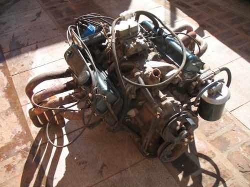

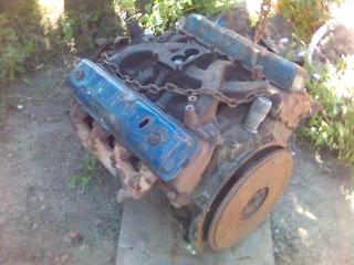

  8. fairlane2k
    Joined: Oct 7, 2004
    Posts: 69
    fairlane2k
    from Oregon,USA
    Check out these pics.... shown is a Argentina made 292 Fase II
    the block looks to be unchanged from the typical 292/312 engines
    But it has a set of Argentina ONLY cylinder heads...very similar to 289/302/351W heads!!

  10. RichFox
    Joined: Dec 3, 2006
    Posts: 9,979
    RichFox
    Wow. I like the Argintine heads. I looked at Windson/Cleveland gaskets on a Y block head and the bolt holes lined up except for two. Bore spacing was good. Never looked at water holes. Thought about it but couldn't think of a good reason to do the deed.
