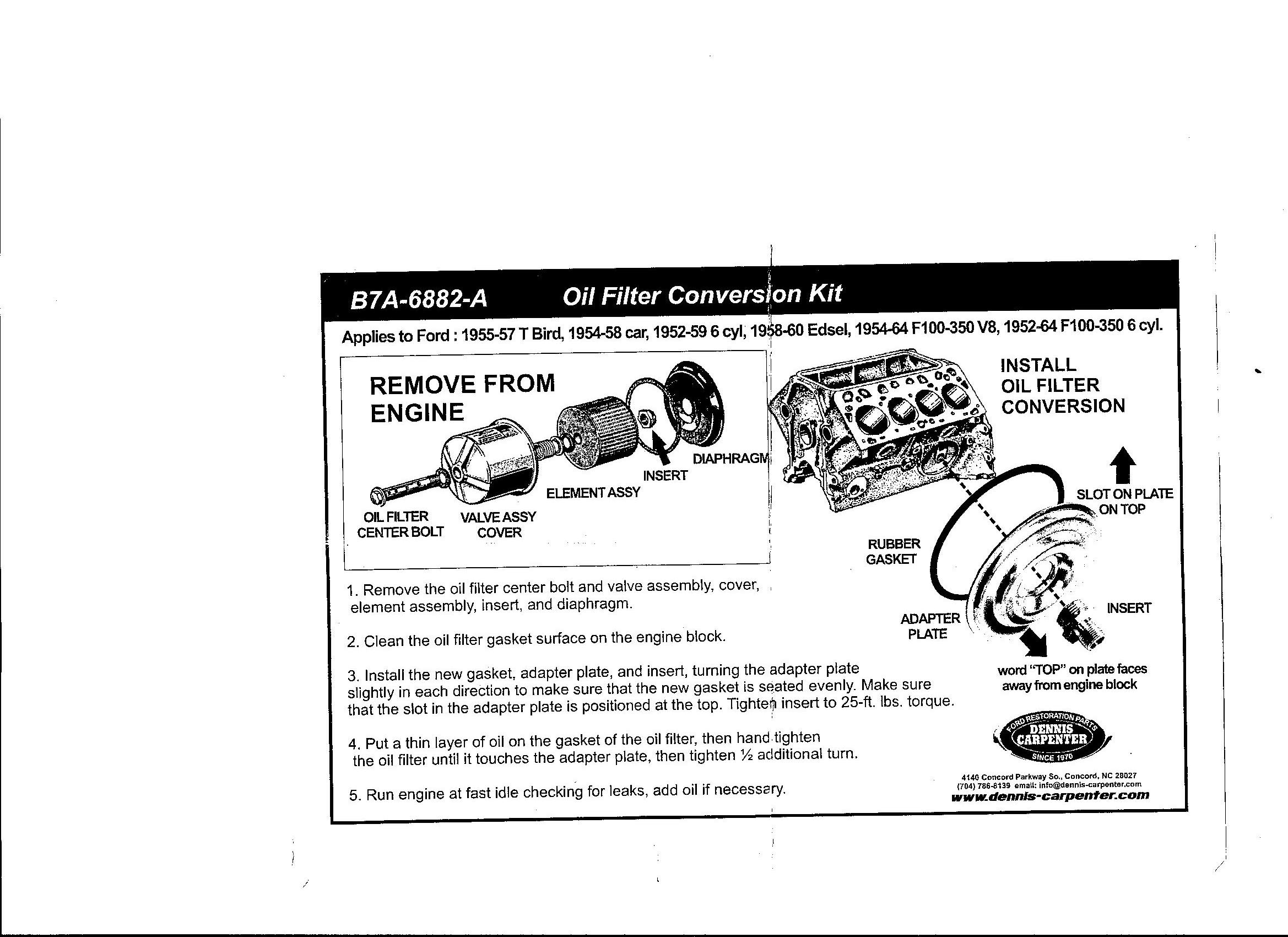

    Apparently there are 3 different ways to do this, I have the adapters which have the .750 block side and .750 filter side in both course and fine thread (Ford-Chevy) I guess, well Dennis Carpenter has it where the block thread is 1"-12, get rid of ALL the stock stuff and put adapter in place. See attached scan, this is the way to go when you have nothing to start with like me. Same part # as a lot od places carry, they should note the thread count so you know what your getting. Same Ford part# as all. B7A-6882-A

    It has been awhile since I put a spin on filter adapter on my 317 Lincoln Y-block. As I recall, I believe I left the threaded insert in place and then put the o-ring and retainer plate right over the supplied threaded insert, or perhaps I threaded on the retainer plate. But I am pretty sure I DID NOT remove the original insert. The supplied insert is .75x.75 for threads and found that it would screw into original insert. All I know is that the filter fits fine and does not leak.
