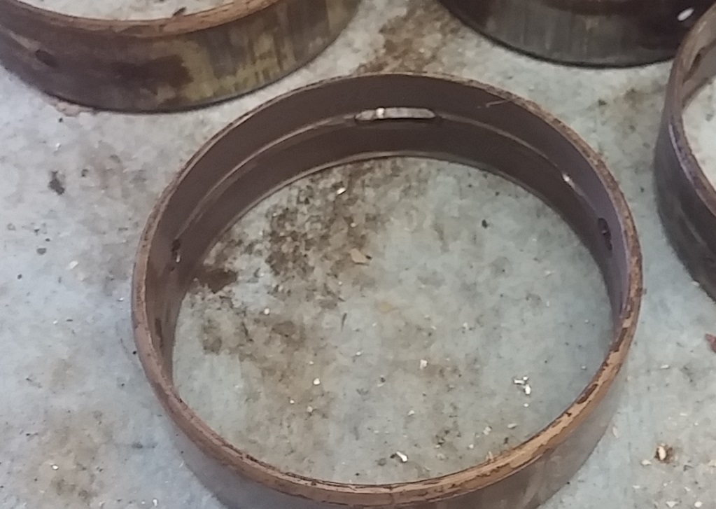

    also the cam bearings are kind of narrow, and when they wear, the cam drops a little, and does not seal the groove in the cam journal that sends oil to those clog prone passages in the head gaskets. There are several problems with the design, but you can make it work with the stock parts, if you pay attention to what's happening.

  27. Ive got a 62 Y block from a F 600. It had the crossover pipe single exhaust. I pulled it to install a 75 FE 360 mill. The 292 has the steel crank. It also has one bad piston. However the piston isn't the same as a passenger car 292.One other tidbit. A 292 ford and a 287 Pontiac used the very same piston rings.

  30. Did you ever find a better or wider cam bearing. I used to always hear about spun cam bearings. And Ive taken apart lots of Y blocks that had dry rockers. and never found a spun cam bearing. I agree that the design flaw of too little cam bearing surface allowed internal leakage that caused the most trouble.
