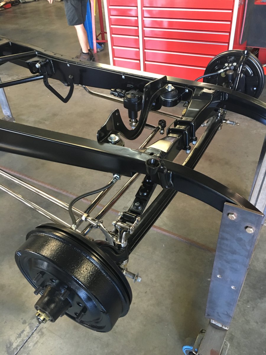

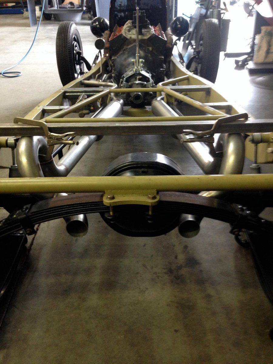

    • image.jpeg It's been almost A year since my last update. The building is starting to pick up steam so here's a few pics of the progress so far. The frame is powder coated, brake lines are run and plumbed, the suspension is hung front and rear. Stainless 2 1/2 " exhaust tucked up tight. Had a couple items plated to break things up. Decided to go with nickel because it's not as bright as chrome but still looks good. Just waiting on the new motor because the old 327 I had set aside turned out to be nothing more than a boat anchor. Going with the crate 350 dressed up to look more like a traditional build. Offenhauser intake with three deuces, and a

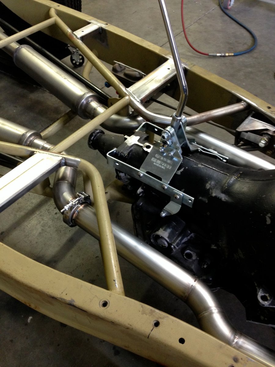

    i see you are using a Gennie shifter... have one in my `28 Tudor and love it. my `30 coupe has a Lokar , it's alright but not as good in my opinion

    I went the Gennie so I could use my own shift knob, a purple glass doorknob that came out of my grandparents Victorian house built in the 20's /30's

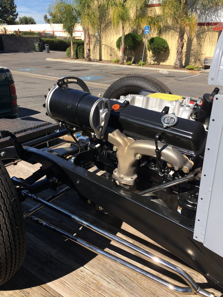

    image.jpeg Just got the word it's ready to come home so I can start doing my part. The 4 barrel manifold is temporary till we get the cam broke in. Easier than the untested three deuce set up it will run. Valve covers will also get swapped out for some vintage Cal Custom finned ones. Still a lot to do but moving forward

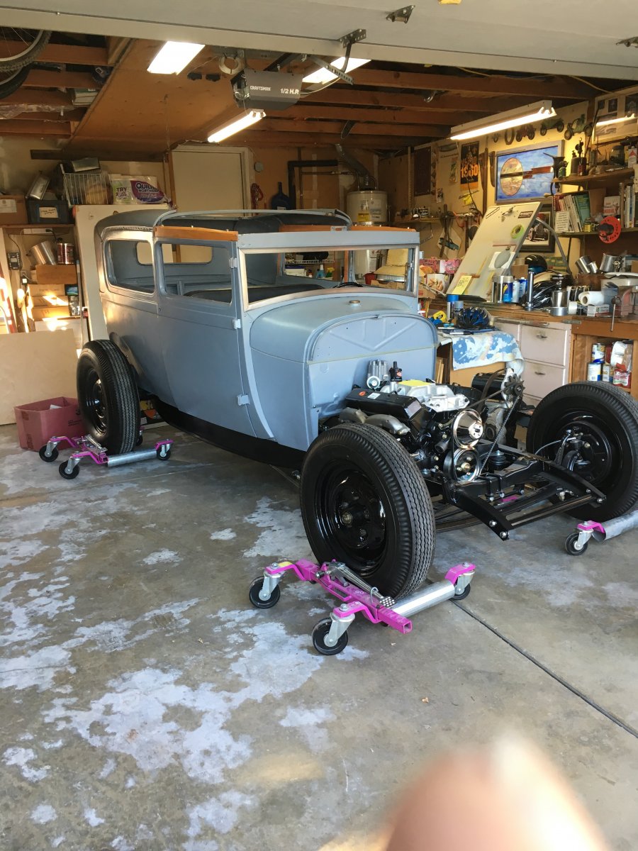

    seems like for ever but finally got the '29 in my own garage to start doing whats needed to get it running. All the metal n chassis work was done by Steve Pattee at Pattee Enterprises out of Modesto. Nows my turn to take the next step. Im kinda new to this so Ill definitely be hitting this board for more info n help. Heres some pix as to where its at now. Long way to go yet but lookin forward to makin progress.

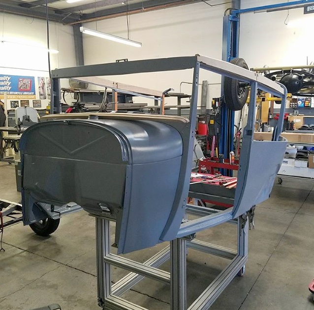

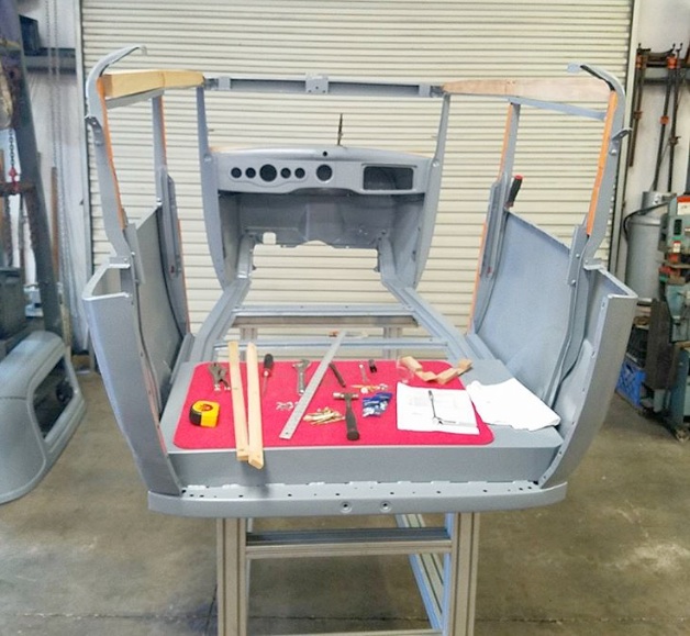

    Update on the build. Got the new floors in and seat repositioned and bolted in. Did a rough moc-up of the fan shroud then a final in cardboard for a template. Shroud will be built using 16g aluminum. Bends on sides hug the radiator tight enough to allow me to put some plastic edge trim on so as not to have metal on metal on the radiator. The bends on the top and bottom butt up to radiator with enough clearance to use the same edge trim. The fan will mount from the inside with it sticking through about 1/4". This will make the whole unit 1 piece and can be slid into place from the top. Shroud will be mounted to radiator brackets in 4 corners with additional support from brackets I plan to have welded to the shell. shroud 1.jpg shroud 3.jpg shroud 2.jpg shroud w_ shell.jpg seat w_new floor.jpg

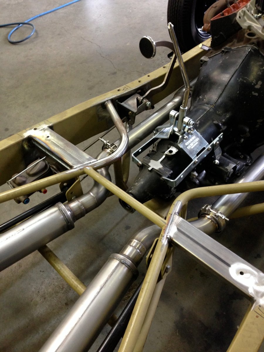

    Tell me about the brake pedal & m/c mount. Manufactured or home-made? What about the rod between them?
    Thanks!

    Brake peddle n master cylinder mounts home made. The rod will have to be custom done once the floor is in place to determine pedal travel

    Mikie likes the fan shroud... thanks...gonna use some of that method...

    yes it is. I wanted a Hurst motor but the one I had only would allow for an electric fuel pump. Steve fabricated a new one and off set the ear on mount so I could use a mechinical fuel pump

  26. Looks good and certainly very clean. I like the wood kit too.
    The front edge of the cowl almost looks to overlap the frame, how did you set up that forward body mount?

    [​IMG][​IMG]
    Here's some close ups. The sub frame sets right on the '32 rails, no blocking like a stock Model A. That may be why it overlaps up front. The '32 frame was built by Kiwi Konnections in Bakersfield that's pinched to accommodate the Mode A body's. It is a highboy, not channeled
