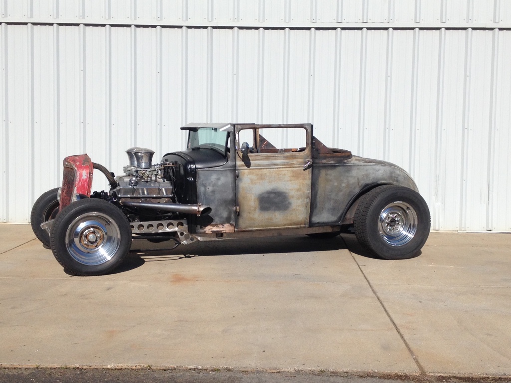

    My sport coupe project. Good start, but building a garage slowed things down. DSC01430.JPG
    dwollam, Fern 54, Stogy and 2 others like this.
  15. Vanness
    Joined: Aug 5, 2017
    Posts: 410
    Vanness
    Point brought up by my friend. Radiator should be top of cowl height or close right? I’m not running a hood.-And have thought about it as it’s coming soon. I’d like ideas on how to lower it and run the hoses. Not really sure how yet.
    Stogy and chryslerfan55 like this.
  16. Vanness
    Joined: Aug 5, 2017
    Posts: 410
    Vanness
    I dig it. Like the wide 5. Were your doors and windshield cut?
  17. joe.didio
    Joined: Oct 4, 2014
    Posts: 65
    joe.didio
    Cut but not quite there yet. I will fab a header for the top of the windshield post and merge the door fronts so they look right.
