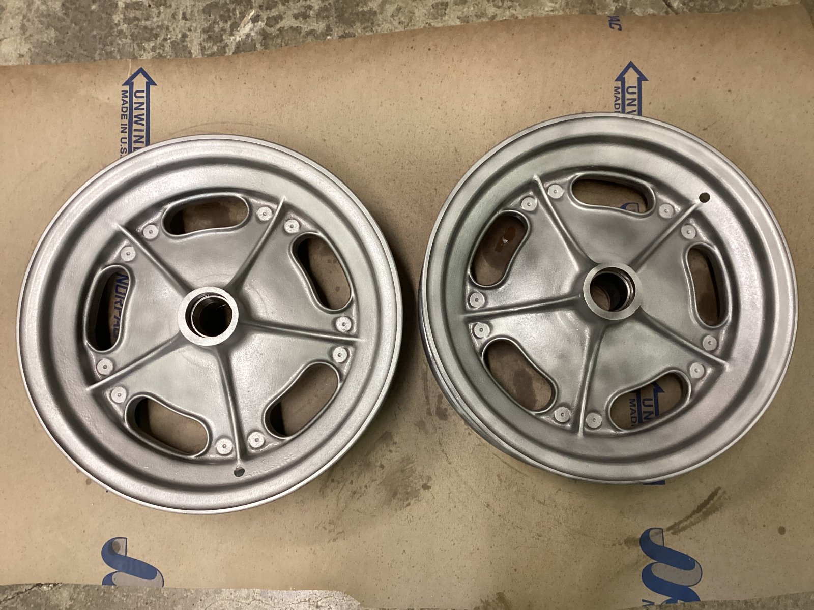

    I haven't forgotten about this project, and after the Dragster goes out for the body, I will be back mopping up the loose ends, on this one. Today however, I did finally and painstakingly, drill the valve stem holes, and pressed in the bearing races in these Australian made Georgett wheels. I would guess they were cast and machined in the 70's and never used. They were a gift from my Aussie buddy Graham Harris, and belong on this truck ! IMG_0423.jpg

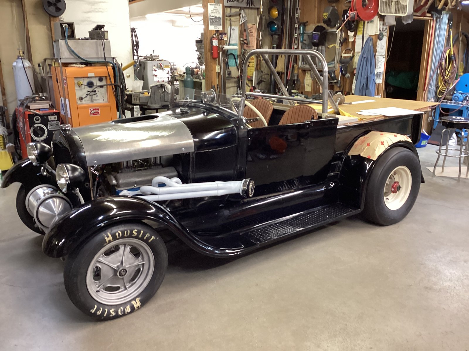

    I dislike the way the the tire MFG paints the letters white, I know it's their way of advertising, but they don't belong on a vintage race car. I am using wax and grease remover, and a Scotchbrite pad. Anyone have a better way without hurting the rubber ? IMG_0429.jpg

    When I took the paint off of my Hoosier's I used wax and grease remover and a rag, no Scotchbrite needed. Came right off... they were brand new, though.

    I think I tried that, and it was hard on the rubber.

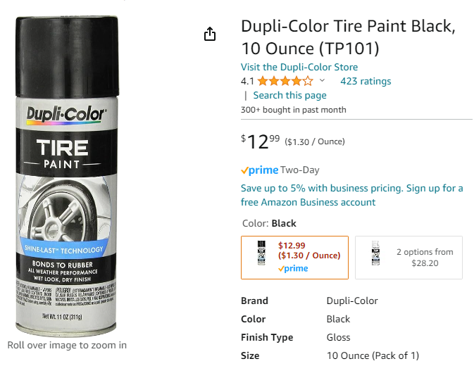

    I use this for the 75 series narrow white walls I use on my 56 Ford when mounting them black side out… it doesn’t wear off.

    I use it to black out the inside letters when I mount them blackwall out.

    Thanks boys, I will give that a try.

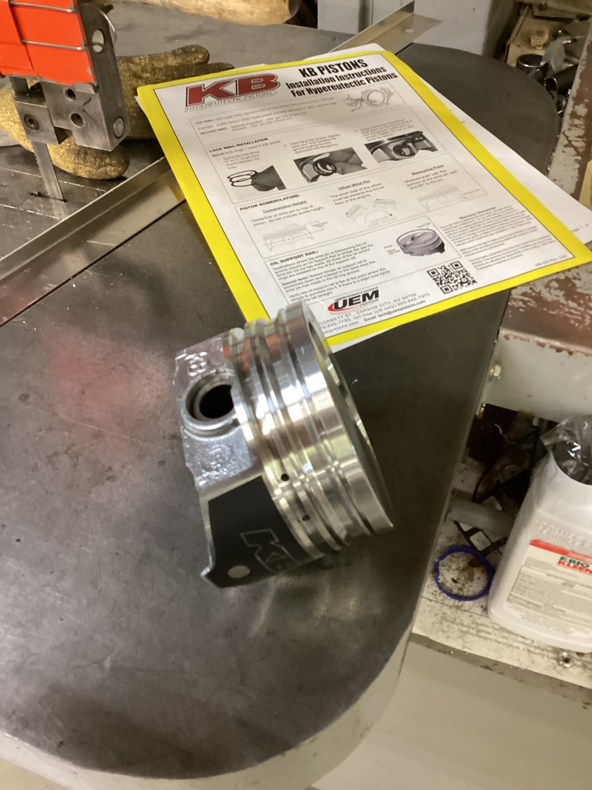

    I don't remember if I mentioned that the 355" engine I had planned for this project, is going into the Dragster. A friend gave me a 327 block with stock bore, so I decided to build a .030 over 327 for 331 cu.in. engine for this one.
    The block has been decked, line bored, and the rods are re-sized. My engine guy also bored it .025, while waiting for pistons, before honing for final fit, The KB pistons came yesterday, so he can now balance the assembly, as well. Since this is going to be street/strip, we will be selecting a hydraulic roller cam, and perhaps some aluminum heads. IMG_0587.jpg IMG_0588.jpg

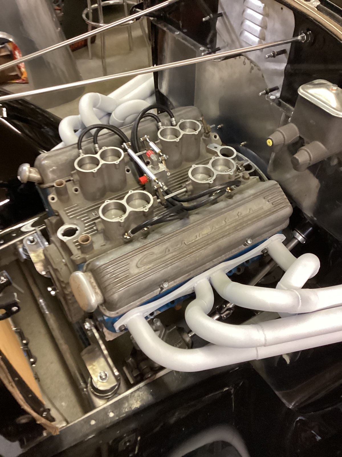

    A little update, I am back on this project, as the Top Banana Dragster is out getting the aluminum body built. The current plan is to run the 355" engine as my original intent, only it will be on gasoline, instead of alcohol. I dropped it off with Spud Miller (FIE) to have it gone through. I picked it up yesterday, and it looks great. When the Dragster is ready to run, the engine will be installed in it. I will switch it to alcohol, and by then the 331" will have the smaller 1-3/4" unit go in this car. For now, with the 2-1/16 injector on the engine, I can complete the throttle linkage, and go down the list of items, to get this one on the track. IMG_0703.jpg IMG_0705.jpg IMG_0708.jpg

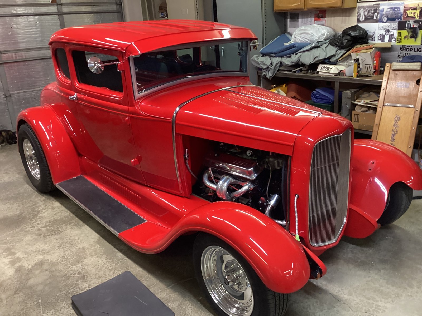

    I had a couple jobs promised this summer, and one of them was to make some hidden tiedowns for the hood top on this Model A. It's quite a combination of parts, 30-31 body, 29 fenders, and 32 grille. Back on the '29 soon ! IMG_0764.jpg

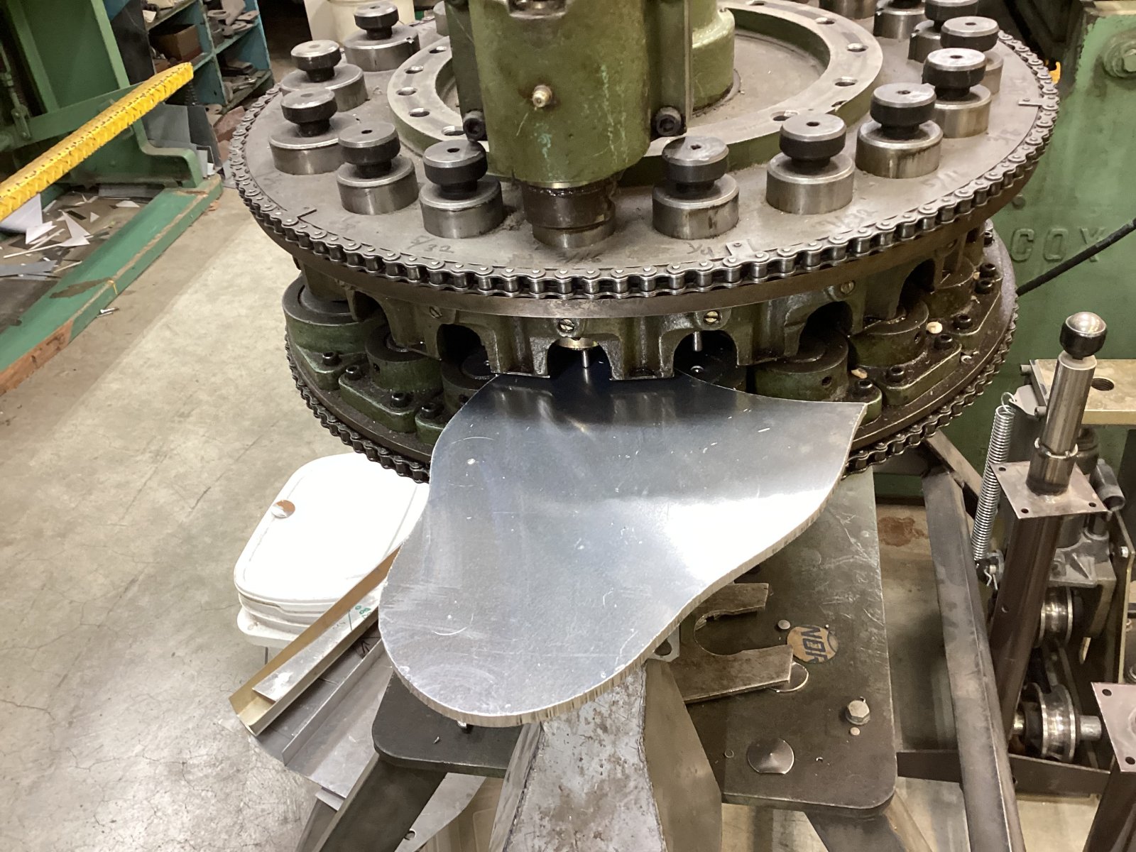

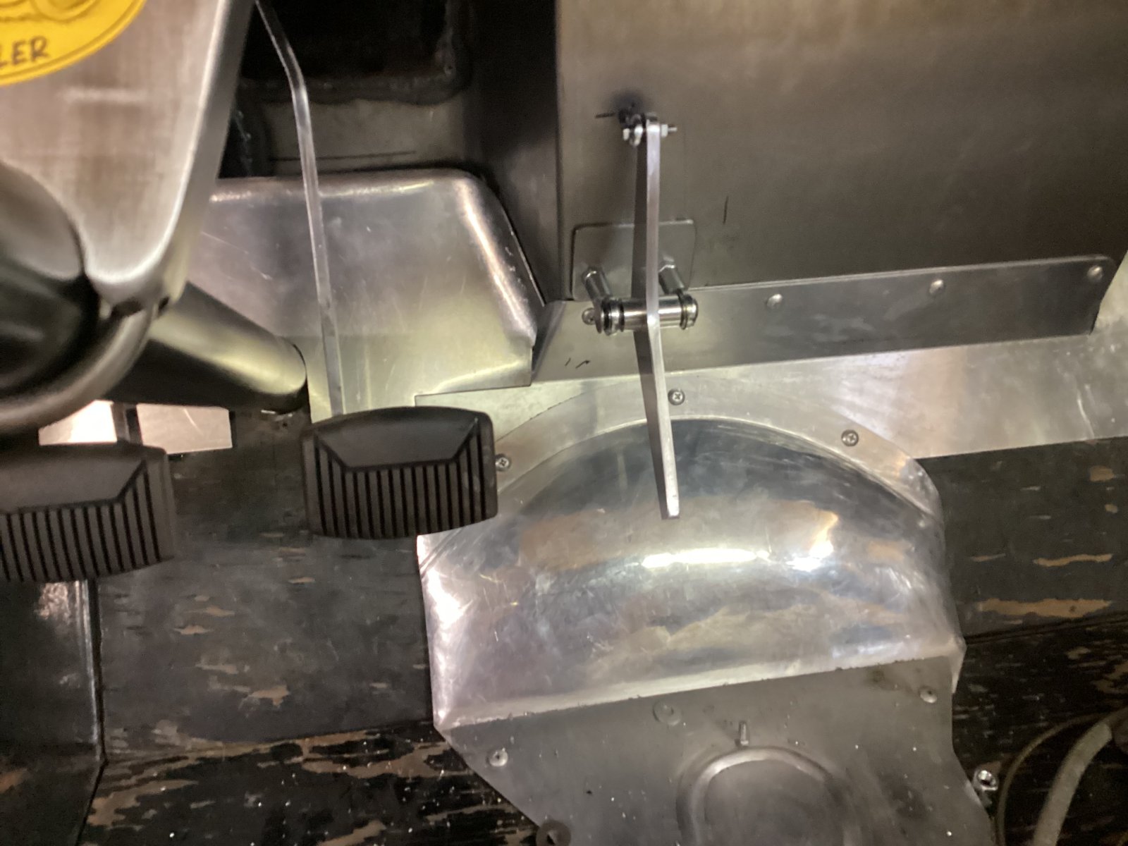

    It was time to handle the throttle pedal and linkage. So, today I pulled out some original spoon pedals, thinking I might be able to at least utilize the pedal portion. The problem was, I needed almost 2" of travel for the injector, and with the firewall and floor, I thought I had better start from scratch. 2 inches of travel at the pedal sounded good to me, so after machining up the pieces, and using some 5/16 female rod ends, I sawed out a boomerang out of steel, with 4 inches above and below the pivot point. I just happened to have a piece of 5/16 steel fuel line with a 10/32 nut tack welded on each end. It was exactly the right length, and worked well for setup. I will tap a piece of aluminum rod for the finished product. I could run the throttle with my foot, and found the ratio to be correct. So, then I duplicated the parts out of 1/4" aluminum, and am now looking for a small square, or rectangle pedal pad that can fit to the arm. Sorry bout the multiple pictures.

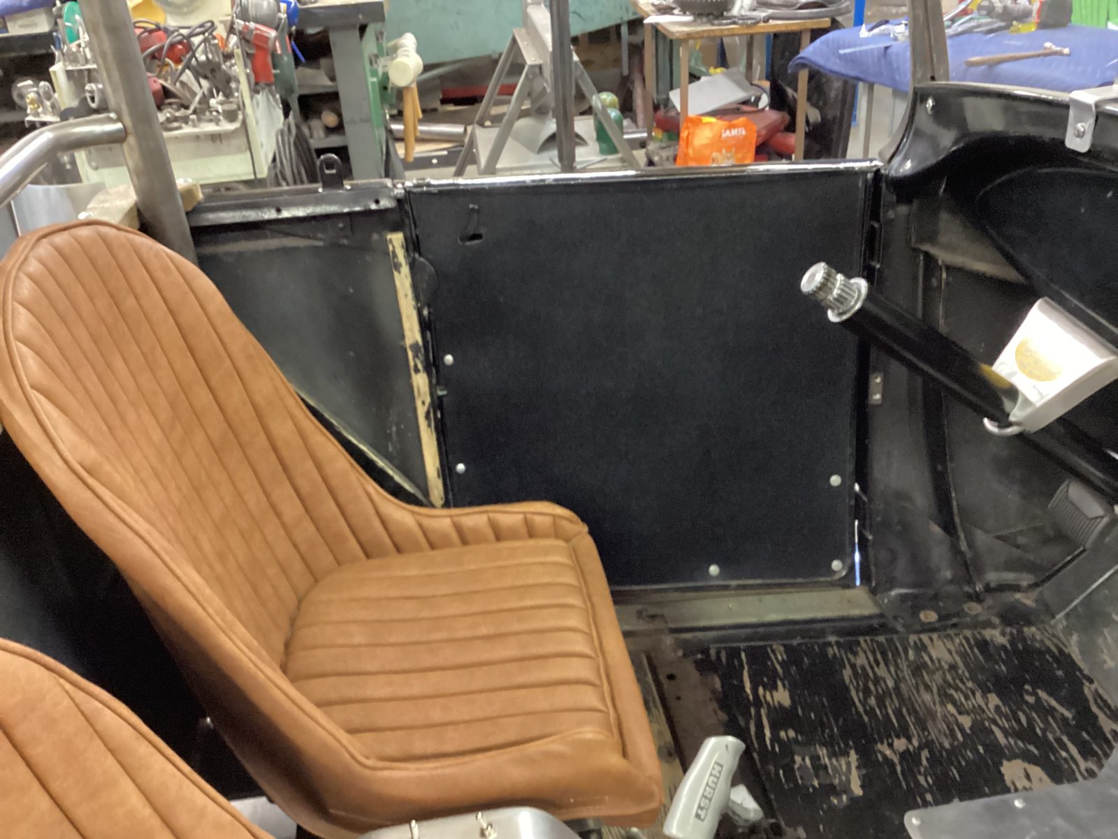

    Getting ready to send the doors and Hood to Mitch Kim for some lettering, and decided to tackle the door panels. Down the road, I want to have Sam @bskustoms do the rest of the interior to match the seats he did, but for now it will have grained ABS plastic. This is far from perfect, but it will do for the time being. IMG_0793.jpg IMG_0794.jpg IMG_0795.jpg

    Thanks, another thing I didn't show was, I drilled the hole in the pedal blade with a step drill, from both sides, leaving a narrow bit of extra metal in the middle. That way, I could lightly press the sleeve in, to the required depth, check it in the truck before welding.
