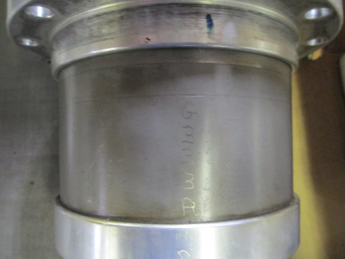

    Marty,
    The TruTrac design is from what is now Eaton. There have been several companies that have made them over the years. The one you have may be from Stock Car Products as they are the only ones I know of that hand engraved numbers on them. The ones I have had here started with a "B" prefix.
    Dan Press made a ton of them with Gold anodizing on the aluminum end caps, thus the name "Gold Track".
    He made changes as he went and it's hard to get exact replacement parts. There was also a Diamond Track made by Frank Loverock in CA. Frank was a SCP employee before going out on his own. The Diamond Tracks had little set screws to retain the end cap bolts. I didn't see them on yours. Winters still makes their own unit called.............................Wait for it.........................................................................Winters Track. Their current unit has red end caps and are laser engraved with part numbers and serial numbers.
    These units are very tough and very smooth. You shouldn't have any problems with any of them for your application. When you first mentioned 'locker' I was going to caution you on using a 'Detroit Locker' more correctly called a 'No Spin'. While they are tough, they tend to be noisy and sometimes feel 'notchy' when cornering.
    The only time I recommend them is for an almost all drag race car with hardly any street service.
    You should take it apart and check for chipped or worn gears and cracked thrust plates. I do have some serviceable pieces, but would need you to send me any broken stuff so I can match it up. This isn't likely;)
