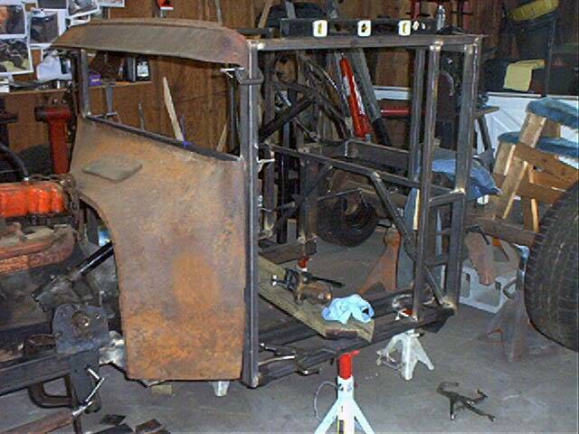

    I working on this...kind of a '25 TT. Built from an old cowl and 1x1 and 1x2 tubing.
