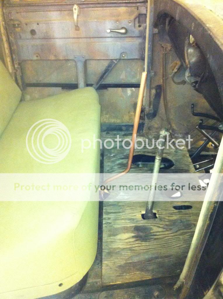

    spent the day making a mock up shifter to use as a template for one im going to get made up at work .. its nothing too technical just a couple of roughly 45 degree bends in a peice of copper pipe .. seems to fit okay though
    also modified the floor to fit the new handbrake and shifter positions .. and mocked up the steering collum .. i think it might be sticking out too far into the car but its pretty comfy having it in that position

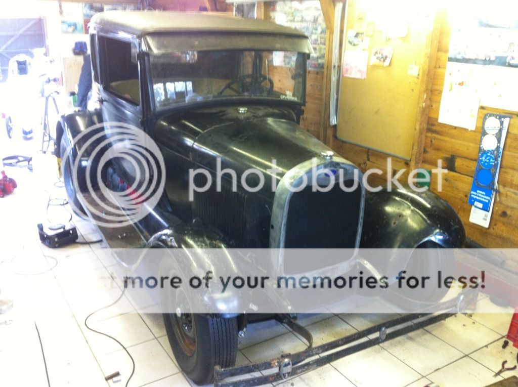

    took the car for another trip to buckland and had the steering collum put back into the stock position it came with .. because we was originally planning on having a 350 sbc in the car.. the steering box was moved back to clear the engine ..but with me being 6'5 tall .. we need to keep as much room inside the car as possible so had it moved back now we had the space with the p100 engine
    then ive spent the weekend starting to put the fenders back on the car, only managed to get one front fender on as we spent most of the day checking everything was tight on the engine !
    but then as it was getting late and we jus couldnt resist .. we decided just to mock up the front end with the grille shell, bumper an headlight bar just to see how it'll look ... i personally think it looks amazing !

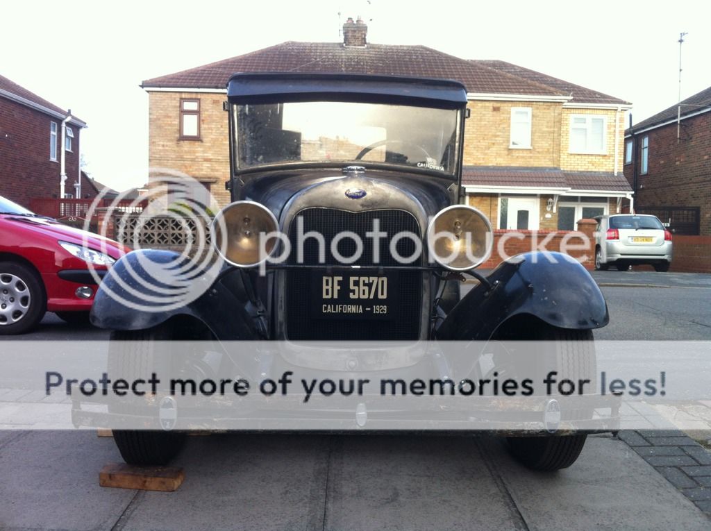

    Put all the rest of the bodywork on this weekend ! Its finally a complete looking car again ! .. Had a little bit of trouble with the fenders rubbing on the wheels on full lock .. So we decided the best solution was to narrow the headlight bar slightly to pull the fenders up away from the tire
    Considering he cut that without his glasses on and diddnt even measure the length to cut each part of the bar .. The ol'man did a pretty good job !!

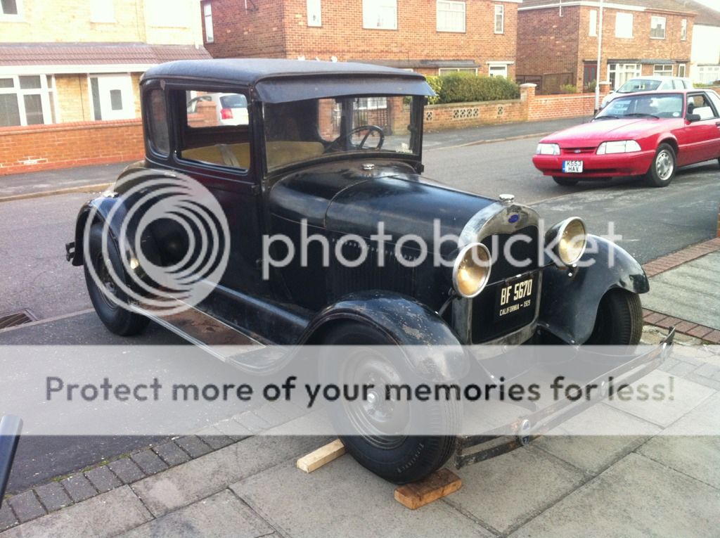

    An then we carried on to assemble ths rest of the bodywork ! For a little reward the next step was always gonna be to roll the car outside to stare at for a while !!
    I dont think the extra height we pulled up the fenders isnt really a eyesore either .. Cant tell that much
