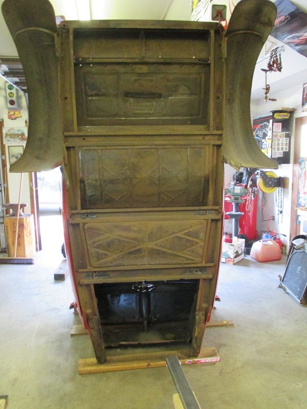

    I do some side work after regular work and this is the latest. I will be working on it a couple hours a night, 2-4 nights a week. We will see how much progress I can make on it. It is a 1929 Model A Cabriolet (oops Sport Coupe) that will have a Merc flathead in it and run full fenders. The guy wants it low and it will have steel wheels. Here are some pics of the Dagel frame and x-member with the flathead, Flat-o-matic adapter and C4 trans mocked up for engine mounts.
    Jim Ford IMG_20141223_191800519.jpg IMG_20141223_191812469.jpg IMG_20141223_191834803.jpg IMG_20141223_191849426.jpg

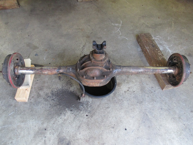

    Here are some earlier pics that I found. The body is in good shape and the paint is ok. It has been in storage for about 30 years. The plan is to fix the cracks in the sub rails at the rear body mount and under coat the floor. The driver door has some rust and a bad repair at the bottom that will be fixed and that is about it for the body. The paint stays as is with some repair so that it looks like a survivor but with all new frame.
    As mentioned earlier the frame is from Dagel's. It is made from about 1/4" thick material and the x-member is made from 11gauge or 1/8" material. everything looks to be made in a press brake. and then the bottom transitions were welded and ground. The body holes have nuts welded into them from underneath and it all looks like quality work.
    We are not boxing the frame because of the thickness and the x-member and the fact we are only using a flathead and automatic for power. The rear end is an 8" Ford out of another hot rod but I think it came from a Mustang originally.

    WOW! Nice body, not that it really matters but that is a Sport Coupe, with a fixed top, the Cabriolet had an all wood framed body and folding top. Who made the front crossmember, I could use on of them. Bob

    Oops and I knew it was a Sport Coupe Just tired and not thinking clear. The cross member came from Dagel's also but I think he gets them from Pete and Jakes, Chassis Engineering also has them as does SoCal Speed Shop. Not sure who makes them but they have the low cut radiator mounts on them so the will fit 28-29 and 30-31 Just add a 1/4" spacer. It also has the 7 degree caster built into it so there is no spring bind.

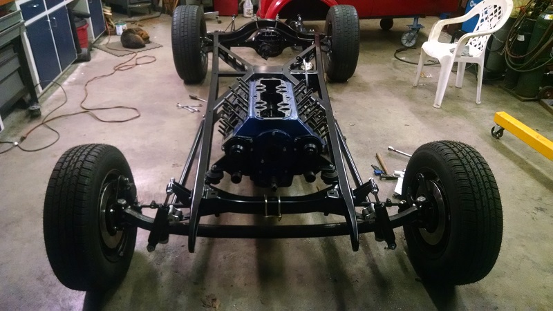

    The frame is welded together and the front motor mounts are done. I want to get the rake and ride height figured out before I finalize the trans mount. The front axle is a stock 35 that we are going to use 37 spindles and split wishbone on. We have a reversed eye spring that will get it lower. IMG_20150115_192047546.jpg IMG_20150115_192102953.jpg IMG_20150115_192145545.jpg
    kiwijeff and kidcampbell71 like this.

    I finally got the pictures downloaded and resized. Here are some of them.
    IMG_20150216_194218214.jpg IMG_20150216_194242625.jpg IMG_20150216_194323493.jpg

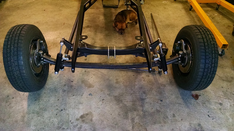

    We did spring in front of the axle and used a 37 front wishbone strengthened with a piece of 1/4" flat bar stood vertically down the length of the bones and a Model A capture for the ball. We made our own 35-36 style attaching points to the axle. Lower shock mounts are welded to the bones and the flange of the rear cross member was heated and flattened to create room for the shocks.

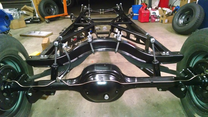

    The rear cross member is a stock Model A part, the spring is from a Model T and the spring perches are aftermarket and set at 48" wide like a 37-40 rear end would be. Here are some pics of the frame after powder coat. IMG_20150323_190044904_HDR.jpg IMG_20150323_190058982_HDR.jpg IMG_20150921_181723353.jpg IMG_20150921_181737846.jpg IMG_20150921_181745122_HDR.jpg IMG_20150921_181757831_HDR.jpg IMG_20150921_181808048.jpg

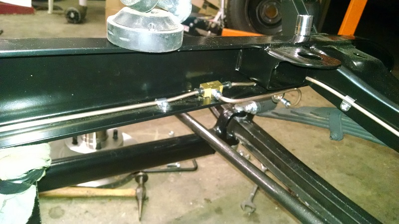

    Ran the brake lines this week. I used the copper/nickel tubing for the first time to do it and didn't use a bender only my thumbs. This stuff is so easy to work with that I will probably use it from now on. Here is a good write up on it.
    http://www.copper.org/applications/automotive/brake-tube/brake.html
    Some pics of the lines. IMG_20150930_195752531.jpg IMG_20150930_195717271.jpg IMG_20150930_195734284.jpg IMG_20150930_195726716.jpg IMG_20150930_195832936.jpg

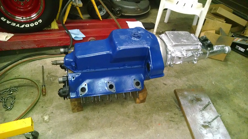

    We also installed the Flat-o-matic adapter and C4 trans tonight and then turned the engine upside down to install the pan after we make a cut out in the bottom of the bell housing area for access to the torque converter bolts. IMG_20150930_195906420.jpg

    Here is a shot if the tie rod area. We used my 7 degree taper reamer to bore the steering arms from the top and we flipped and pie cut the 35 split bones to give the axle a 7 degree caster angle and clear the tie rod. (I hate dropped bolt on steering arms because the flex too much IMO)
    IMG_20151001_191225534.jpg IMG_20151001_191242118.jpg IMG_20151001_191328352.jpg IMG_20151001_191302539_HDR.jpg IMG_20151001_191157855.jpg

    I know this is a old thread.....But I noticed the rear spring u bolts are installed wrong
  20. 55willys
    Joined: Dec 7, 2012
    Posts: 1,604
    55willys
    Had no choice because otherwise the bolts and nuts would have hit the rear end housing

    really nice but need more photos :) those rear shock mounts will be up though the floor?
  23. 55willys
    Joined: Dec 7, 2012
    Posts: 1,604
    55willys
    It's a rumble seat car so the seat pan gives clearance for the shocks. I had to extend the front of the seat pan because I moved the rear cross member forward on the spring ahead design.
