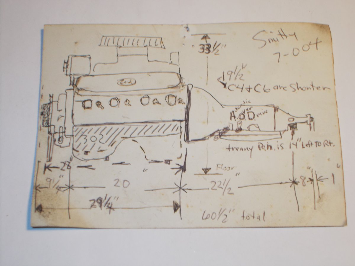

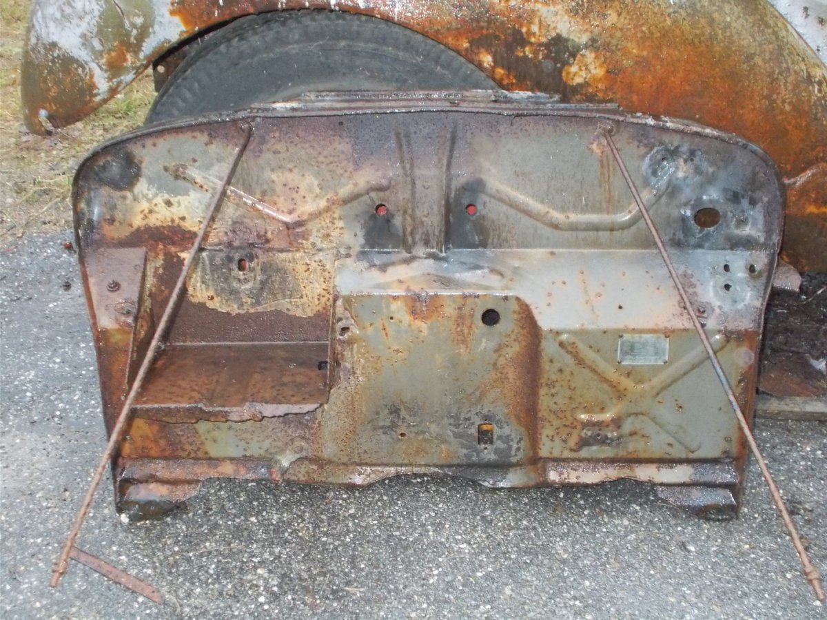

    I shortened my '33 firewall about 4" or 5", lot of work to make look good...
    I would recommend a '35-'36 or '37-'39 truck firewall... about 4" more engine room than the stock '33-'34... sold 5 of them...
    the later group have built in battery boxes, which I like, some don't... i have a '39.
    The trucks have about the same size outside edges as a '33-'34... about the same look... will need to be tunneled along each side of the cowl skin and lower cowl mounts...
    measurements ;

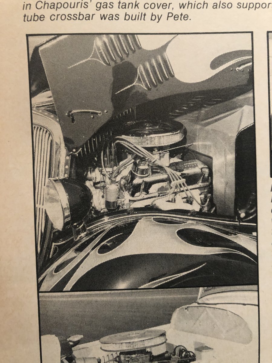

    Take a look at the most famous 34 3W. It has a Blair’s Built 302 10C1ACC7-4226-45F2-871F-A6B9D1B233BC.jpeg E0F41362-519E-4FE3-8F48-F3EDE2FF430C.jpeg 351411AC-CF1D-4D6F-8532-D719050B6BDE.jpeg F311E315-9282-4BD5-A4FD-D38A43AE7D92.jpeg

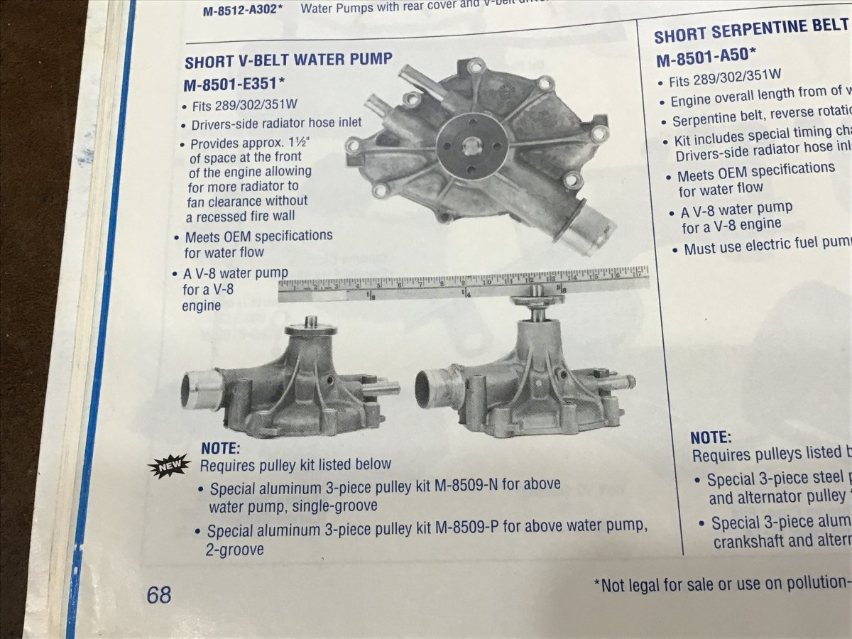

    What short water pump do you have?
    Here's a genuine Ford of China one:
    https://www.fordracingparts.com/part/M-8501-E351S
    As for the Opel pump that comes with the Snow White kit, is the flange large enough to redrill for a Ford style fan?
    Seems like it would have been nice if they replaced the flange with one that fit the Ford, but I guess that would have made the selling point too high.

    So it looks like the two choices for a short water pump using V-belt(s) and a mechanical fuel pump are the Snow White and the Ford Racing pumps.
    The Snow White saves 2". The belt will probably rub on the rad hose but in an acceptable fashion.
    The Ford unit saves 1-1/2", perhaps the Ford engineers chose this length to avoid the rub.
    The Snow White unit uses an oddball, but cheap Opel pump and adaptor which look a bit un-traditional.
    The Ford setup uses a more expensive Ford pump that looks better (to me).
    The Ford setup is available from CVH racing, they carry the pump and either single or two groove pulleys and sets.
