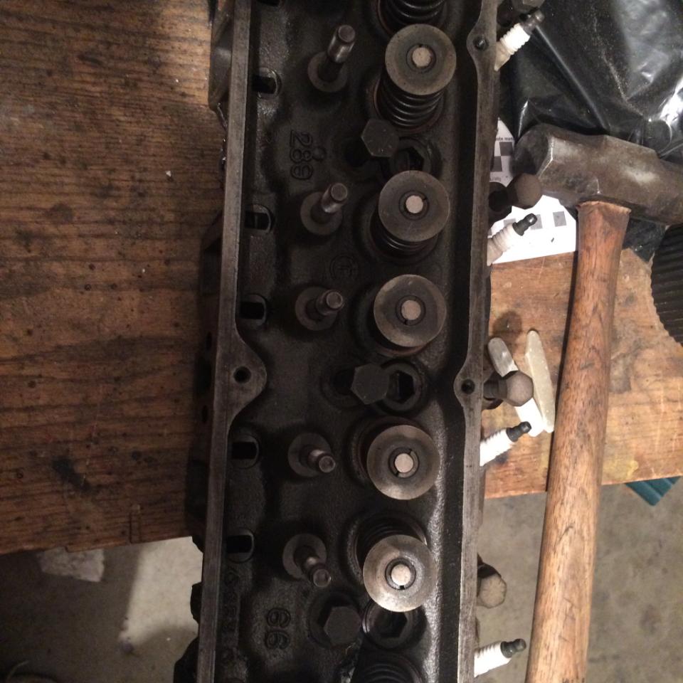

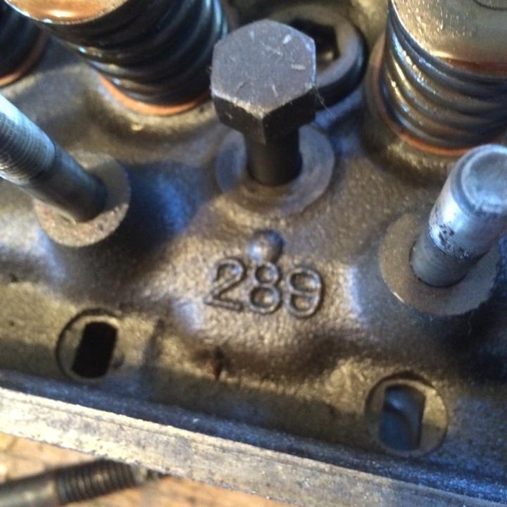

    Just got some pics of the 289 heads. While I cannot see it in the pics he says the numbers stamped are C80E. Ok, it seems the more I read and rely on the internet here the more I get confused. Here are some pics of the heads in question. Can you help me identify them maybe? He says the stamping is C80E which to me says '68 but then there is that big bold 66 right there on the head staring at me. I'm lost LOL

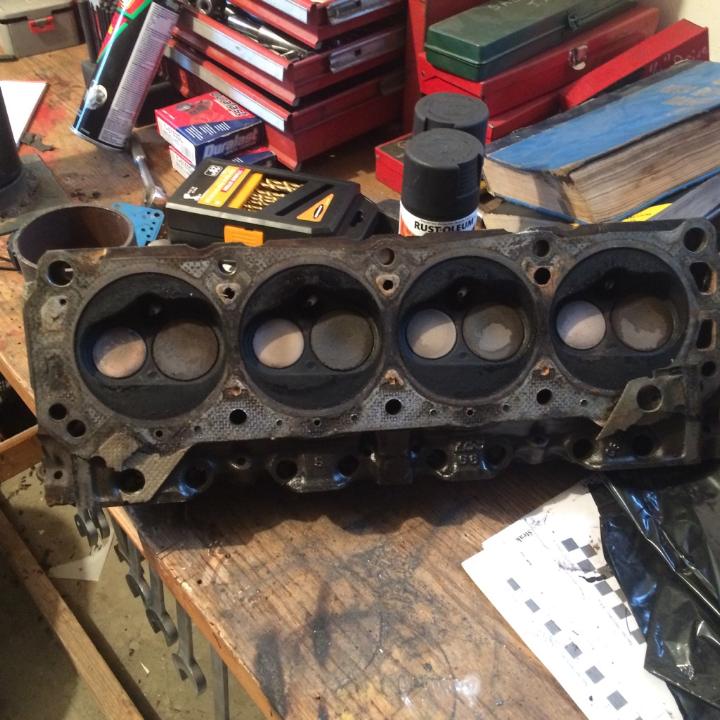

    Ok having looked at these pics on my computer now instead of my old POS flip phone I am thinking they are indeed '66 289 heads C6OE not C8OE casting. This also leads me to believe they have 54cc chambers, and 1.78/1.45 valves. My current heads are the same for valves but Ford claims 64cc on the combustion chambers (E7TE).
  13. Just a standard '66 289 head (C6OE), nothin' special.... If your current heads have pedestal or rail rocker arms, you'll have to switch to hardened pushrods and non-rail rockers.

    Check the chamber volume. The 66 might be a casting number for the upper half of the mold that they didn't change if they changed the lower half and chamber volume.
  15. That should bump your compression about 1 point. Be careful about valve spring pressure, those press-in studs can pull out. Generally, these are replaced with screw-in studs for reliability.
