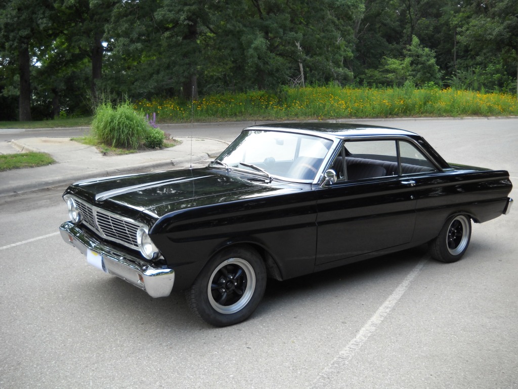

    Forgot I had never posted a conclusion to this saga. The noise did ultimately turn out to be the result of that 1 loose bolt in the flex plate. As for the converter, I fought it for another hour or so after my last post with no luck. I pulled the trans and took it to a friend who has done transmissions for 40 years or more. He pulled it apart, couldn't see anything wrong with it, and put it back together. To this day we don't know what was out of place. But after he had it apart and back together, the converter slid right in.
    Here is a pic of the car when it was finished. I did the paint and bodywork in my garage.

    nice little falcon. worth all the problems, right??

  25. I have always wanted a second gen Falcon. Haven't found one I can afford or to damn rusty & beyond my pay grade.
    Your's is really nice!
    It's always the small things that are the biggest PITA!

    Thanks for posting the resolution to the story! Some of these mystery threads just fade away without update. Nice Falcon too, 64-65 are beautiful cars, that's a great home paint job!

    I was really lucky on this one. The guy who started the project had bought it as a rolling shell from the southwestern US. No rust ever.

    I'm sorry to say that by the time I got all the bugs worked out I was so bitter that I ended up selling the car to focus on another project(summer 2014). Now I wish I had it back(of course).

    Somebody sure got a nice car. Good Job!
