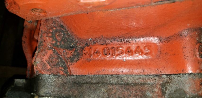

  1. I'm looking for answers or where to find the answers. I have an engine on a stand for many years. I was told, way back then, it's a 283. It has 461 X camel hump heads. The domed pistons are stamped .060. If it's a 283 is in now a 292? Are these good heads for this bore? I've attached photos of the block numbers, pistons and heads.

    measure the bore, with a ruler, to the nearest 1/32 inch, and you'll know what you have. 327 started as 4" bore, 283 as 3-7/8"
    Are there numbers stamped on the block deck at the front?
    The casting number looks 1970s or later, which means it's neither 283 nor 327. And the best part, is that it's a big block casting number, unrelated to the engine you seem to be talking about.

  3. Isn't that casting number for a 454 from the 80's?

    yeah, and looking at both of his pics that show the rear of the block, it's obvious they are two different blocks. One is nice orange, the other is dirty old iron.

  6. ^^^^^ The deck is not Big Block. Look at dowel pin in photo provided.
  7. 1978-1990 454??
  8. Oh, crap. I do have a 454 and I sent the wrong photo. Yes, dirty old iron!!!! The bore measures 3 15/16---ish. It is less than 4".
    Thnx

  10. oldsfrench,
    THANKS, it's a 1957-1966 283. Mystery solved! I will keep that info site for future use.

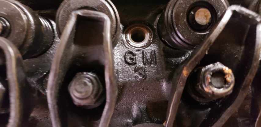

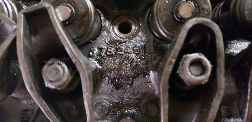

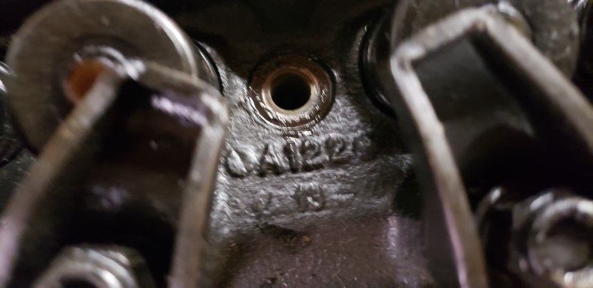

  18. Can you make sense of the numbers in the photos? I cannot get a straight on photo of the crank flange due to the engine stand. The casting numbers look like:
    8782461 GM3 A122 8782461 GM A52
    11 13 16 2 13
    Deuces likes this.
  19. Well the numbers didn't quite line up the way I wanted them to. See photo.

    the casting dates on the heads are Jan 5 and Jan 12 1962 (A 5 2 and A 12 2)
    what's the date code on the block? should be something similar to those letter/numbers on the back, not far from the casting number
    no stamped number on the front of the block deck surface?
    the crank looks 283 to me
