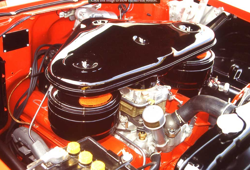

    The Rochester 4g and Carter WCFB carbs used by Chevy were under 400 CFM. [each]
    To get the awesome correct look on your 57 you need a "Batwing" air cleaner [not cheap]

    Chevrolet made it work in 1957 by using two Carter WCFB carbs that were appoximately 350 CFM each.
    I love the performance of dual quads which are correctly sized, but even two 500's on a mild 283 would be difficult.

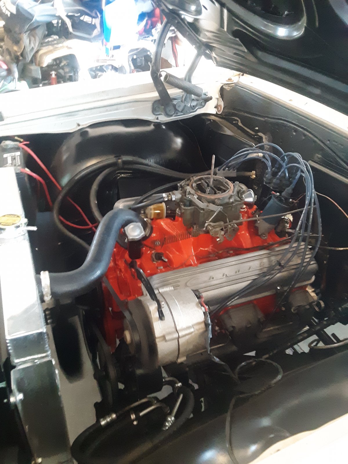

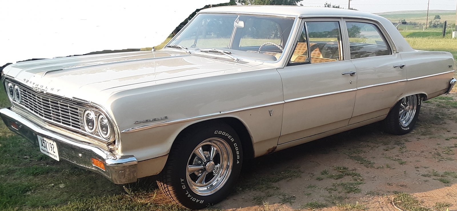

    My son did a nice 283 "fun" engine in his 64 Chevelle 4 dr. It was an original 283 3 speed car-39,000 actual miles. He did a build similar to what Hdonlybob has. I had a fairly low miles rebuilt 283 bored .030 in the shop which had bad power pak heads. We found a set of 305 heads, bought the L79 cam and new lifters, double roller timing set, recurved old points distributor, and a nice Rochester 4 jet carb on a 63 intake manifold. We got a 2 1/2 inch dual exhaust kit off ebay and used the stock manifolds. He replaced the 3 speed with a Saginaw 4 speed (wide ratio) and it is a peppy, reliable, fun to drive family cruiser. He constantly has people complimenting him on the looks and the "boogeda-boogeda" sound coming out the tailpipes. Now we need to smoothe out the "whiskey" dents and repaint.
    Tickety Boo, Tman, alanp561 and 2 others like this.

    I'm running dual WCFB's for a 56 Dodge D500 on my 283, and it runs fucking great! Smooth from idle to max rpm, no bog anywhere. I would stick to the original plan, maybe swap the 600's for 500's. Flyin Bryan here on the HAMB did exactly that on the 283 he put into his 34 Roadster, and it ran great as well. Keep in mind that the Edlebrock carb design uses an air valve to keep the secondaries closed until there is sufficient air flow, keeping air velocity up and preventing a bog.
