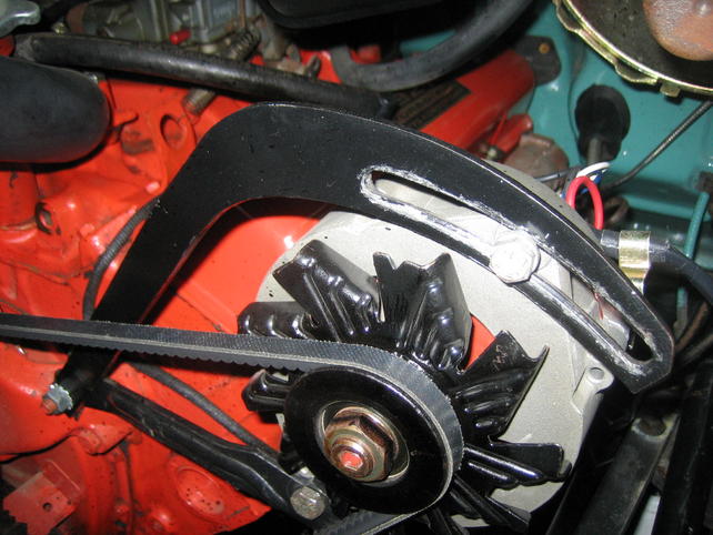

    Here is a Alt bracket LH exhaust manifold
    The alt bolts to a stud on the end of the manifold, with a support bracket to the w/pump

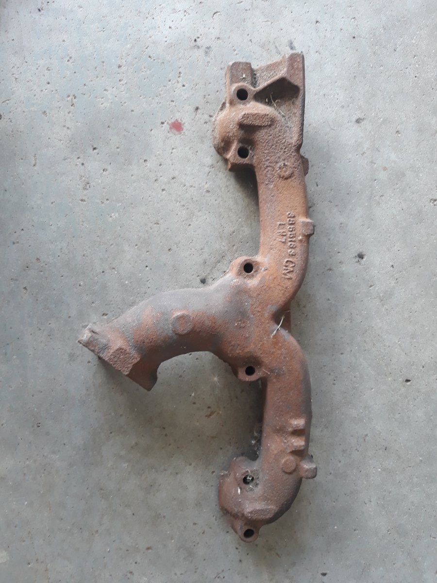

    Here is a Gen bracket LH exhaust manifold
    If you have one of these, the little generator bracket on the side of your 235 bolts directly onto it.
