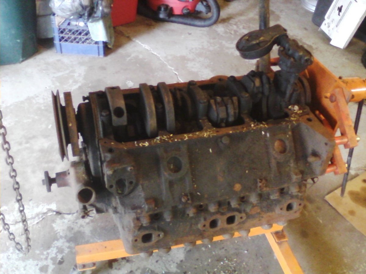

    Chevy 265.jpg No side mounts
    LOU WELLS and volvobrynk like this.

    mgtstumpy, It looks like an unusual oil pump and pickup - a swinging pickup?
  20. Ah yes, the Swinging Pickups. Didn't they have a hit record in 1957?

    Just for clarity; this is a 55, 265 engine. No block mounted oil filter or starter motor pad (that began in 57 with both the 265 and 283 blocks), and of course, no side mounts. "Swingin' Pickups"? Is that oil pickups, trucks, or girls?

    Just for clarity; this is a 55, 265 engine. No block mounted oil filter or starter motor pad (that began in 57 with both the 265 and 283 blocks), and of course, no side mounts. "Swingin' Pickups"? Is that oil pickups, trucks, or girls? Cannister oil filter arrived in 56.
