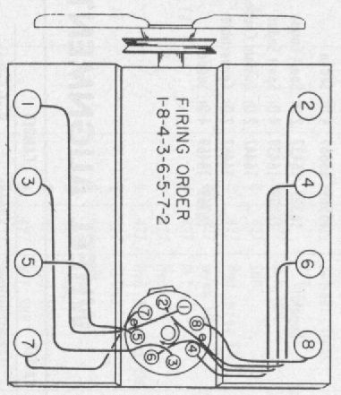

    The firing order in a chevy is 1-8-4-3-6-5-7-2, if your staring at the distributor from the front of the motor, the number one plug wire should be to the right of the middle/front plug, and the the distributor turns clockwise to the front which is the number 8, and then so on. So as everyone has mentioned double check the order, and dont forget that if it as that way it doesnt mean it was right, because most motors are usually pulled out because they had a problem so just because it was that way its still worth a double check. if the wires are crossed though the motor will usually shake also so if its not dancing around you might wanna check your timing, I think its usually 8 degrees out from tdc but I could be wrong but some people set them to 0 degrees. best of luck and keep us posted

  18. are 3 and 6 crossed? if 1 in the photo is on the left and there is one behind it i can not see that heads toward the passenger side [even] then 4 [passenger side] then 3 should head toward driver side and 6 back to passenger side, then 5 [driver] 7 driver 2 passenger side.
    or am i looking at it wrong?

    My eyes tell me that #1 should be in the # 7 spot and the window should face towards the passenger side. In this pic, i tried to duplicate your photo angle & The yellow tape wire is #1
