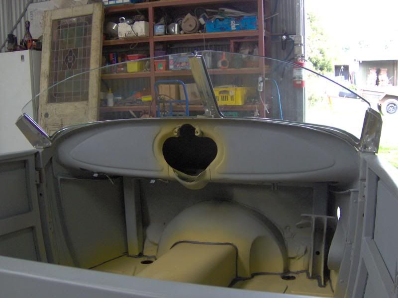

    In the meantime, I sat my windscreen on the body to show my mate, Martin, the other day.
    It's a home built Hallock style screen. It's all steel (1/8") and has been jet hot coated. I didn't finish it quite as well as I should have prior to coating. I thought that coating was kind of thick and might hide sanding marks and the odd pit. No, they show up real good. I decided to leave it that way in keeping with the overall theme of the car. A little bit rough.
    I wish i took pics as I built this screen because it was kind of interesting if I say so myself.
    It was based on a Weesner illustration, but it came out fairly close in general shape and proportions to Steve Sellers screens. Maybe he copied Keith's drawing too. His finish is a lot better.
    The glass is just sitting in the channel. It will get glued in with black silicone
    More progress soon
    Pete
    brEad likes this.

    Looks great!! I've been away from the HAMb for several months,But I'm back. I have followed your build with great interest-one of the best builds I've seen in almost 5 years on the HAMB.
    Ted
  13. Striper,
    That windshield is perfect. Great shape! The whole car is going to rock!

    That screen just SCREAMS "Dick Dastardly".....uberkool!!!!!
  15. Great update ............I just love that screen

    I just got a PM from 29paul asking me about my windscreen. I figured that if I'm going to describe the process I might as well put it up here for everyone to read. As I mentioned, I didn't take photos, but I'll try to describe the process.
    Fitting the bottom of the screen to the cowl is the hardest part because you are trying to fit a flat section to a compound curve. I'm no mathematician but I quickly realised that it is like taking an angled slice through the cowl.
    That all being said, this is where you need to start. Once you have that bit worked out, whatever you choose to do above is up to you.<O:p
    <O:p</O:p
    So, at this point you work out the angle of the screens, left and right i.e. how far forward you want the centre pillar.
    <O:p</O:p
    Next you decide on the lay back angle. You need to do this at the start because it will affect the angle that the screen dissects the cowl and therefore the exact location of that line (remembering it&#8217;s a compound curve).
    <O:p</O:p
    I decided the easiest way to start this process was to use a piece of 10 mm round bar (3/8&#8221;) and bend it to the shape of the cowl where the screen would meet the cowl. You need to be careful to keep the rod flat in one plane. That piece of rod actually became the base of the screen later on.
    <O:p</O:p
    So I had cut a thin plywood centre pillar to get that angle right and bent some rod to sit nicely on the curve of the cowl. Next I traced off the rod onto another piece of plywood and cut that curve. That piece of plywood should go close to fitting the cowl at the desired angle. Leave extra on the other 3 sides for trimming. First you trim where it meets the centre pillar. Then you can trim the side which will become your outer pillar and last you trim the top to the height and shape you want your windscreen.
    I should make note that you do all this on one side first as it gives you a head start on the other side. Of course it isn&#8217;t as easy as just flipping your template. Do you think that a 28 / 29 cowl is symmetrical?
    You mess around a bit until you are happy with the fit to the cowl and the overall shape. Decide how wide you want the finished frame to be and transfer the outline to 1/8&#8221; plate. Cut it out.
    It&#8217;s not a bad time to make your centre pillar and work out how you want to fix it to the cowl. Hard if you are planning on using the tank. Once you have the centre pillar securely in place, you have somewhere to work from.
    I had already cut off the top of my original windscreen pillars and welded on plates with captive nuts underneath. I made plates to match which become the mounting plate for the screen. With these bolted in place and the centre pillar bolted in place I tacked the piece of 10 mm rod to the centre pillar and the outer mounting plate. Cut out the first section of 1/8&#8221; plate and it should meet the centre pillar and follow the rod across the top of the cowl. I tacked it to the pillar and the rod.
    Do the same on the other side.
    You now have what looks a bit like a Hallaock windscreen. The 10 mm rod provides for a 10 mm gap for the glass to fit in. I&#8217;m using 6 mm (1/4&#8221;) toughened with a 2 mm bead of silicone each side.
    You then need to make the inside pieces to create the channel. The outside templates won&#8217;t work but it&#8217;s a starting point. You are further back on the cowl and the shape is quite a bit different. So you basically follow the same process to do the inside as the outside and weld it all together. You need to make sides for your left and right pillars and maybe the odd fill piece here and there, like the tops of the pillars.
    Then you have to grind and sand a lot. I used a belt linisher to do most of the finishing because you want nice flat surfaces and square edges.
    Once it was all together I cut templates for the glass out of corrugated cardboard.
    Again, they are different, left and right.
    You have to have patience and be prepared to change things as you go.
    I threw away the first section of plate I cut out. I made several templates for the glass before I had the shape I wanted. I think I made the centre pillar twice.
    I know this would make a lot more sense with photos but it can&#8217;t be helped. I&#8217;ve done my best to remember the steps I went through. Hope it helps.
    Pete
