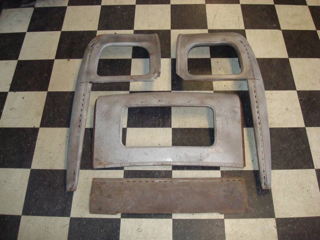

  6. sloppy jalopies
    Joined: Jun 29, 2015
    Posts: 2,033
    sloppy jalopies
    sent a pick to a buddy that wants a '29 closed car...
    closed car cowl with steering wheel on a chassis is an early '30...
    oval speedometer
  7. fiftyv8
    Joined: Mar 11, 2007
    Posts: 4,182
    fiftyv8
    from CO & WA
    Honestly, you would think somebody would stamp some of these roof pieces out.
    They are not that large and I am sure would be well received by hot rodders and restorers alike.
    Great project, keep up the good work.
    brEad and greaser like this.
  8. Awesome work , watching this one for sure!
  9. 51box
    Joined: Aug 31, 2005
    Posts: 645
    51box
    from MA
    Absolutely , I've seen some really solid sport and special coupes lacking the roof for reasonable money. I would gladly have bought a new roof if one was available.
  10. sloppy jalopies
    Posts: 2,033
    sloppy jalopies
    I would refer to those [3] panels as "lifesavers"...
    Wyocattech and 30 AV8 like this.
