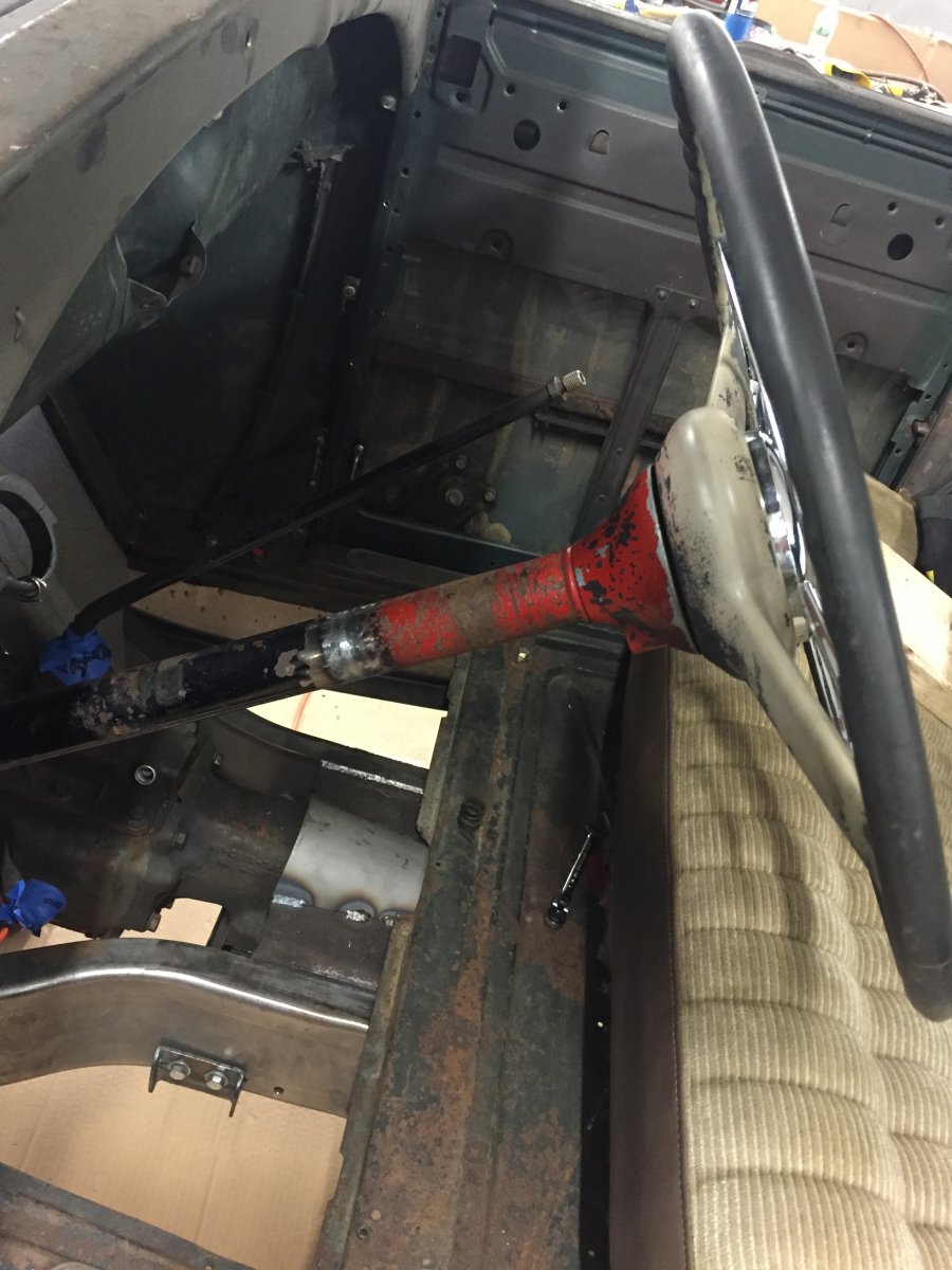

    Have you tried a gas pedal for room yet, now that you have a seat frame?

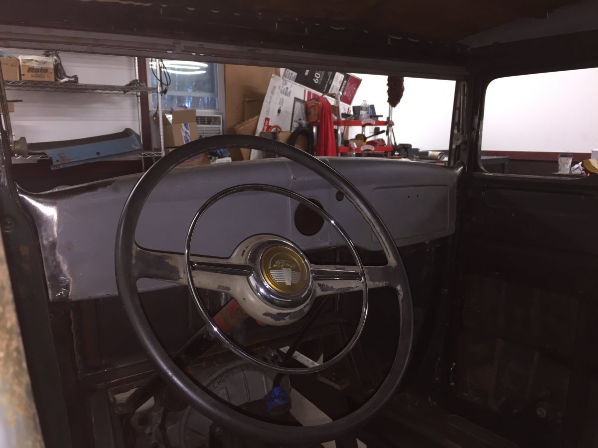

    Thanks man, I haven't tried a throttle yet. Once I get the steering box mounted the clutch/brake pedals need to go in. Then I figure after that I'll see what room I have for a throttle pedal.

    by the way...funny how a recent find works so good...that steering wheel really fits that build to a T

    Wheel is a 47 and column is 55 so I have to cut the top off and weld a taper/key style on.

    What did you do to that horn ring to clean it up like that, very nice. I like your whole build. I'm working on a 29 roadster at the present, although I'm at a standstill until the painter gets off his ass.. Like you, I can't wait until I can get it on the road. Good luck with the project.

    Thanks for the good words. The horn ring I disassembled it and used steel wool with coarse compound till all the rust was gone. Then I hit with lacquer thinner, then NeverDull and hand polish. On the gold center piece I cleaned with soapy water then hand polished with NeverDull

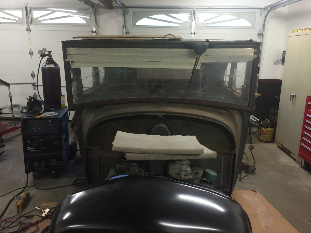

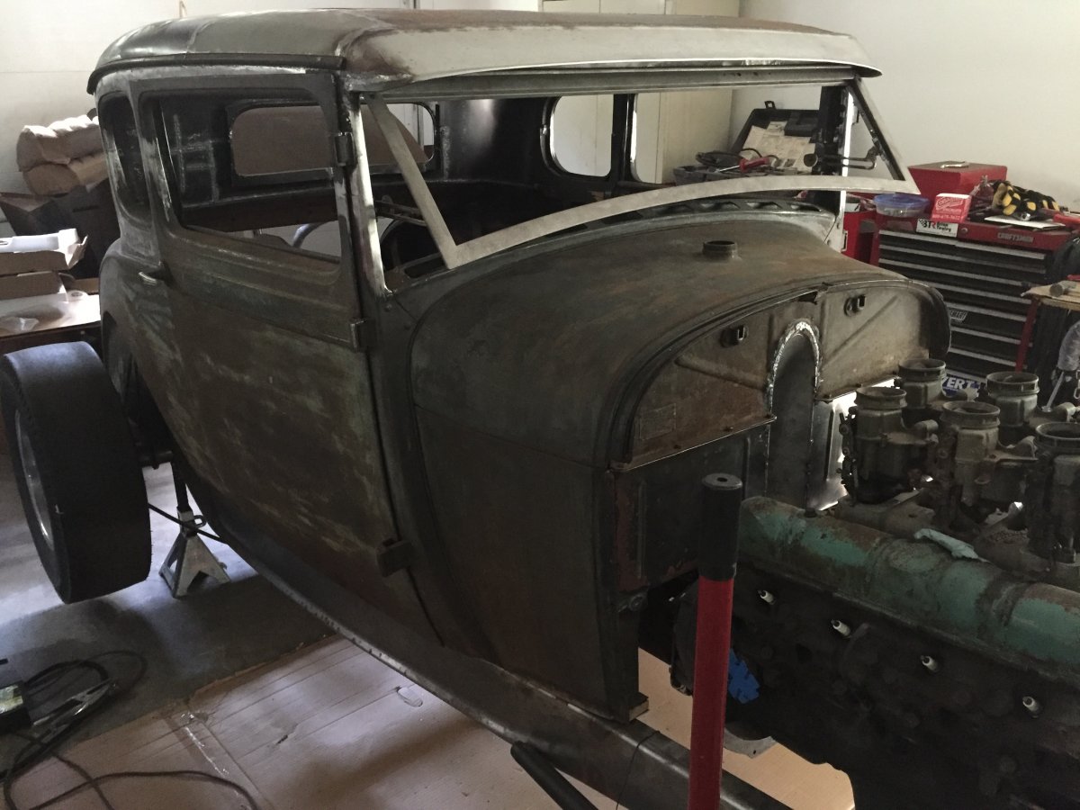

    Got the windshield fitted, basically just recut the angles and drilled new holes etc. image.jpeg image.jpeg image.jpeg Had to tweak the new header around to get the bind out. Hinges out nice now.

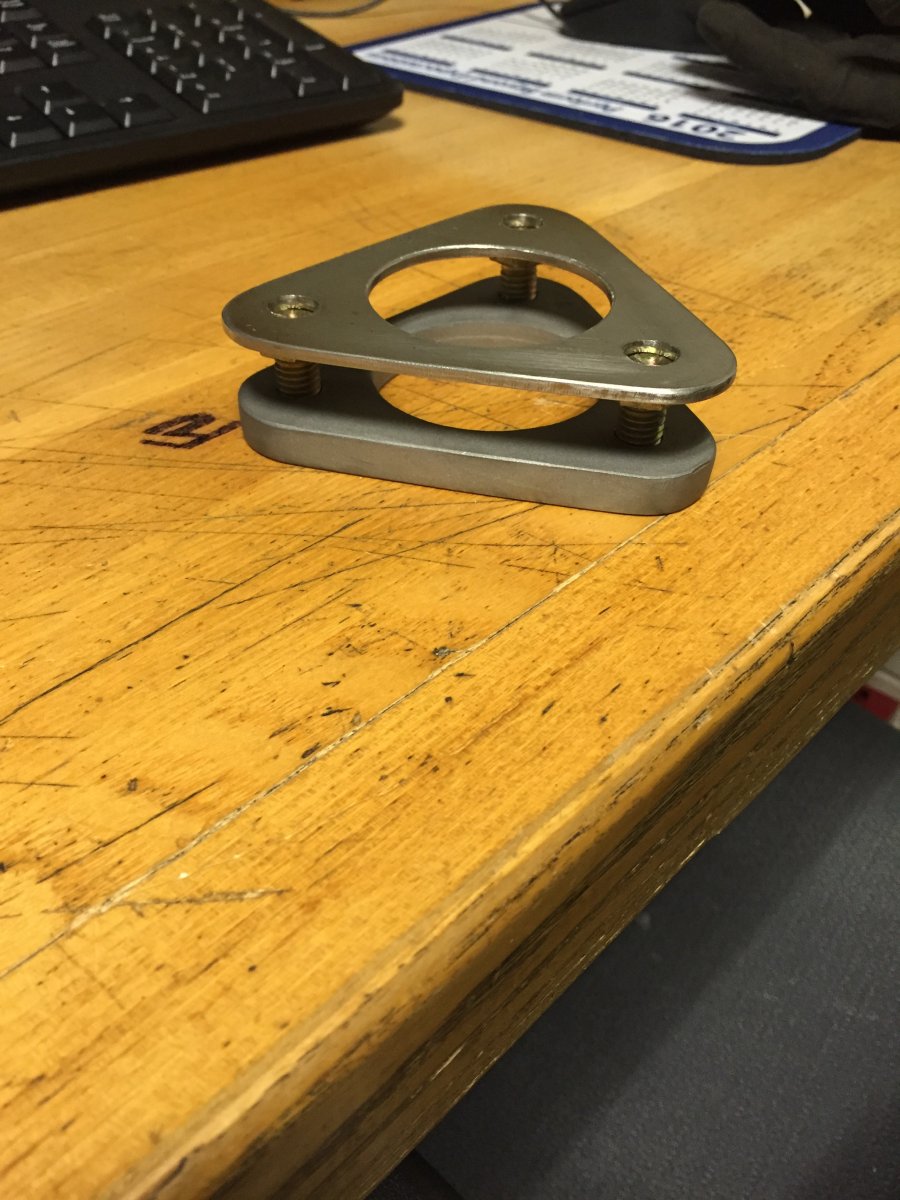

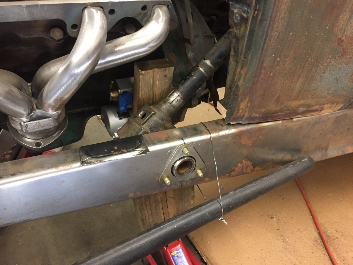

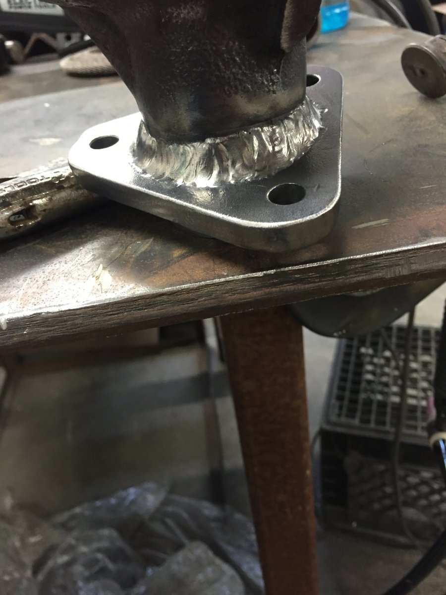

    Made up this 32 looking flange for the F100 box. image.jpeg Committed now, hope this all plays together in the end . image.jpeg

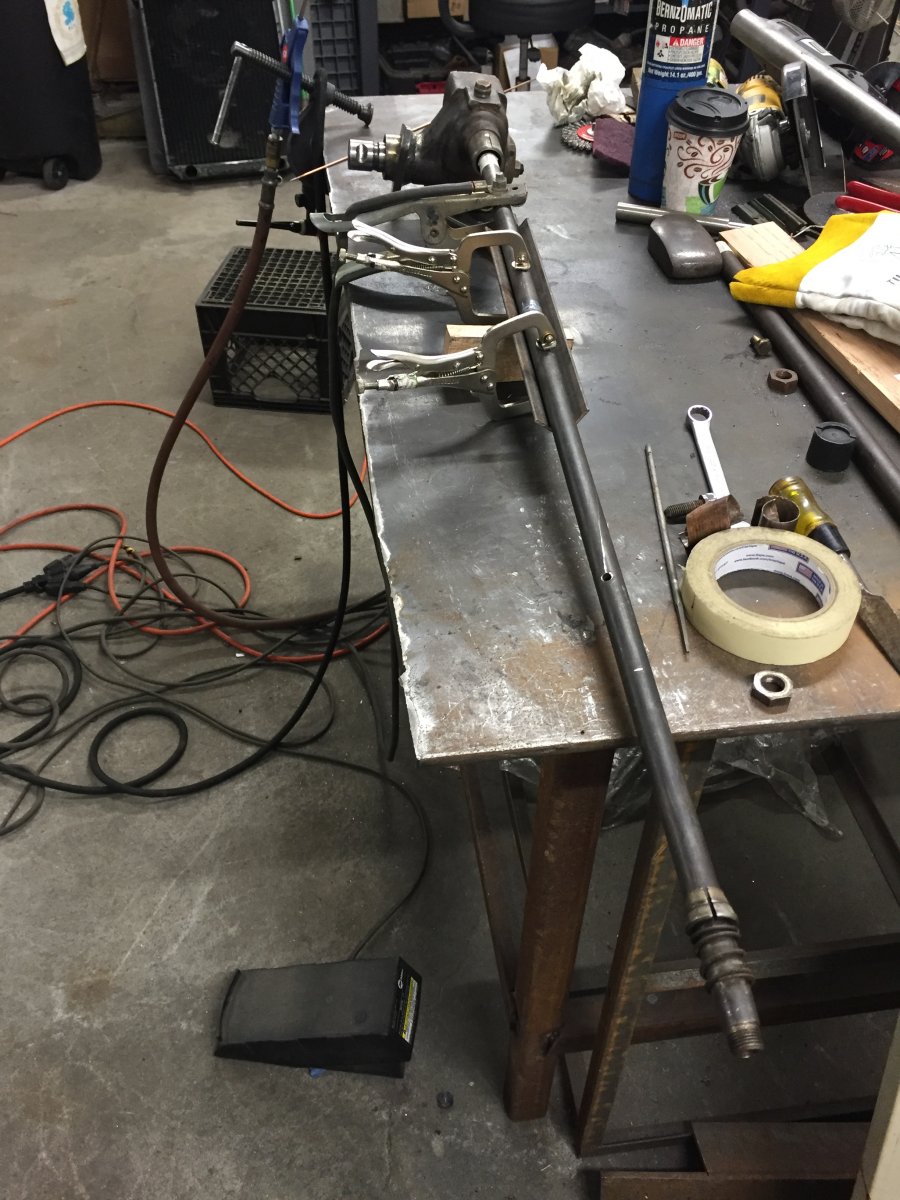

    On the steering box flange, I tried a couple different filler rods but ended up using some er70 in the end. Did a pre/post heat with a propane torch. I probably went over board with the weld but It just didn't look strong with 1 pass image.jpeg image.jpeg Rebuilt the box and then spliced on the taper/key style shaft. image.jpeg image.jpeg

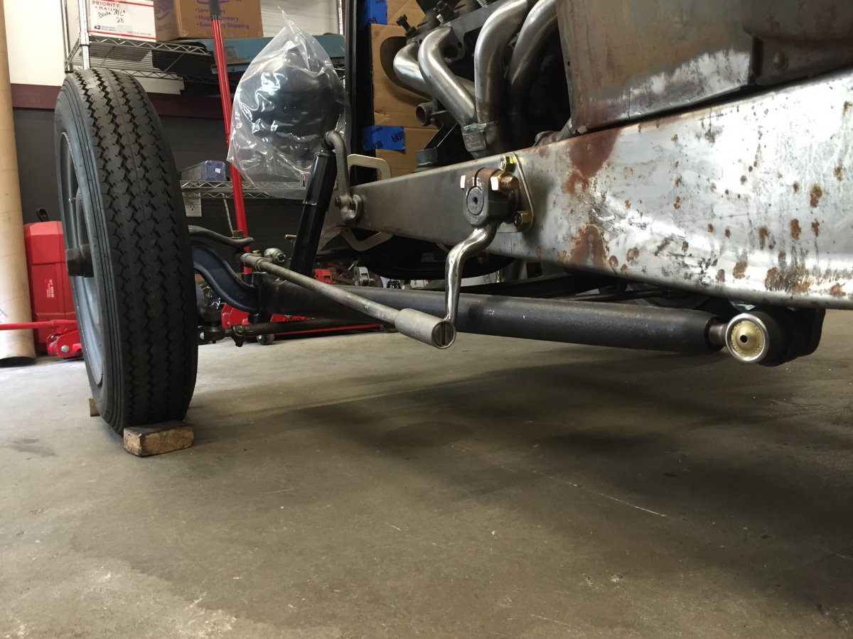

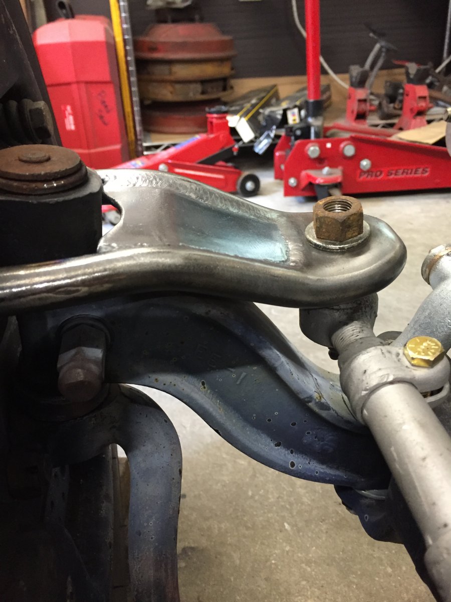

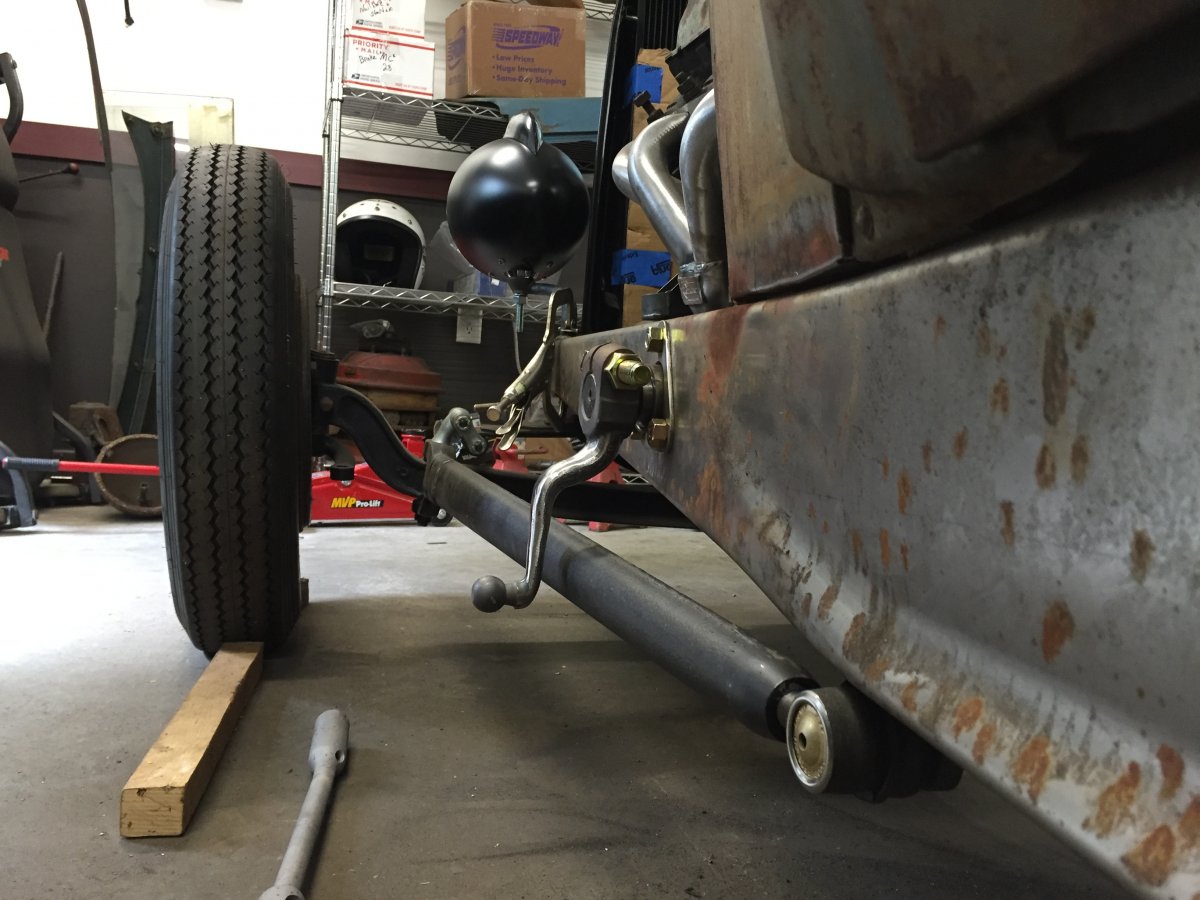

    Got the shocks figured out, the upper mount is I think a 50's Chrysler image.jpeg Mounted the wishbones and started fitting the pitman arm. image.jpeg Bent up the steering arms so I could put the tie rod in etc. image.jpeg Shes a steering roller, feels damn good! image.jpeg

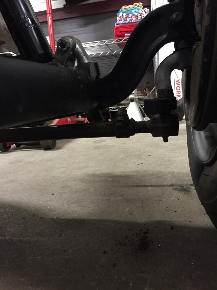

    The drag link angle was kind of steep so I reshaped the hoop this morning, hopefully will work good. image.jpeg Very sturdy now image.jpeg

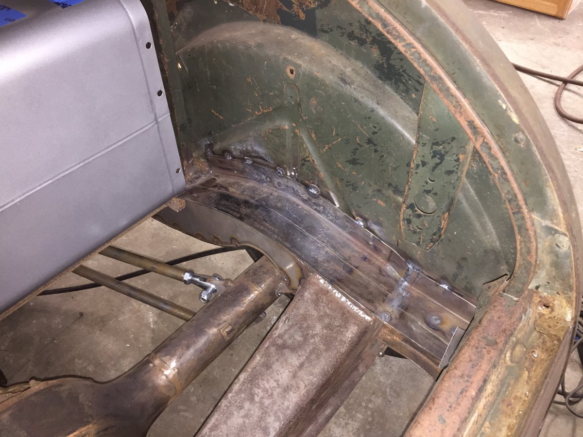

    Been slow the last couple months but I'm back rolling on the 32 sub rail reshape and floor. IMG_0241.JPG IMG_0243.JPG A little wiggly, but it's super strong.
    These sub rail pieces, I basically took 2x3, 1/8" steel and heated, formed it to the frame before welding in. IMG_0234.JPG IMG_0233.JPG

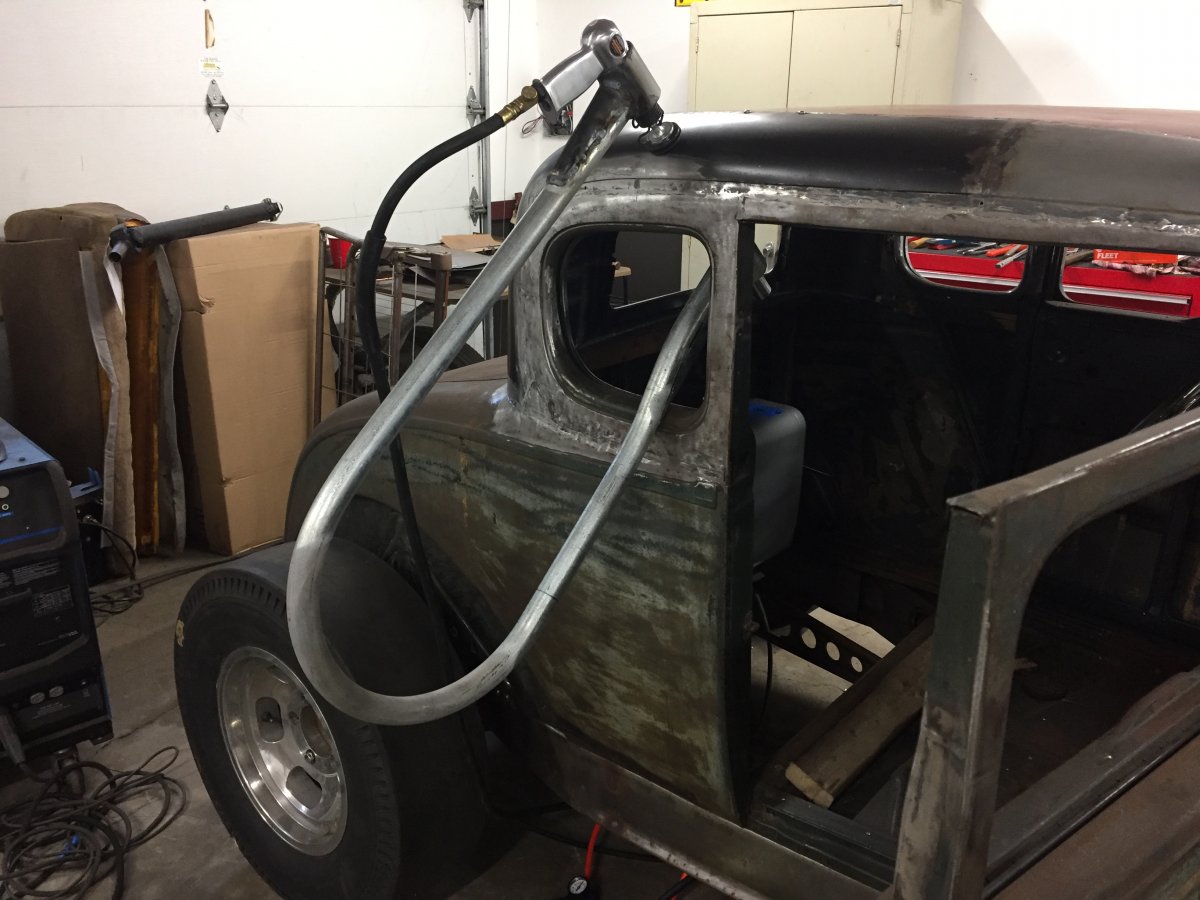

    And lastly, made up this hammer to hopefully get the shape back I need on the roof. It works great so far but man it gets heavy quick. IMG_0239.JPG IMG_0240.JPG
    So that's it for now, I hope to get the floor completed within a couple weeks.
