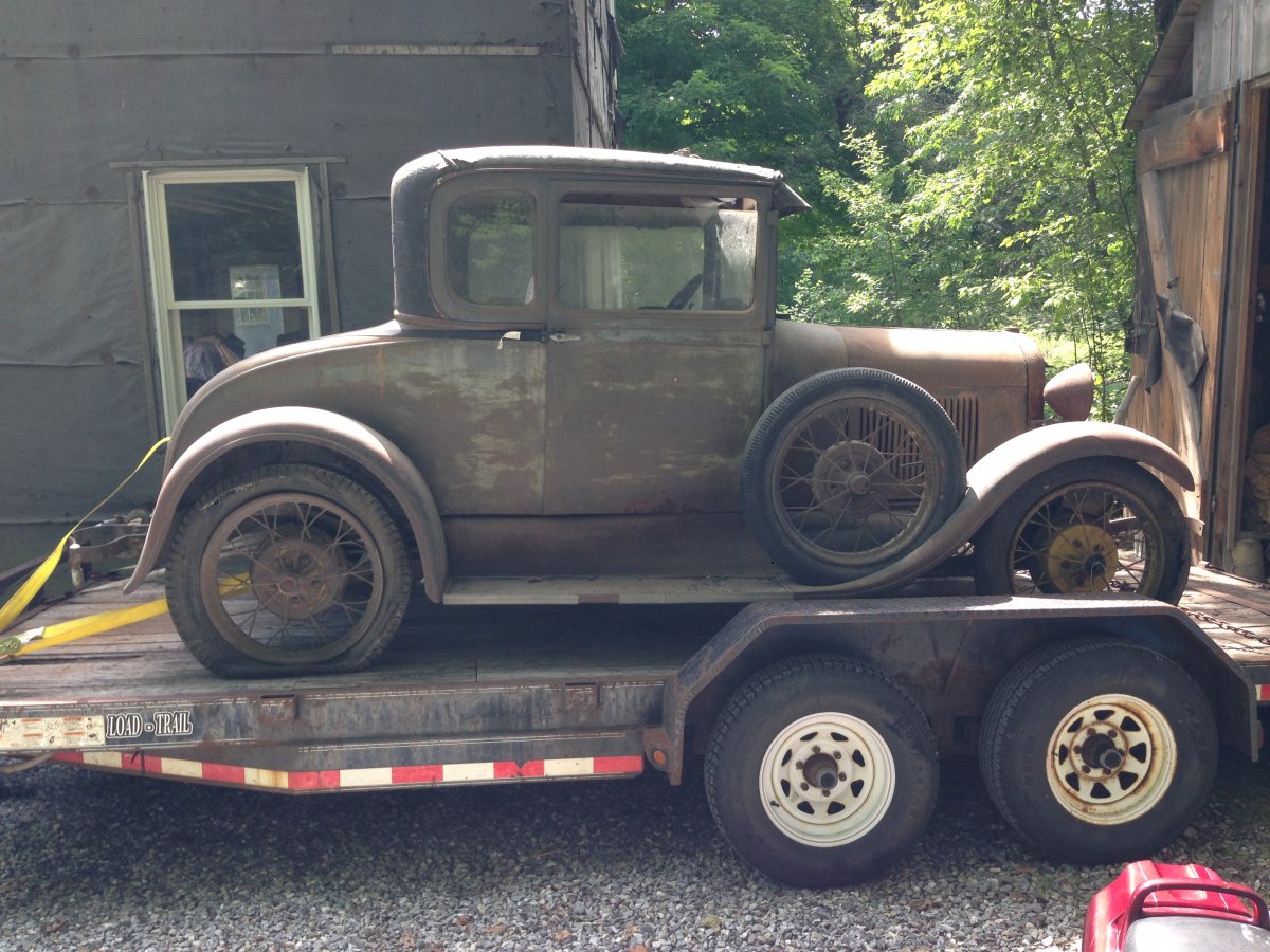

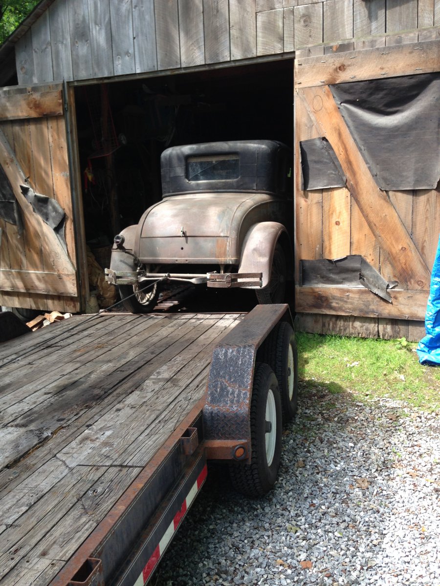

    Let's start off at the purchase......after answering this craigslist ad I drove up the the berkshires and dragged it out from a 60+ year slumber (1952 Ma inspection sticker just barely visible on the windshield) This guy inherited the coupe from his uncle who drove it here in 1948 from Washington state. The Washington paper work was still tied to the column with string, pretty cool. So anyway we cut a deal and I winched her out from her shitty life in a barn. image.jpeg image.jpeg I am not into the leatherback at all but the rest of the body was so perfect I couldn't pass it up. Figured I could find a standard roof to bolt on.

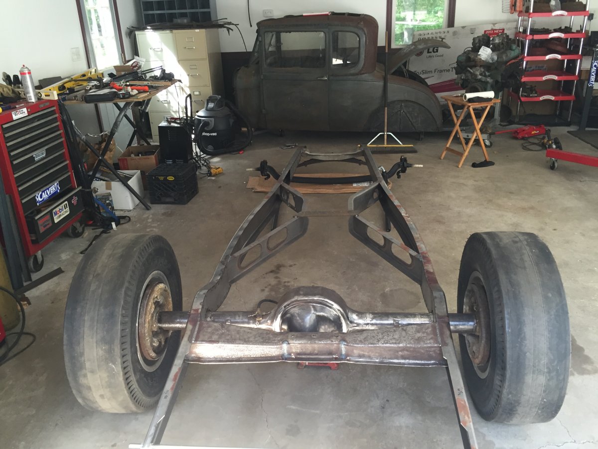

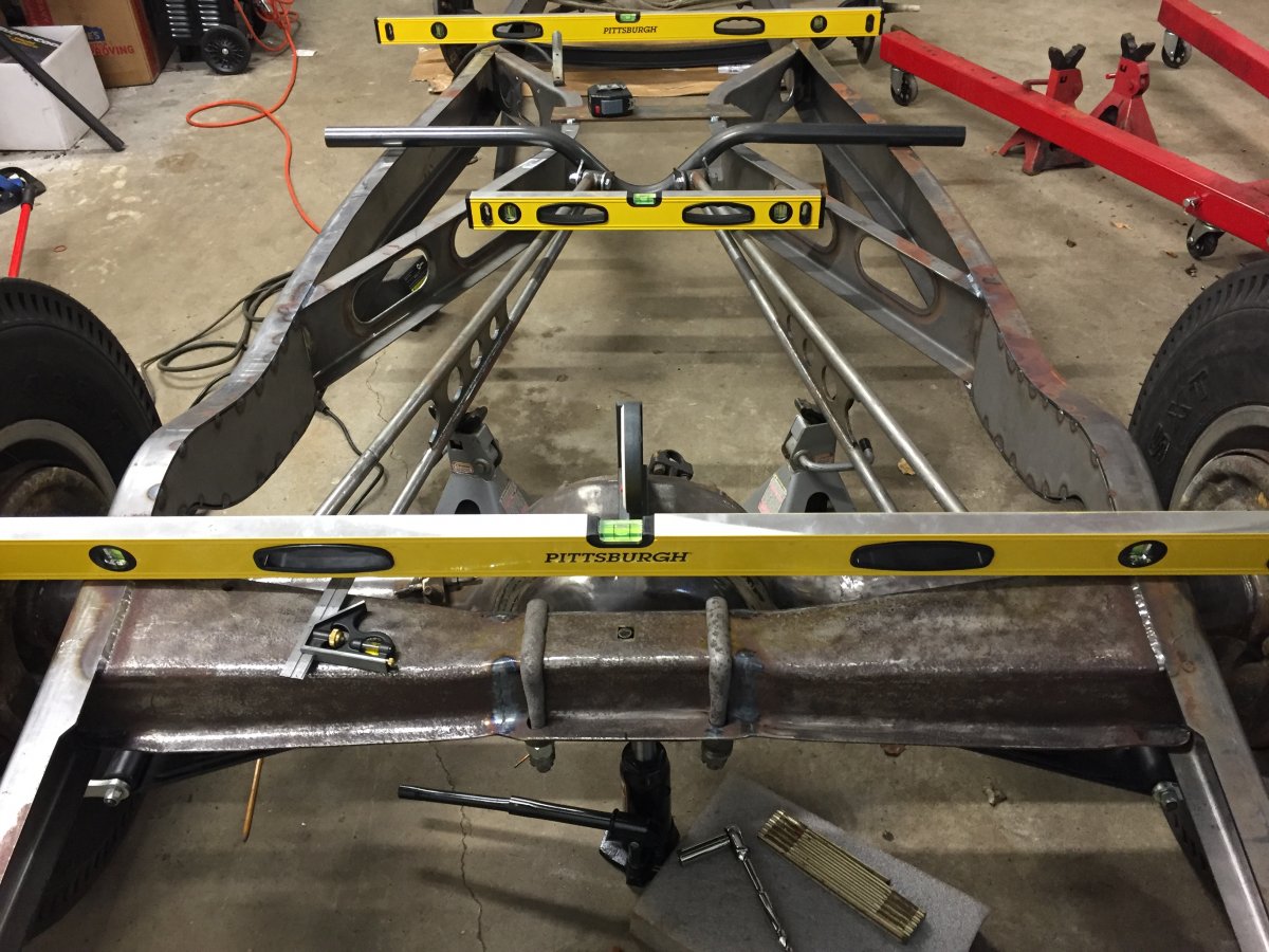

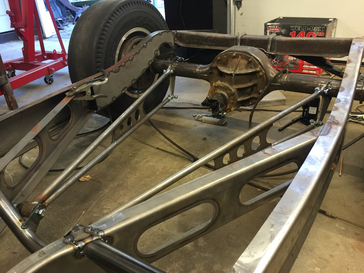

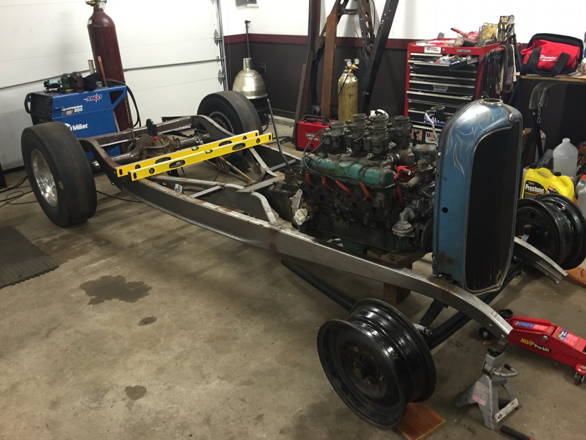

    So once I had the title in my hand (that is a story in itself), I ordered up some JW rails and figured I'd build my own chassis. image.jpeg image.jpeg Flattened out a 40 rear crossmember I had. image.jpeg image.jpeg Pieced together this over the last year. 1.5" drop 32 axle with original 32 spring 40 brakes/bones etc image.jpeg image.jpeg image.jpeg

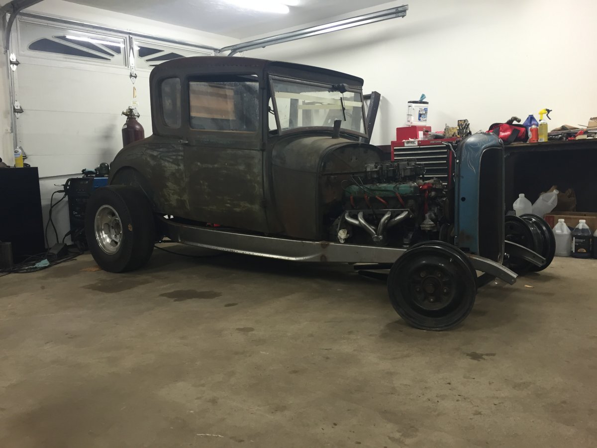

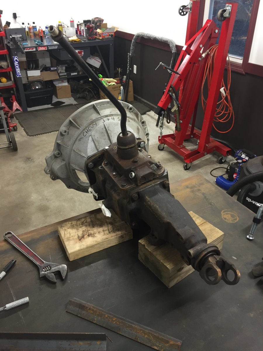

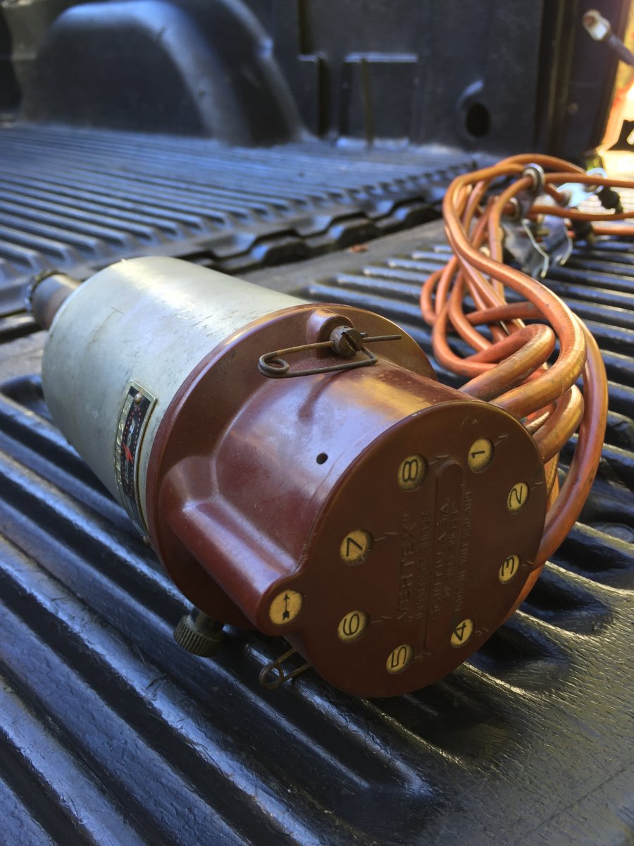

    image.jpeg 40 ford spring in back, 67 Bronco 9" 3.50's etc image.jpeg sunk the ladder bar crossmember into the X image.jpeg scored this mag that had been run on a nailhead powered drag bike you may have seen from the northeast. image.jpeg image.jpeg Had to Rework this jeep shift tower to work on the dearborn top loader. Old transdapt bell. image.jpeg Now we're talkin

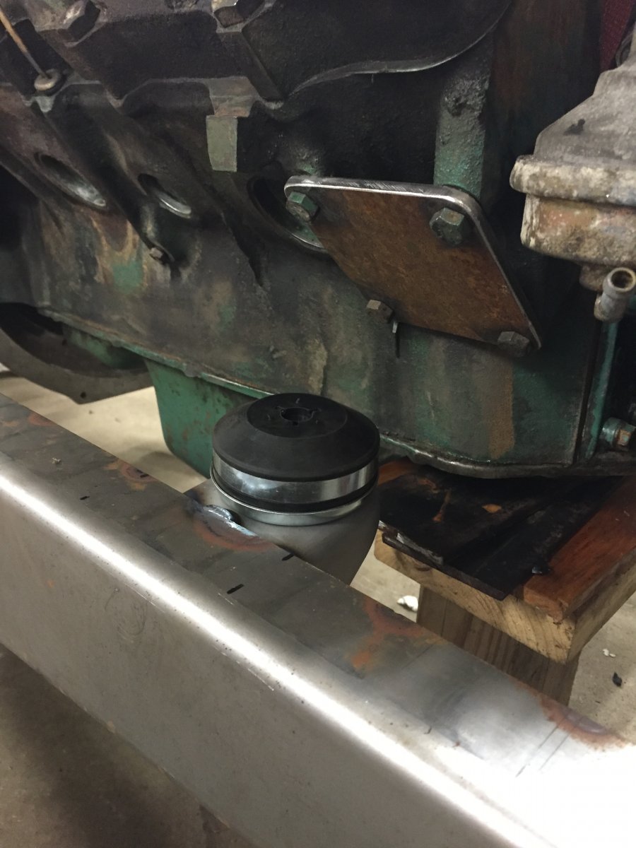

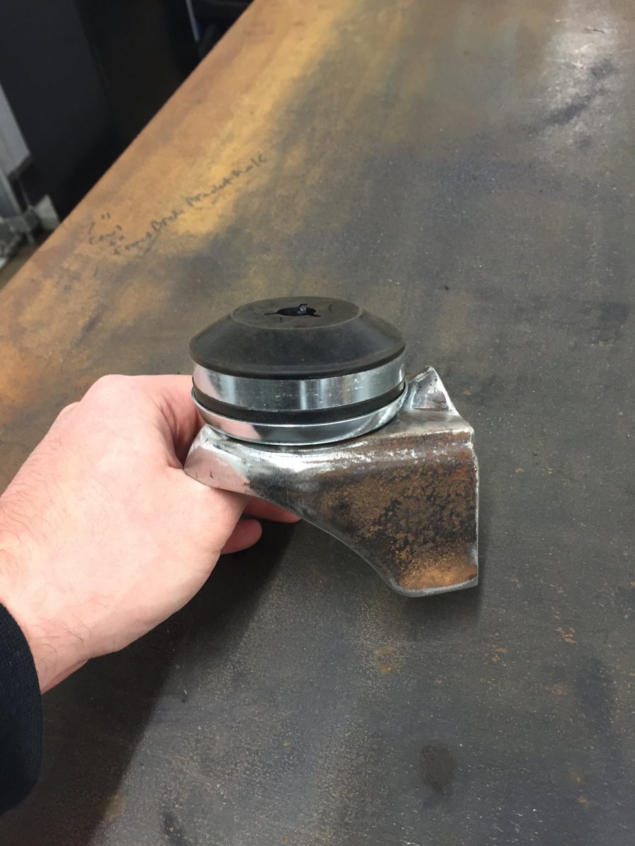

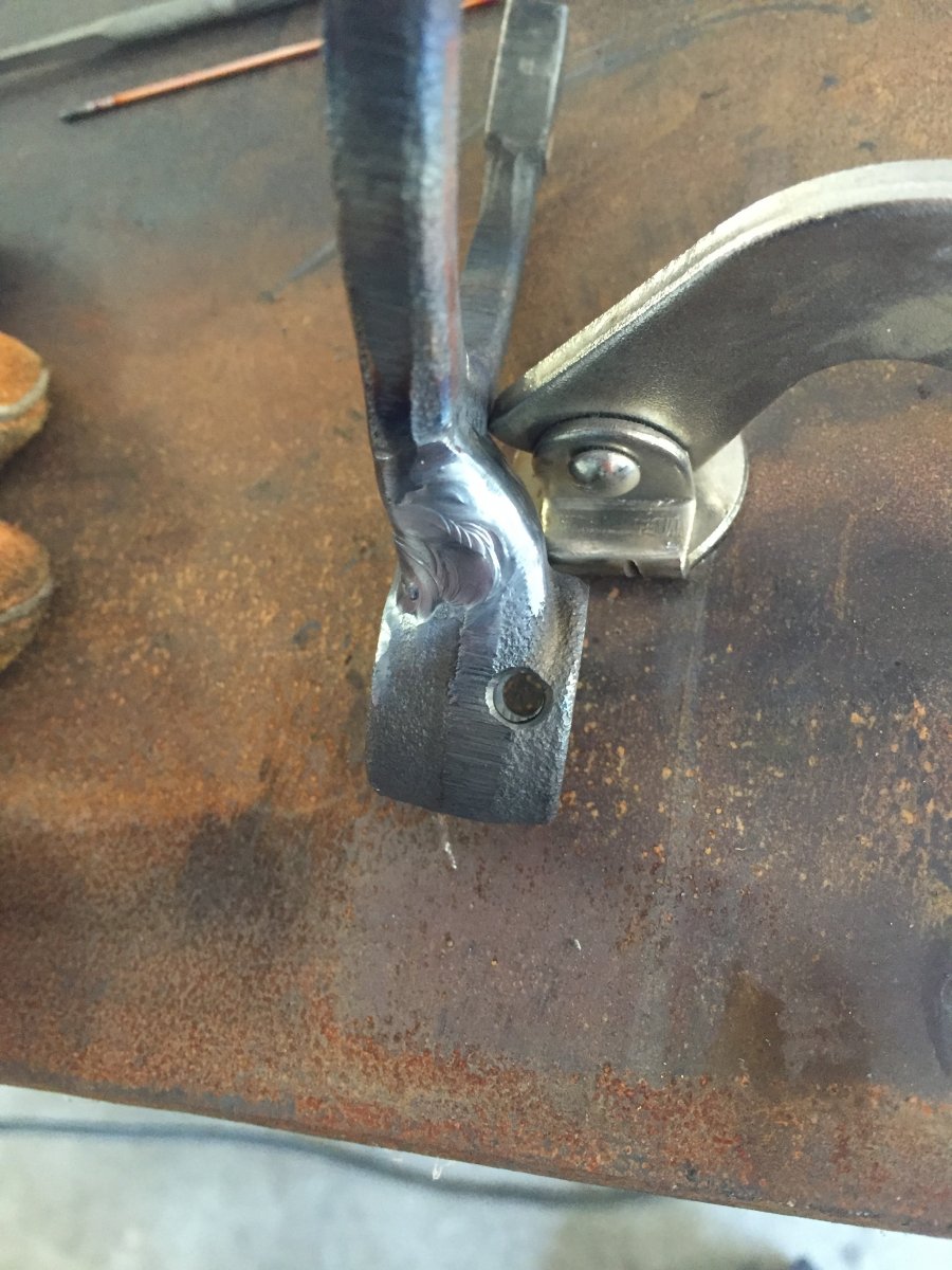

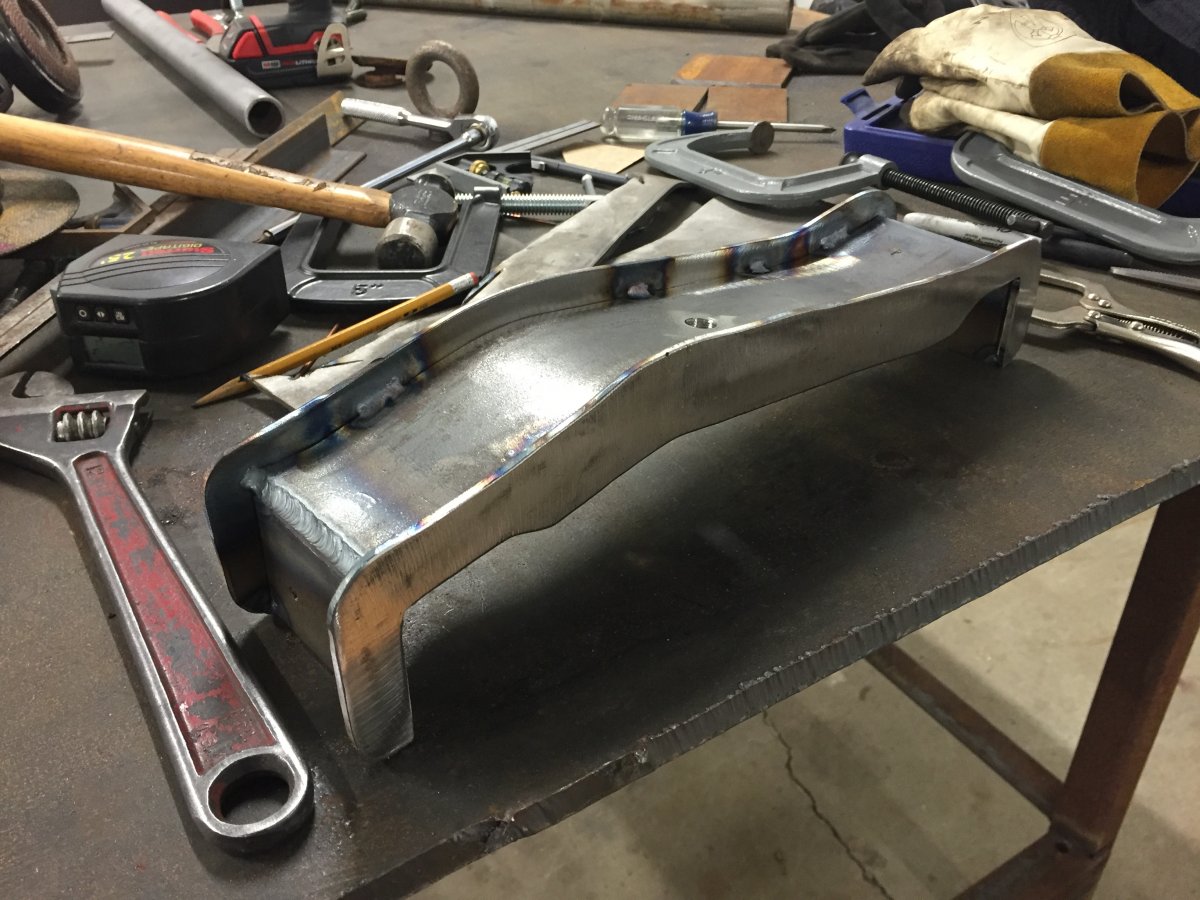

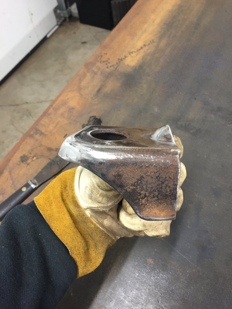

    image.jpeg image.jpeg image.jpeg Made up some frame side engine mounts from a 40 Ford transmission cross member. image.jpeg image.jpeg

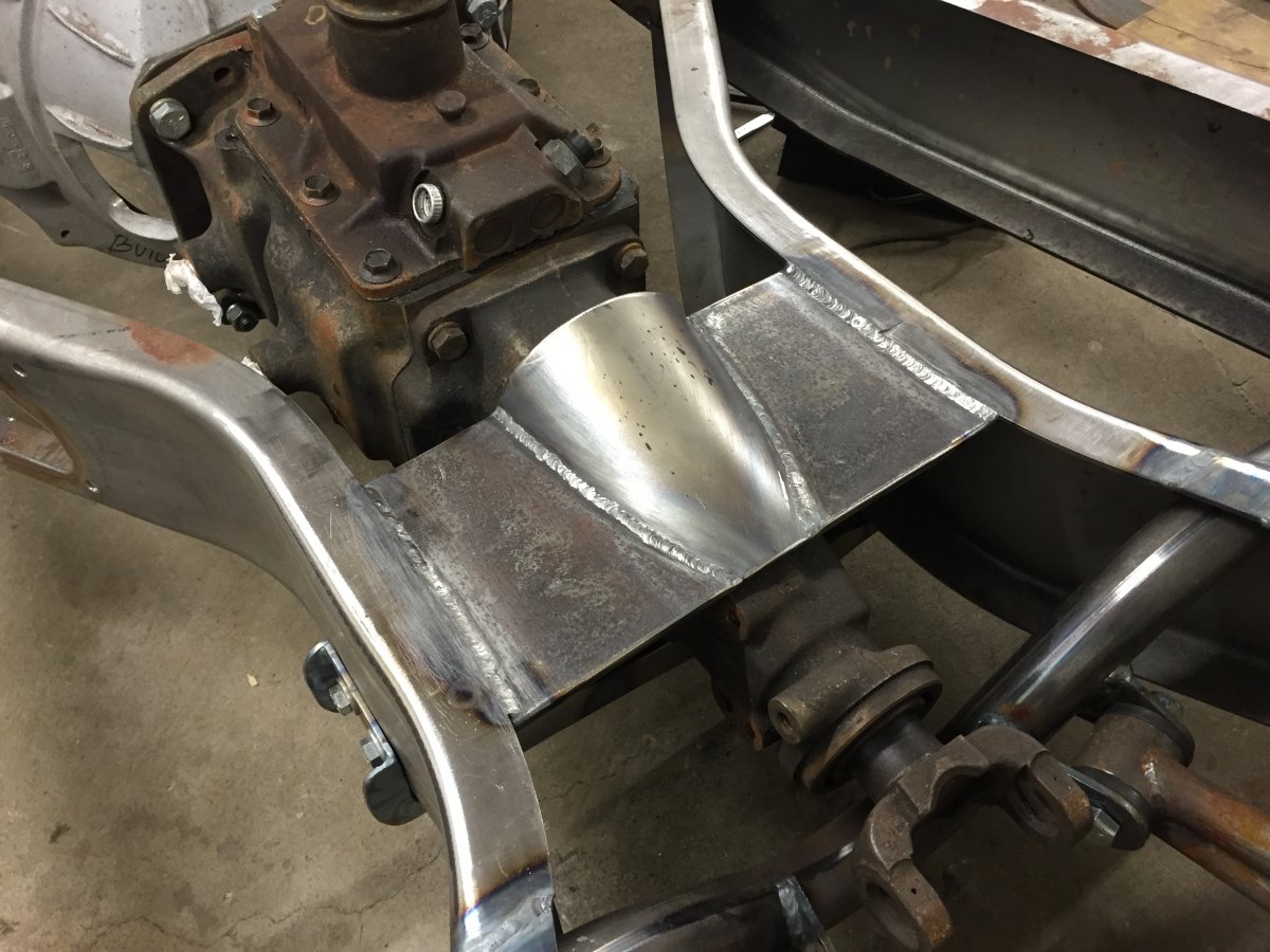

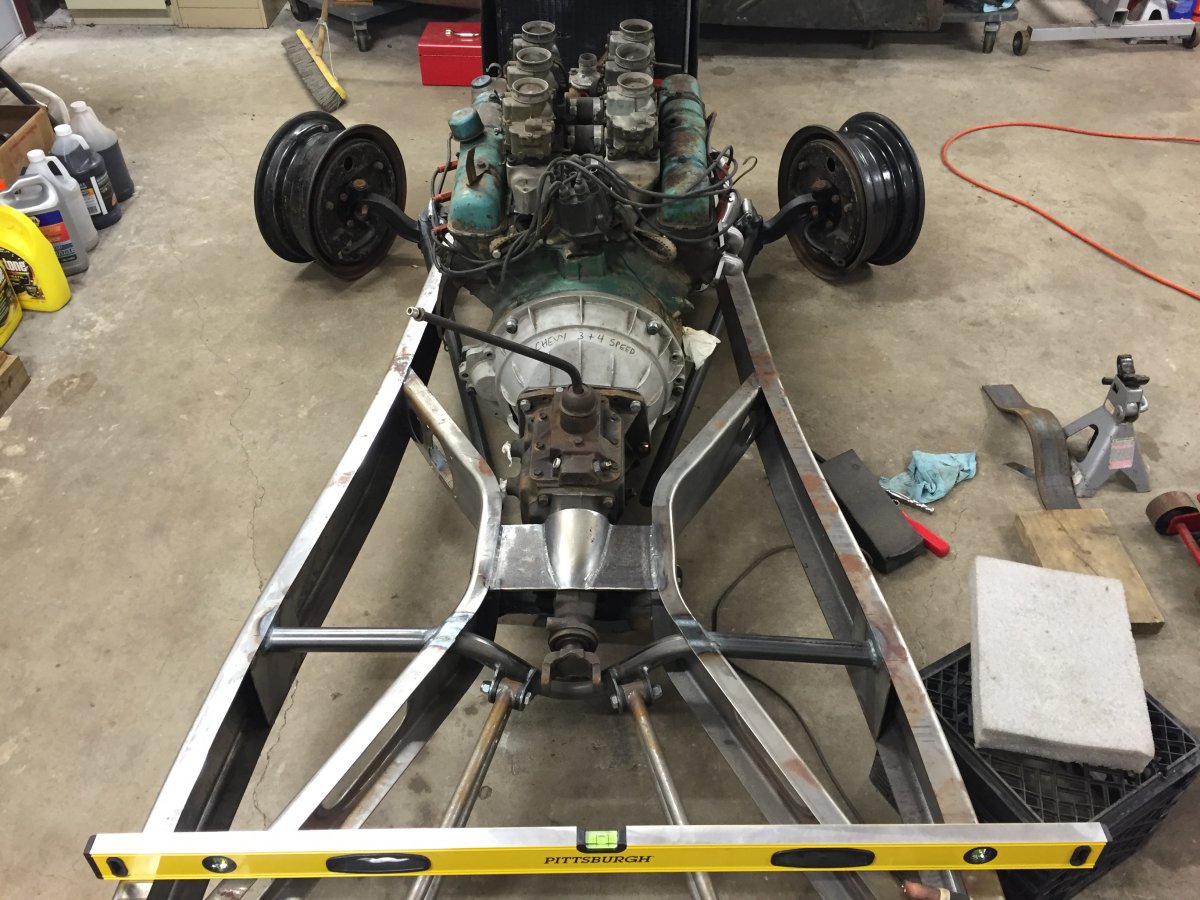

    image.jpeg image.jpeg image.jpeg Trans cross member looks weird cause the tail shaft on that Trans is clocked so I had to lean the mount as well. I made it saddle type to help strengthen up the X member as well. Well that was still hot about an hour ago so that gets us up to date.

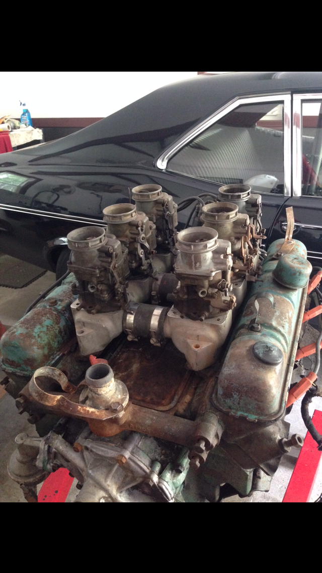

    image.png Big thanks to Jared for hooking me up with the 64 425ci Nailhead and a big box of Holley 94's to make my good six. Also some killer early Cal valve covers.
    I'm thinking of doing a new cam and springs etc and maybe a light clean up on the ports. Would be a tire killer with the stock torque anyway, but more is always better.

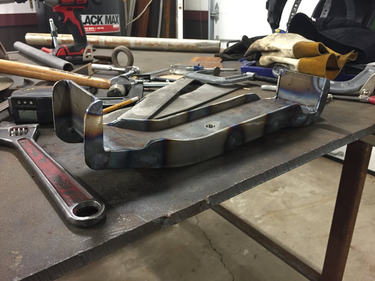

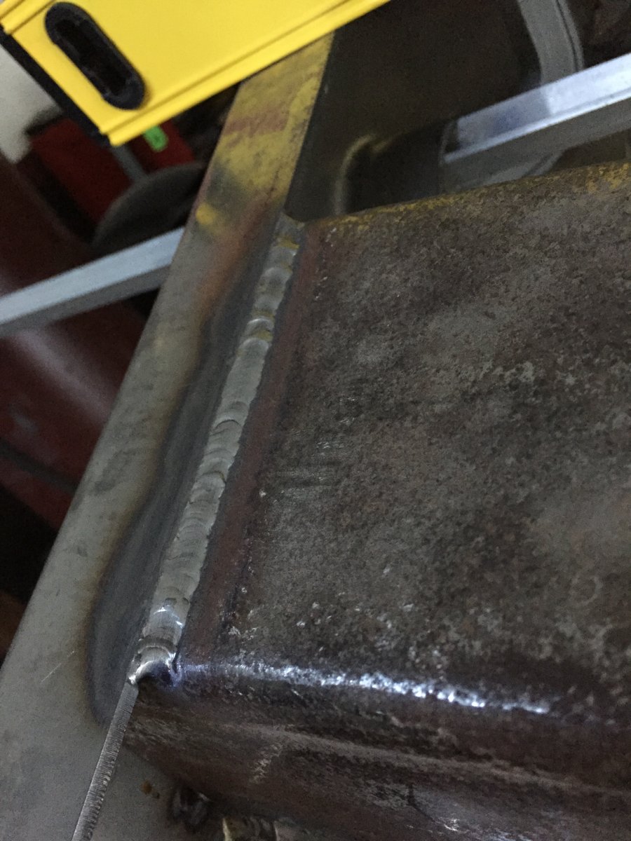

    Made up the top plate for the X tonight, came out pretty good. Should be it for bracing I think. image.jpeg image.jpeg image.jpeg

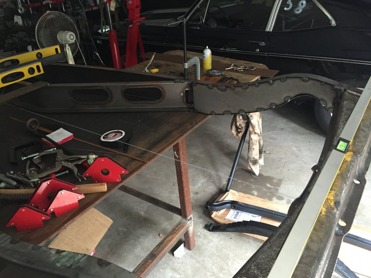

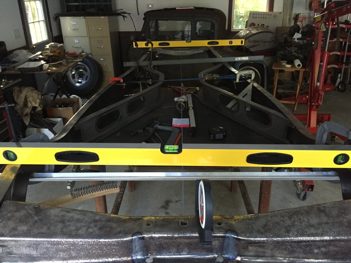

    Thanks, no this is my first hot rod build. I made up a 4'x4' steel table to build the frame one, just kept levels front, back and middle and measured everything a 100 times.
