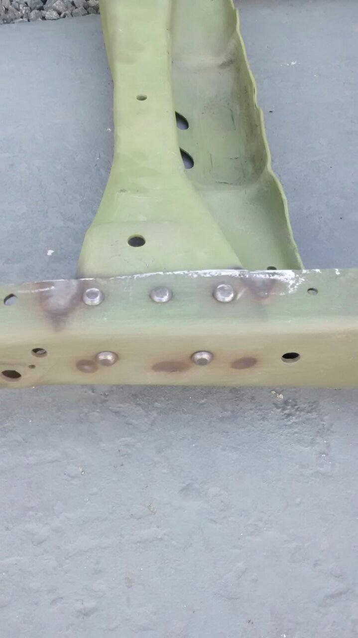

  7. jerseyboy
    Joined: Jul 17, 2006
    Posts: 634
    jerseyboy
    RATA,
    How did you do the rivets? Looks nice!
  8. I bought them in a hardware store... were heated with a torch and hammered.

  11. Sorry for the delay Stogy! That's a phosphatizing paint, an anticorrosive thin layer applied after sandblasted the frame, special because the humidity in my town is very high, this paint is a little transparent, excellent for metalshaping work...
