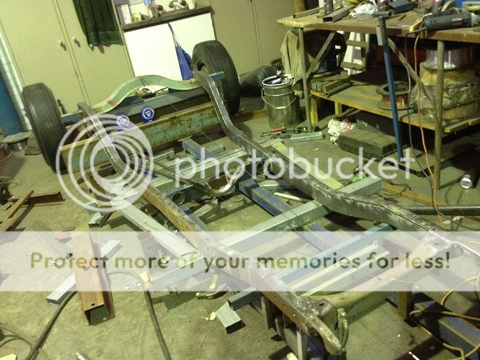

    Lamb
    Bit of progress, got my cross member in and got a few more final welds done on the frame. Laser cut parts aren't in til monday but trying to score a day off next week to get some things done.

    Hey Zombie, little bit of progress - have been busy with other stuff but back on it again now.
    Got my laser cut kick up parts so started on the rear rails last night.
    also got my boxing plates so things should start motoring along.

  9. Lamb
    Joined: Jan 20, 2010
    Posts: 87
    Lamb
    Got the kick up and rear x member setup and mostly welded in.
    Boxing it up tonight (once again overestimated how much I'd get done in a session)

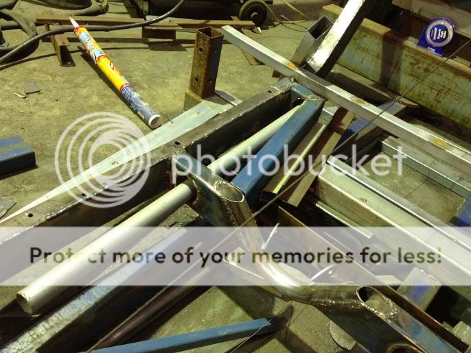

    got the boxing plates for the rear half of the chassis in last night finally and drilled the new ladder bar brackets I got laser cut (they have a flat section to the back which the shock mount will be welded to). Going to box the front and make the x bars tomorrow (fingers crossed)

    chassis is mostly boxed now, just need to flip it over and weld up the bits I couldn't get to from the top, pretty pleased with how it's going so far.
    I started making the sections up for the rear K, hole saw is a slow thing (should have probably bought a bigger drill press)

    got some more done saturday.
    dismantled the jig and cleaned up shop (there goes half a day)
    Finished welding up a few corners on the chassis and boxed the part underneath the front x-member, I bent the back edge of the chassis down in between the sides of the x member to lock it all in and create a tiny bit more clearance.
    got my ladder bar brackets onto the diff and adjusted my spring brackets a little (had them at 0 degrees pinion angle before , now it's +3 to match the engine.
    dropped the engine and box in to see what needs doing, she's definately not a compact lump of iron.
    also shortened my ladder bars a touch and re-tapped them (5/8" threading gives my little arms a work out), drilled my bones out to fit the machined bosses.
    sat in the drivers spot and made car noises and drank scotch.
    should be able to make the clutch pedal go straight into the bell housing (striper did his this way apparently)
