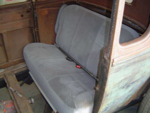

    Looking for ideas for what has worked well for you for a bench seat for a 28/29 Model A Roadster. If you have pictures that would be even better. Thanks

    Allot of people run minivan middle row bench seats. They are the narrowest. I have a 94 Aerostar seat in my sedan. It may be agood for a roadster as well. It folds down which would give some acess to some behind the seat storage if you wanted.

    I used a 2001 Dodge Caravan center seat in my tudor. You may need to trim it up for a roadster. Easy to do though. The are made entirely of round tubestock. It folds forward as well!

    like tracy mentioned about the mini van seat ....i have a newer windstar middle....my past a's have had chrysler middles....but they didn't fold..... brandon:D
