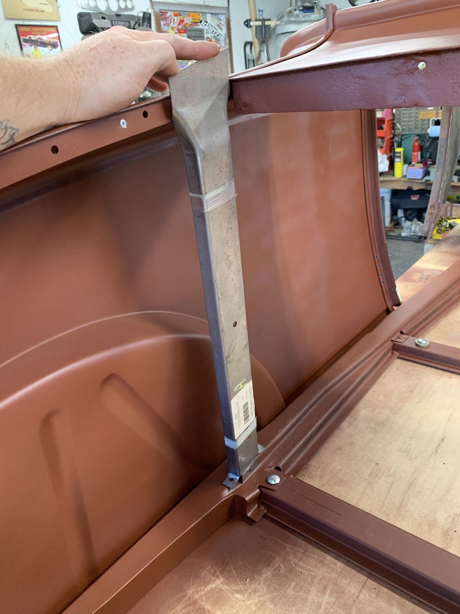

    My question is about the location of the inner quarter panel braces that connect the top of the quarters to the subrails, ahead of the rumble compartment.

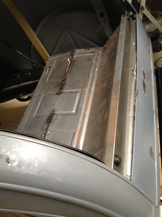

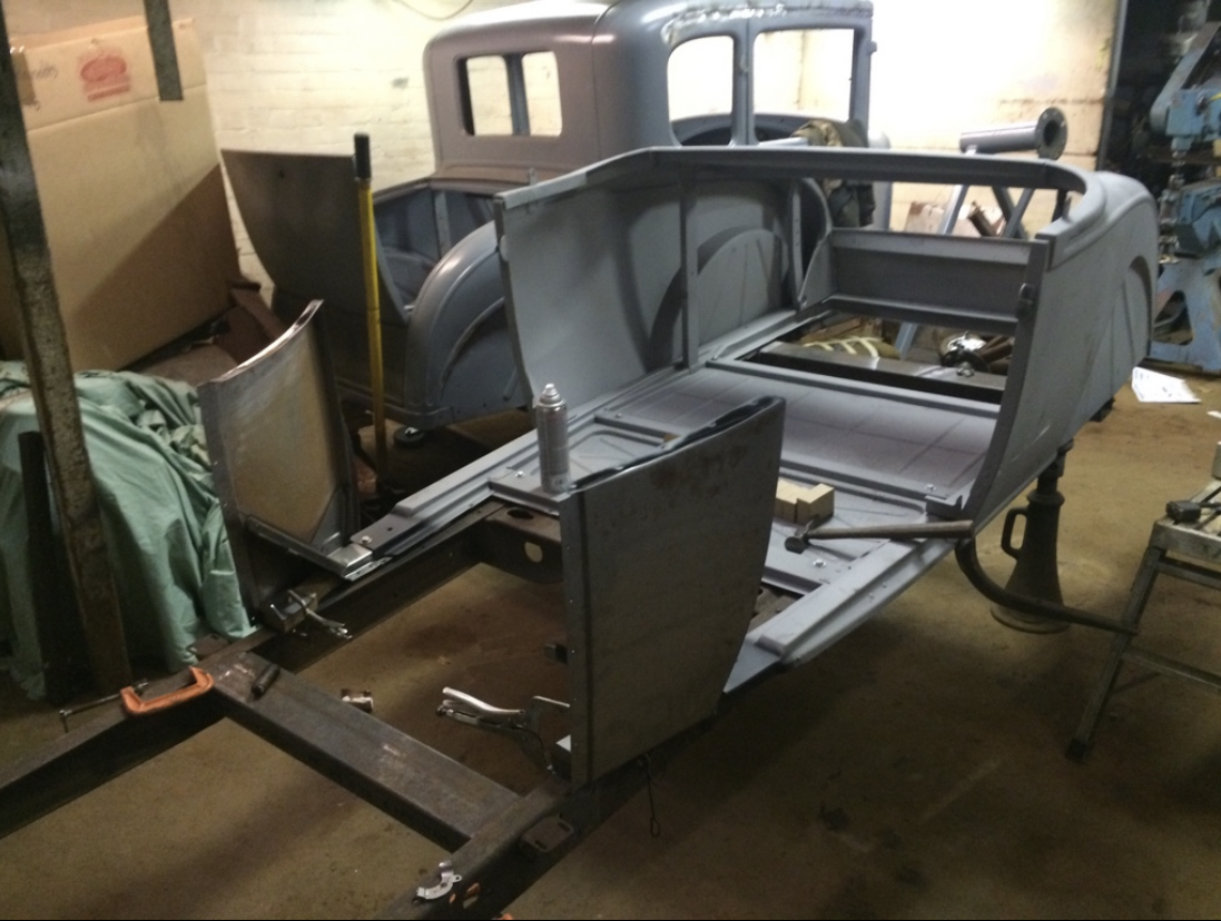

    A picture I found here on the HAMB, and the shape of my replacement brace, both suggest that the following placement would be correct.
    My Car:
    That picture from the HAMB that seems to support this placement:

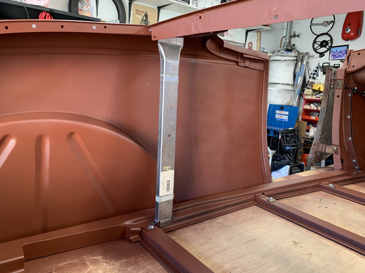

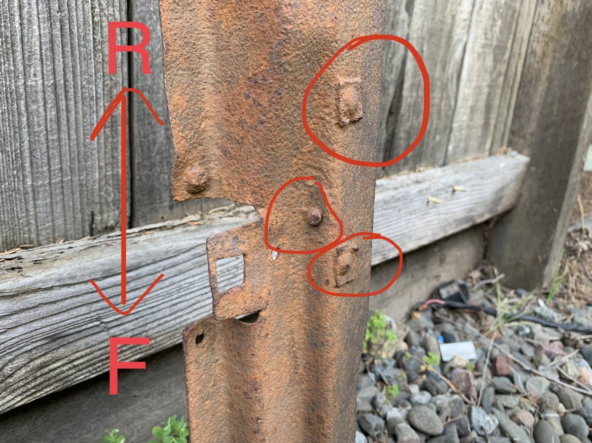

    However, my subrails appear to suggest that the brace was originally positioned higher up on the subrail, and further rearward:
    So that would land the brace roughly here on my car (but of course it’s far too long for that positioning):
    Though this picture from the HAMB seems to support this more rearward positioning:
    Anyway...what do you all think? What attaches to these braces? Is anything really even dependent upon their positioning? Does anyone here have a really original body that’s never been apart?

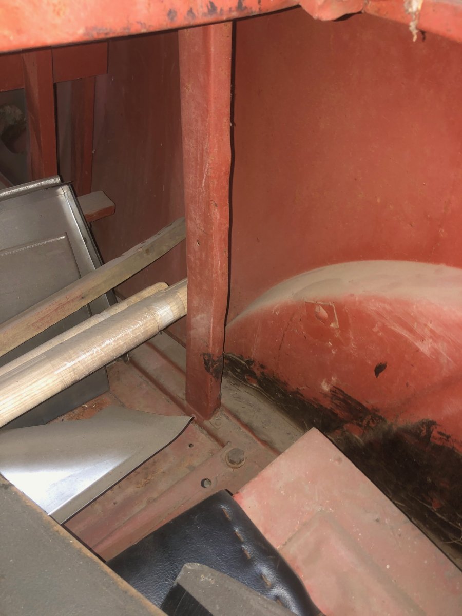

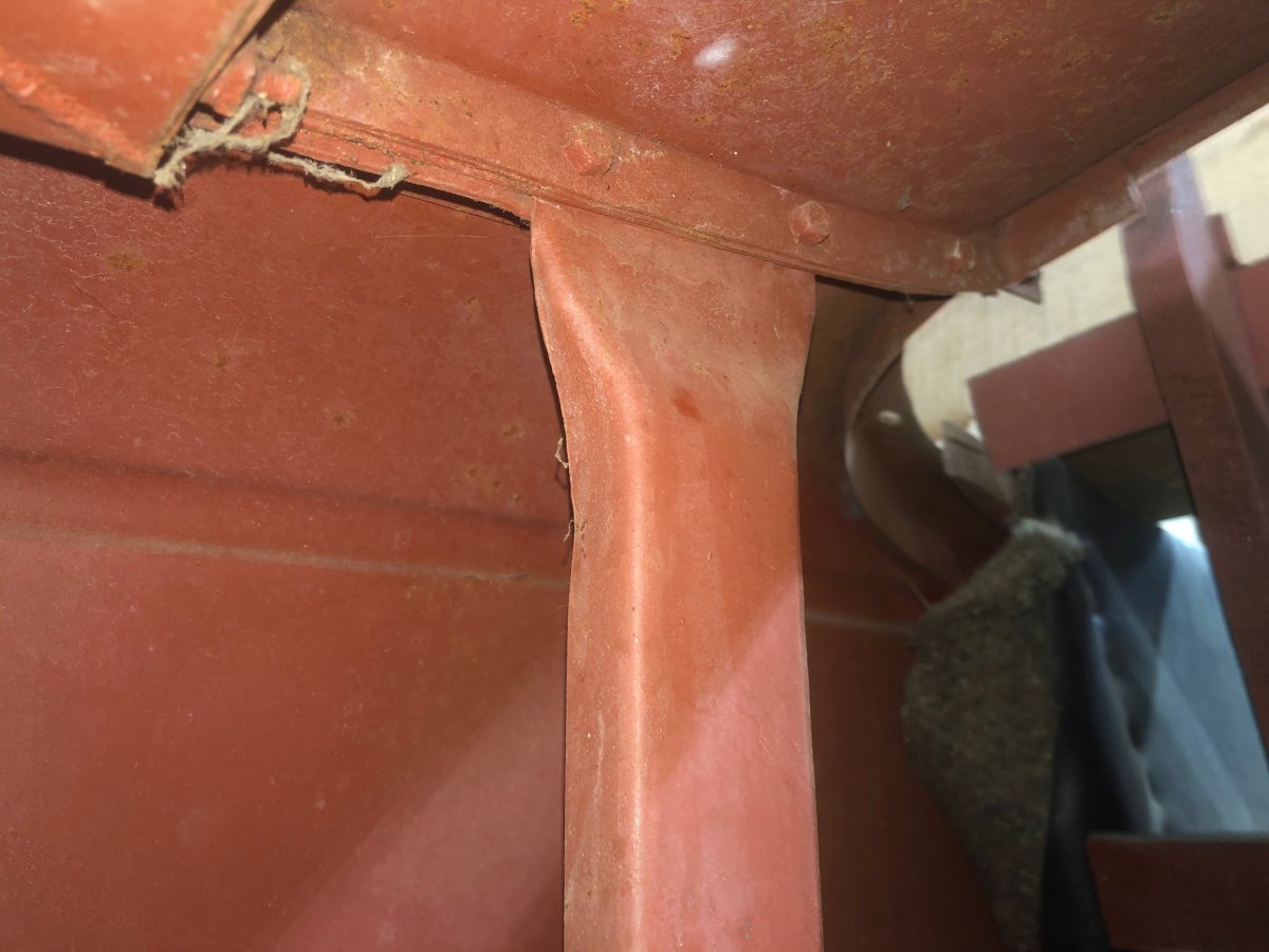

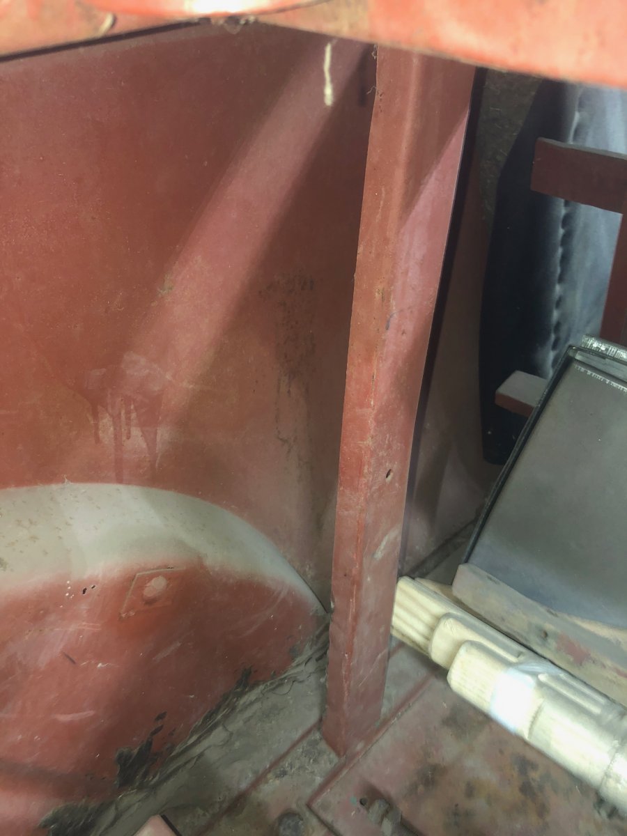

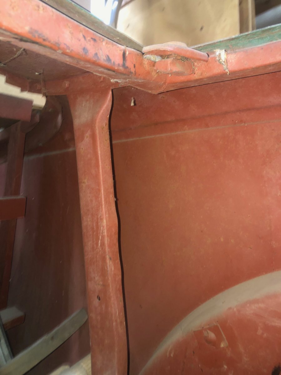

    Not since I have had it the lower fasteners appear original car when I got it was a cosmetic restoration done about 25 years ago never rodded

    Further this car is 1929 made in Canada

    My 31 coupe had the braces like Bobs, on the lower part. Only thing on them were the rumble hinges ( on the rear ones) Mine were original , I dont have pics cause I modified the sub rails to fit a 32 frame. Was also a Canadian car.
