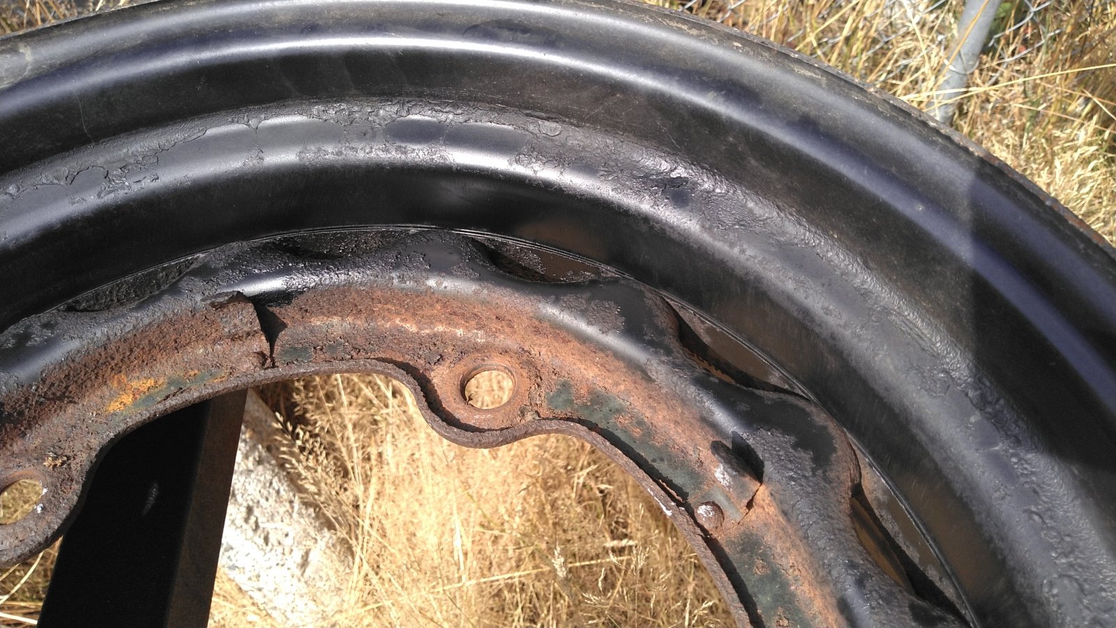

    55willys
    I still don't like it. I am going to cut out the piece between the spokes, then tig weld and grind the 3 sides to look as one. I will reinstall the center and weld the back side of the spokes. This will leave all the rivets in place and will be plenty strong with 15 1" welds. 16298440098954807473886000190830.jpg
