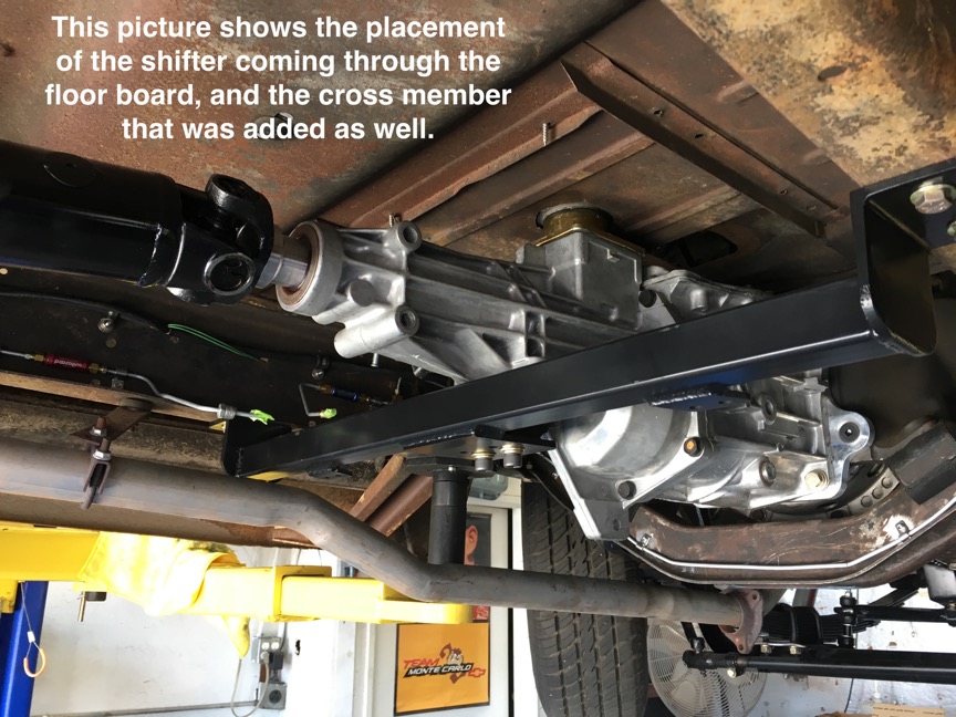

    Kansas, I can only tell you what I ended up doing on my build. I was in the same situation as you, not wanting to be a hazard to other drivers on the highway. My engine was beggin' for mercy by the time I hit 55 mph on the highway.
    I have a 54 GMC half-ton with a 1946 270 that was bolted to the original granny four speed, enclosed driveline, and stock differential. I have swapped out the transmission for a T5 1993 Chevy S10 with electronic speedometer. You may have to find another year if you will still have a mechanical speedo. I have converted my truck to 12 volt so the electronic speedometer was not a problem. The '93 was recommended because the placement of the shifter is more forward (toward the engine) to make sure the shifter is not coming up through the seats. There are probably other years that work as well but that is what I went with. The shaft on the T5 however needed to be shortened some and also honed back some to work with my stock fork and throwout bearing. I also had to have my clutch plate rebuilt by replacing the 14 spline hub to accept the 26 spline on the T5. I have also swapped out my stock differential for a 12 bolt Chevy 3.73 differential. I don't know anything about the Muncie 4 speeds so I can't help you there. tranny02.jpg Good luck with your build.
