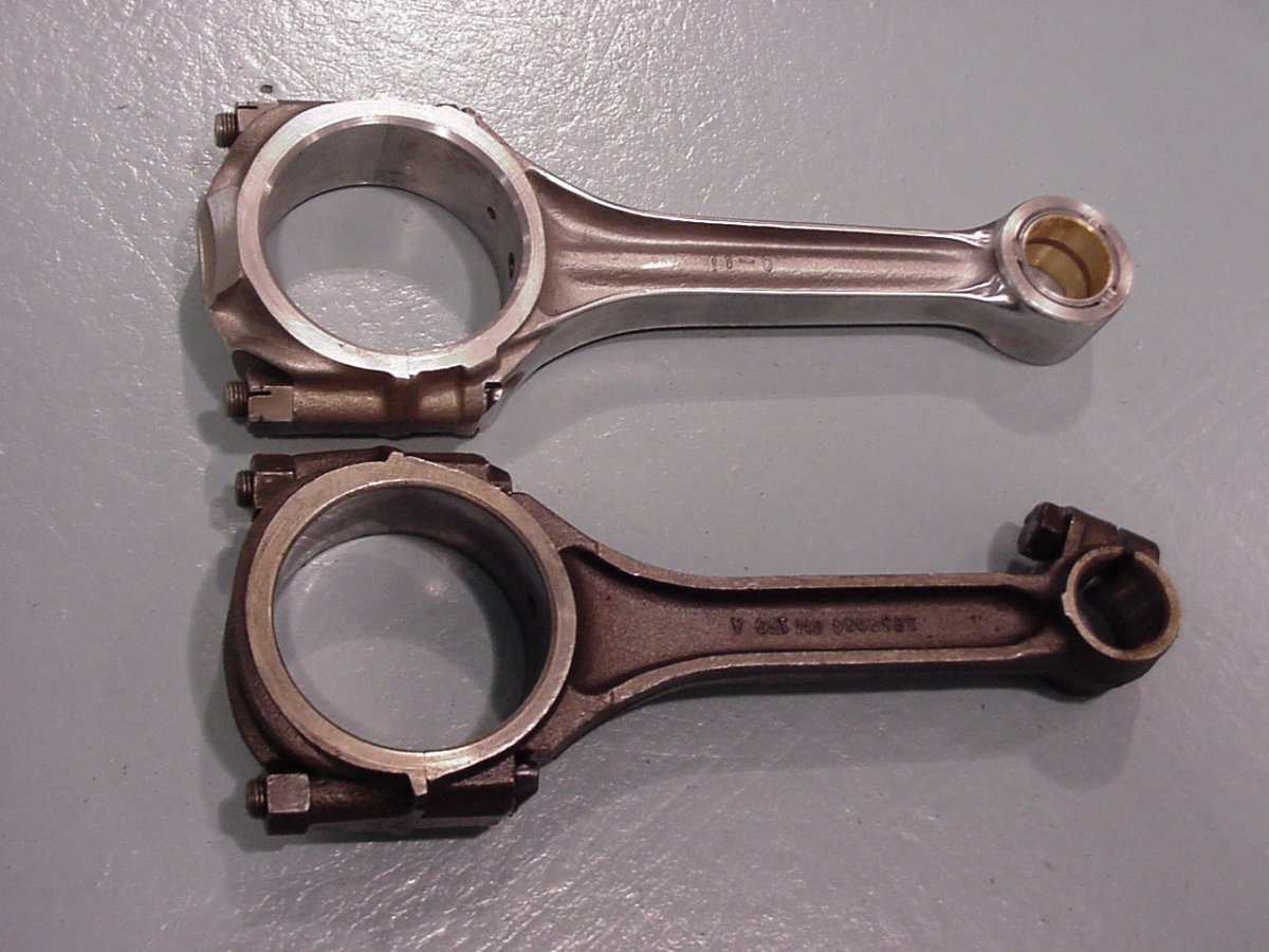

  2. I think requires of V6 Buick Pistons
    I just run A.R.P. Ford 460 bolts in my 261s
    [​IMG][​IMG][​IMG]

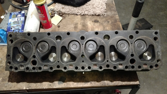

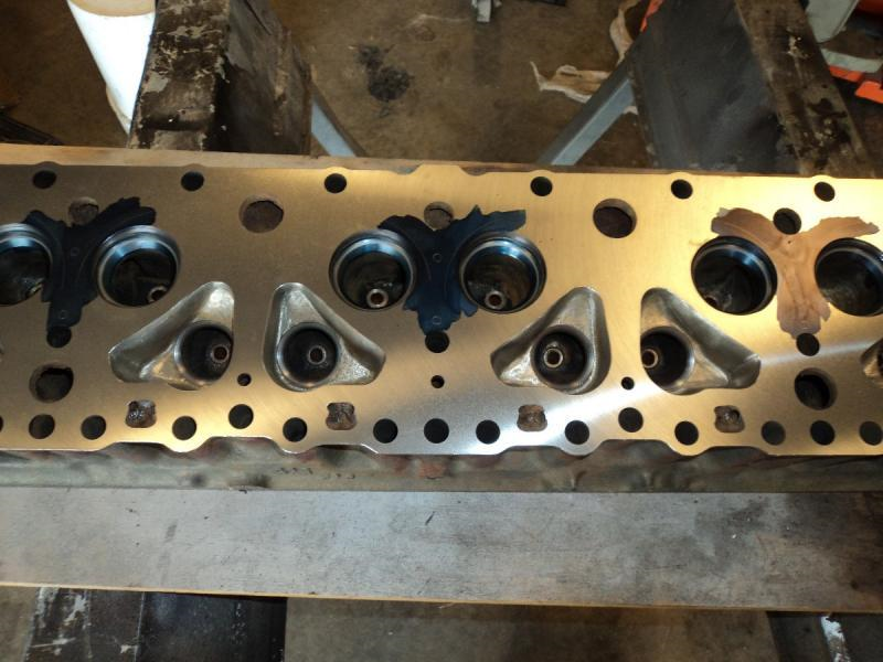

  15. Gofannon
    Joined: Feb 8, 2007
    Posts: 927
    Gofannon
    Just my hypothesis, but if you compare the top pic, a stock 950 head off a 261 (same chamber as 913), with the bottom pic, a severely milled 848, take note of the area of the combustion chamber that would be over the piston. This is the path that exhaust gases have to take to reach the exhaust port. The stock head is much more open, it's like relieving the block on a flathead.

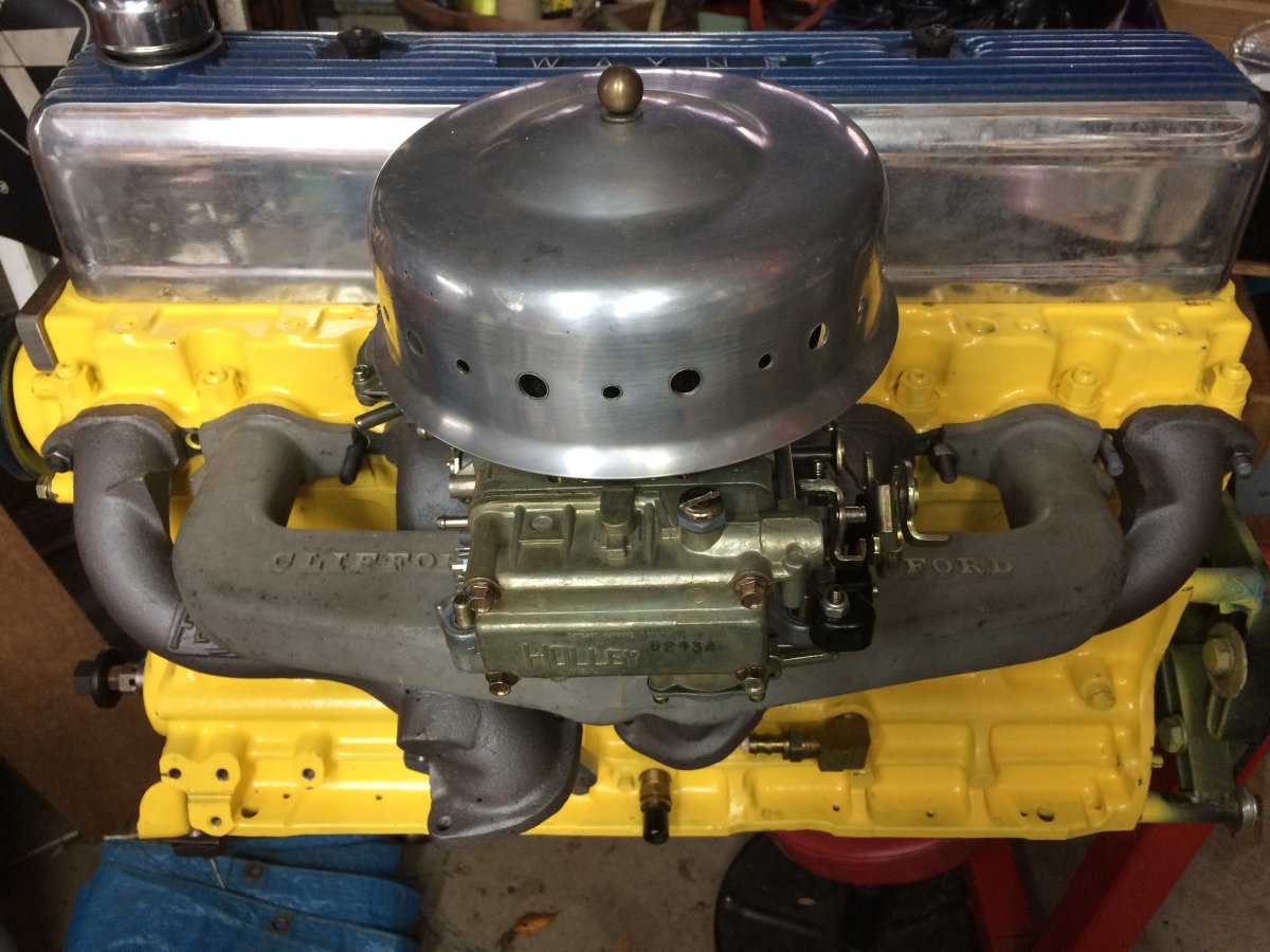

  17. Cosmo49
    Joined: Jan 15, 2007
    Posts: 1,554
    Cosmo49
    1962 261, Clifford intake, Fenton’s old style with integral heat plenum, Holley 390 cfm. I am using the 913 head, ported. This was the first style of 235/261 Clifford 4 barrel offered, the newer models are water heat to the base of the carburetor plenum, this older one is exhaust heat. No wonder, IMHO, why you don't see more of these, why they didn't catch on. Poor fit to the stock or old Corvette style dual exhaust.
    A machinist friend married the two warring families together, a perfect union of Clifford and Fenton. If you look closely you can see the aluminum build up, quite an education to watch him work, he's a great talent.
