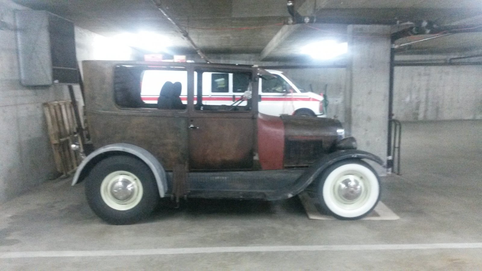

  1. My first build. Alot of work and sweat, but I will drive it one day. 20150617_113925.jpg 20150617_113925.jpg 20150617_113915.jpg

    Ok, I like it too, But the rear wheels look a little to far forward and the front wheel look a little to far back. Maybe it just the pictures, But?

    I am interested in your experience with the Wintec chassis because I am considering it for my 27 Tudor as well. I need to learn how to weld but still curious about how much fabrication you have to do to it? What mounts or other items did you have to add? Anything you didn't like or had to change? Thanks.

  20. All the mounts are done for you.
    Mine is set up for sbc and mustang steering box.
    Coilovers in the back. four bars in the front. Master cylinder mount sway bar.Body mounts, and steering box mount. The only think you need is a transmission mount.
    If you talk with them they can probably make it for what ever you thinking about four a motor.
    Everything fit for me. I just had a fews problems with the 37 spindles, to make them work with the four bar.

    Great, thanks. Can you address the question about how the wheels are centered in the fenders? Is it just the angle of the picture? I have seen some rods where the wheels are not centered correctly and it always jumps out at you.

  23. Take a look at other fendered T's. Its bag on to me. Just the way the fenders are.
