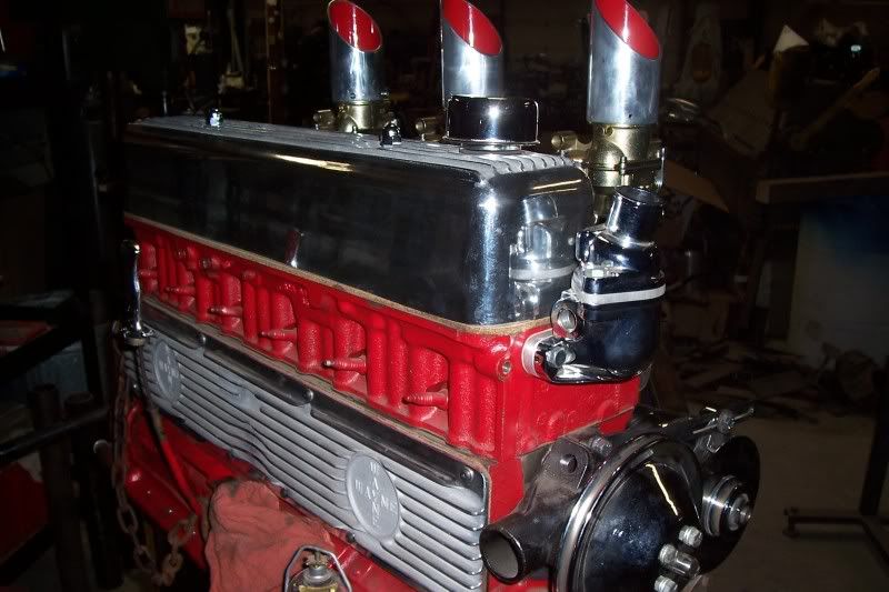

  10. I took these pics today at the shop.............Thought you inline guys might like 'em.

    Very nice! What intake and carbs are those?
  12. It's not mine......carbs are Ford 94'S....intake is three piece with balance tubes, forgot the name.

    from eastcoast
    harper? possibly

    blackrat40
    C@@L red sparkplugs!
  16. They used to be flat black..................

    CTFuzz, could you get a picture of that intake from the side and the top. I'm trying to match that one to one I know of.
    Thanks.

    yes it is a harper intake
  21. [​IMG]
    CrkInsp...............I hope these pictures help, I can take more if needed.

    CTFuzz,
    Thanks for the pic's.
    What size are the balance tube holes? Years ago we built (welded) similar setups for Roch. carbs and used 1" balance tube. They worked great on 261+" engines for dirt track use.
