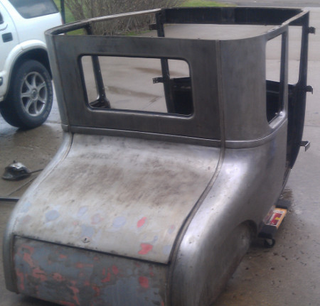

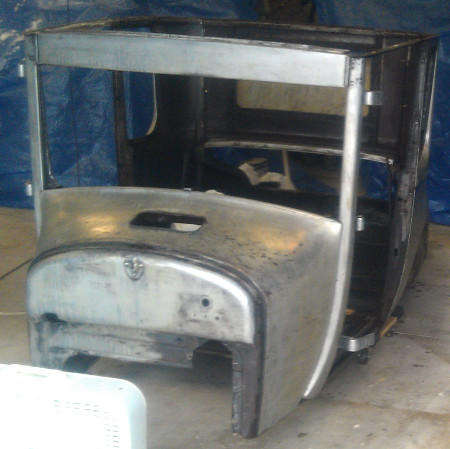

    With the unseasonablely warm weather over the weekend we were able to get Lizzy painted :p
    This is the Story of that adventure.
    It started on a warm dark Friday night with a 25 mile ride on a trailer. Shortly before reaching the warmth and safety of Tony's garage. Lizzy wash washed in a local car wash.
    After spending the Night drying and acclimating to her temporary home. She was drug out into the drive wash and washed again. This time with Por15 's Marine Clean. After toweling off she was sprayed down with Por 15's prep and ready.
    Twentyish minutes later she was out of the shower, Toweled dry and back in the garage drying.

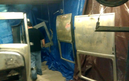

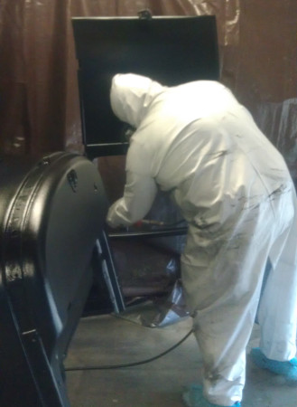

    It was Time for Jim and Bruce to "SUIT UP!!":rolleyes:
    [​IMG][​IMG]
    There was some vandalism of My Suit!! :confused:
    The First coat that was applied was Por15 Rust preventive. The Goal was to coat everything with 2 coats of this. (by the way this stuff does not wash off of you with anything... Trust us we found out the hard way!)
    We shot in the inside.
    The OutSide.
    The Underside
    We ran through the whole quart in a few hours.

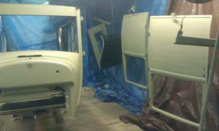

    After waiting the required time (45 ish minutes) and refueling (pizza)...Thanks Tony!
    We Started with the Primer.... I thought I asked the guys at NAPA for Black Primer... But was greeted with baby poop green when the can was opened. It's been some time since I bought the primer so returning it is not an option. But after spraying it for a bit... We all decided that we liked it.
    In Fact had this been a 40's car it would have stayed this color :)
    At this point is was about 1Am or so.. We turned out the lights and left Lizzy to spend the night warm in her underwear for the rest of the evening.

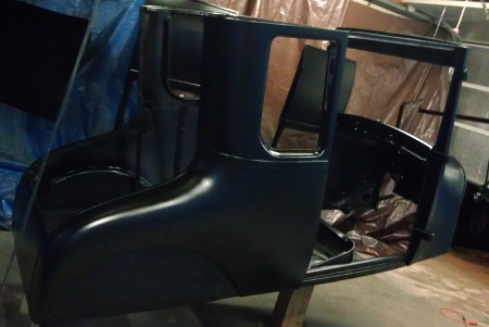

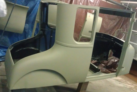

    Sunday morning after church and a quick lunch we laid down the "Color" Black. We mixed up some Valspar Tractor and implement paint with some Naphtha to thin it enough to Spray.
    We Cleaned up and Called it a weekend!
    She has a nice matte finish. It's not a smooth see your self in it Show finish...it sorta looks like a teflon pan. But it's what we were going for.
    One side note... For those of you that have never painted (like us) a car before. It's not hard... Read, follow the directions and take your time. The prep work took almost as long as painting did. Having some realistic expectations helps too. we knew that we were not going to get a perfect paint car with the setup we have... nor did we expect it. If we wanted that most likely it would have been in paint shop. It may not look like it but painting is a workout .... so expect things to be sore!!...

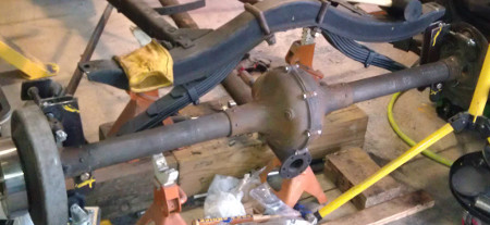

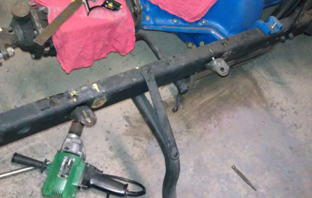

    So a Long time ago (the beginning of November) we were working on getting the MKII drop shackles ready for installation....
    Now that the paint is done we're back to the chassis again. We picked up were we left off. the MKII drop shackles.
    We were able to get holes for zerks drilled and tapped. The bushings and zerks were then installed. We reamed the bushings to 9/16". We then installed the drop shackles onto the rear end.
    We left the Tails long and still need to trim some of the corners off . (the yellow paint marker marks are reminders)
    [​IMG] [​IMG]
    The design change on the drops gave us the clearances that we needed. But also showed us that to keep the Axle centered now we're going to need to add a panhard bar. Designs for that are still bouncing around in our heads.

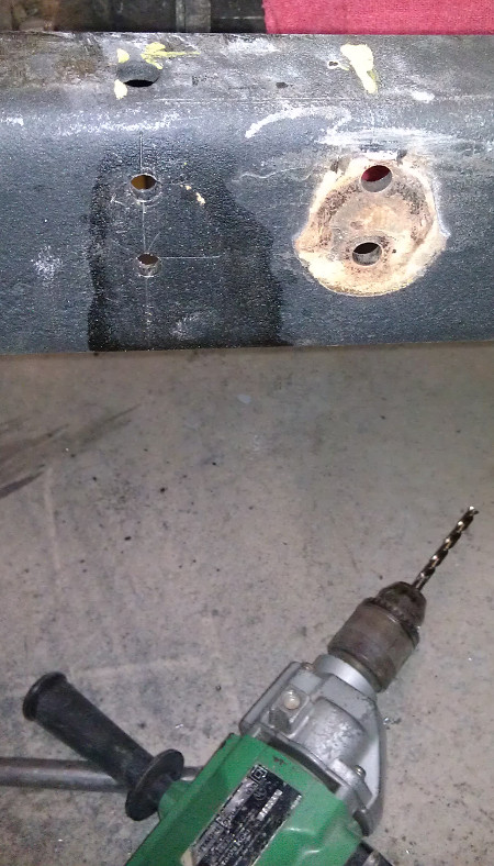

    We also started the task of moving the Body mounts back 2 1/4" on the frame. We have heard horror stories about how hard it is to drill through the Model T frame... So I picked up 6 Cobalt drill bits and 2 Carbide tipped drill bits to help. Since we were not using the drill press and the Carbide tips are so easy to chip we opted to start with the Cobalt drill bits.
    I'm not sure if it was the Sharp new Cobalt bits or if it was the size of our Drill...But we had two 1/4" holes drilled in the rail in less then 3 minutes.
    We were able to get the two "easy" mounts moved quickly.
    We have to look for some creative solutions to most of the rest of the mounts as we have things like E-brake handles and running board braces in the way.
    We're going to knock all the holes we need in the frame. Then we're going to have a "Rivet Party" with some buddies coming to heat and beat some rivets into the old girl.

  16. davo461
    Joined: May 13, 2007
    Posts: 345
    davo461
    Is a Watt's linkage a better option?
    A Panhard rod can cause sideways movement, especially if it is only short.
    Just my $00.02.

    Nice job guys as usual! The Mark II drop shackles are looking great and look plenty stout.
    I find it odd that you had a such an easy time cutting through that frame. I had Cobalt bits as well....and they were dull after 2 holes. I had to resort to drilling starter holes first with smaller bits, but the larger ones still kept going dull after 2 or 3 holes.
    ....maybe I had crappy bits? :confused:

    If it makes you feel any better....we tried enlarging one hole with a Harbor Freight bit.... It took twice as long and way more oil to hut open the 3/64 of an inch....the bits can make the difference.
    CBB
  19. MrModelT
    Joined: Nov 11, 2008
    Posts: 2,745
    MrModelT
    That is a good point, but Harbor Freight is the last place I go for good cobalt bits :) We actually did by higher end bits....cost me $25 or $30 for them.
    ....maybe my frame is a super rare Chrome Vanadium version....or mine has some big hard spots :D
