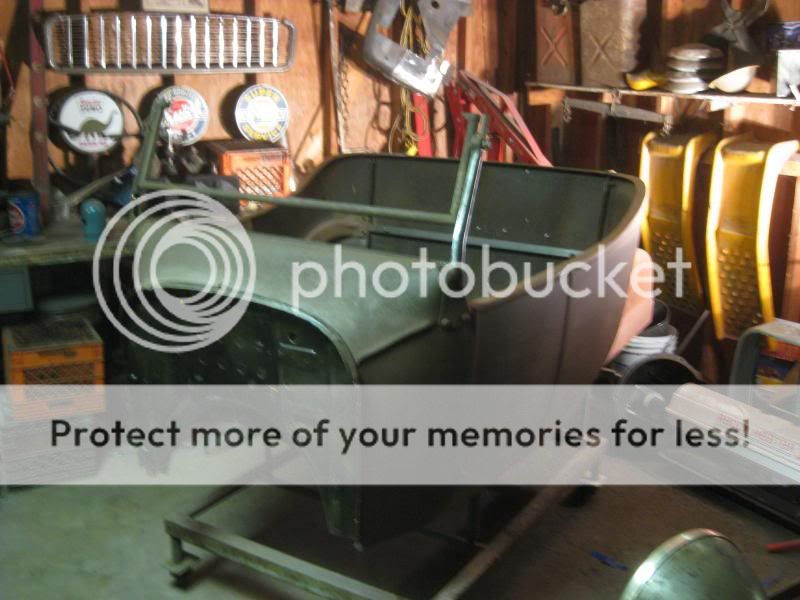

    So as of today I have a roadster that used to be a touring car that was destined to be a couch (last owner was going to make a couch out of it) and I think it fits the bill. Some stuff I had to wing but for the most part I like how it turned out. I decided to slant the windshield posts back and make it a two piece windshield kind of like the Hodge roadster. Bringing in the new chassis this weekend to mount the body.
    Since I am this far along I will tell ya that I am painting the body with a brush. I have talked with many guys on here and I think I can make a good rendition of a 1930's paintjob.
    DylanHill1931, Dannerr and brEad like this.

    Body looks real nice, interested to see how you're going to do that windshield.

    I had just a few hours today so finished up the windshield frame. I like the hodge roadster and it has a small stationary lower winshield and a folding upper. I only had the lower T windshield but this guy I know told me he had something that looked similar. I went over there and got a frame and posts that he said were '20 dodge brothers. All I had to do to make it fit was make it a 1/2 inch wider and 1 inch taller. The little metal glass retainers where the glass meets are a bit bigger than the T's but I doubt I will change it. The top flips open and the 2 glass sections when closed will have a gap of about 1/8 inch. I kinda like it.

    That's neat. So the little lower piece is at a slightly more vertical angle than the top piece, right?

    Yeah exactly. It looks pretty good from the side. I will take a pic of it. Thanks for all the comments guys, really aprreciate it!

    On the turtledeck subrails, did you use 2" X 3" rectangular tube or did you brake a flat sheet? Those radiuses (radii) look excellent. Nice forming around the corners, too...
    ...and I also LOVE the taillight!
    Good thinking on the windshield frames...very cool with their transition from lower vertical to upper slant. (the 1/8" gap, should you decide it's 'too chilly', can be addressed with a rubber strip that rides astraddle the lower windshield: It's available as a 'rubber extrusion' from the restorers' catalogs...Not necessarily Ford)

    Great info there! Thanks! As far as the turtledeck subrail, I was at work and I had been thinking of what to use when a guy at work was cleaning up and found gurder supports, the kind used in a shop for heavy storage. They were being tossed in the scrap so I went over and they were 3 3/4 inch by 2 inch 16 gauge stamped steel. They are perfect and cost me nothing but my time. At the corners I used a section of torque tubes for the radius.
