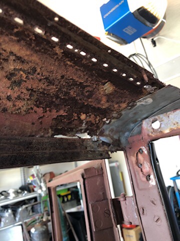

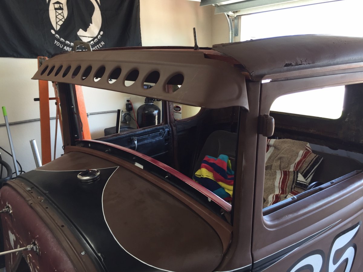

    IMG_8029.JPG IMG_8042.JPG IMG_8043.JPG IMG_8044.JPG IMG_8040.JPG IMG_8041.JPG
    Started tackling the rusty crusty rotten roof wood and panels. This girls seen some genuine hackery ,like the galvanized metal “patch panels” . It should be a good time getting her back in shape before the chop.
