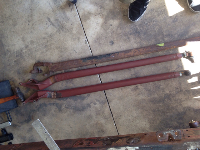

    We will be losing the late model rear bones and going with the 36 style using front bones from a 40 welded to the axle mount. Since this is a spring over I will shave the spring hangers off the ends as well as the rear end

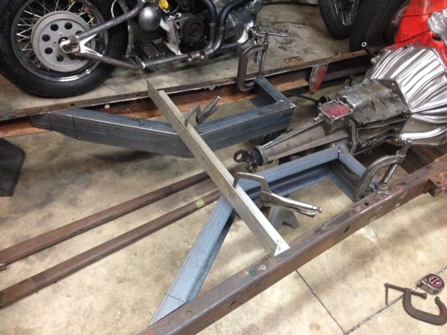

    Got some of the center member done
    All of this will be drilled for lightening holes and the rails will be boxed with matching plates

    Plans are for a lower plate that ties the rear wishbones to the same mount as the transmission and another plate on top

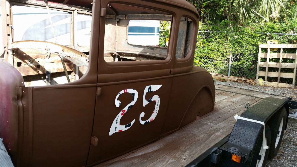

    IMG_2655.JPG IMG_2654.JPG IMG_2664.JPG IMG_2666.JPG IMG_2665.JPG My dad has been busy working on the body ,he got the number templates made and sprayed some flat rustoleum on it after sanding and a coat of primer. Jury is still out on whether to chop or not. If we do chop it it will be heavy around 6". My son would have wanted it chopped so I'm leaning towards that. He was very much into aggressive ,hotrods that performed good and looked the part. And I feel the same. Not a hotrod if it isn't fast ,and a little scary. I know he's watching so the pressures on .

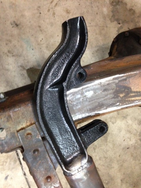

    Slow progress on the rear end. I got most of the work done on the rear bones. I didn't want to run a torque arm. I built these using front 40 ford bones welded to 36 rear peices. Then added the Dom 7/8 tubing to them to reinforce along with a gusset. The axle will break before these give us any trouble.

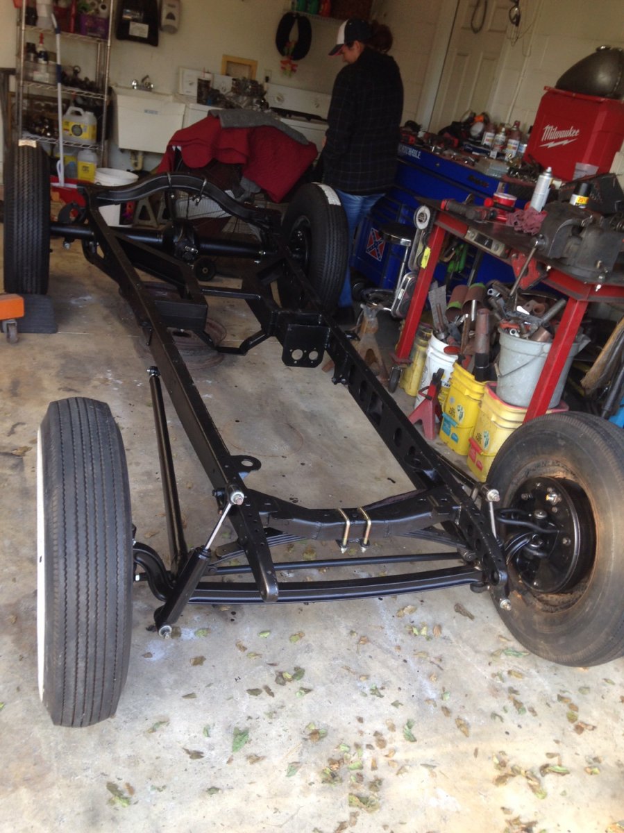

    Been awhile since I’ve updated this thread . But we built a house and moved since the start. Life gets in the way. But here are a few progress pics of the build.

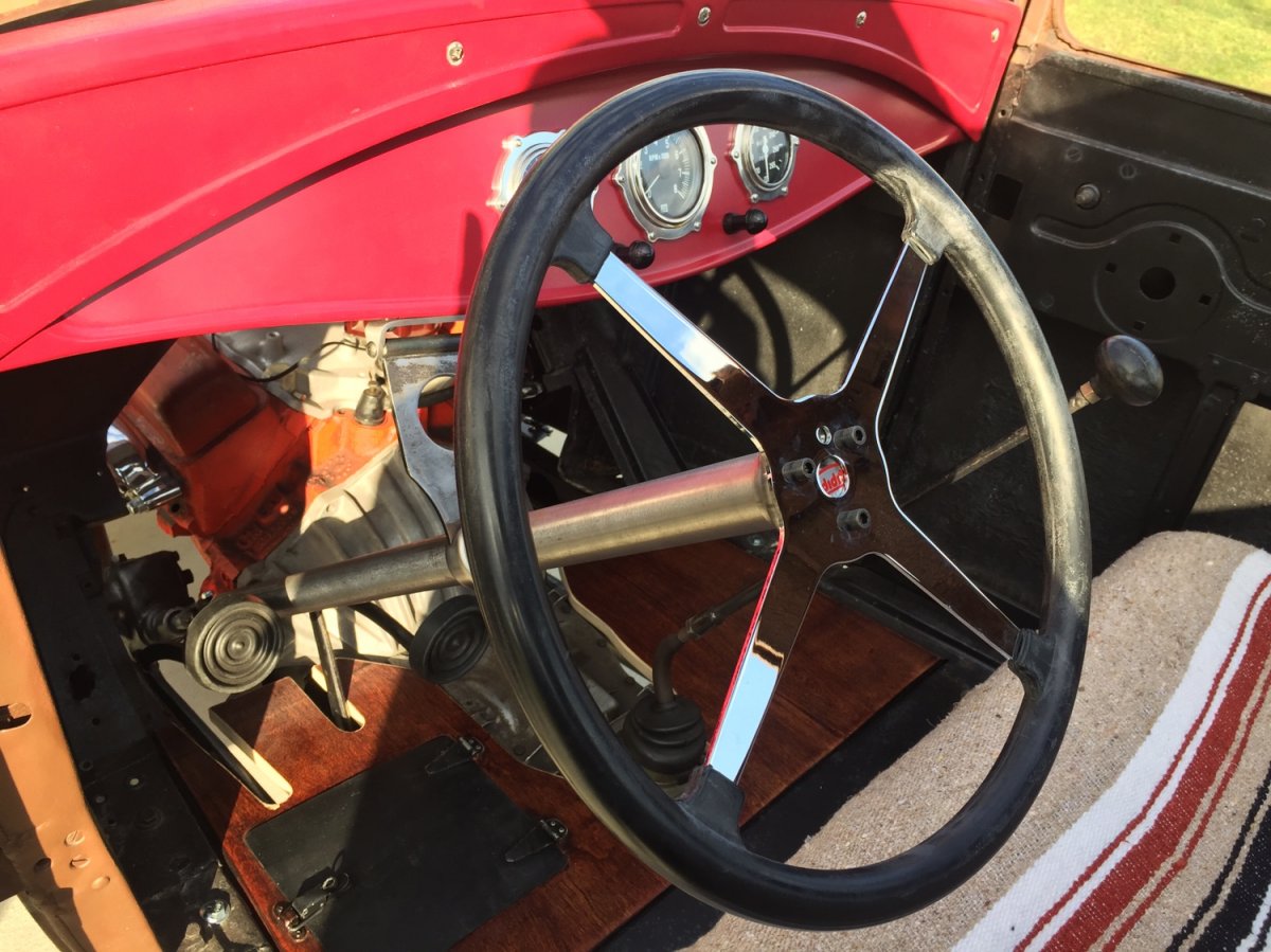

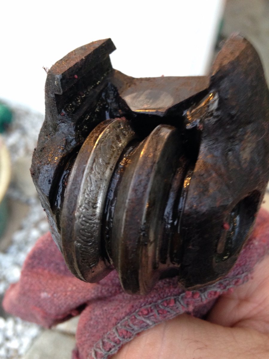

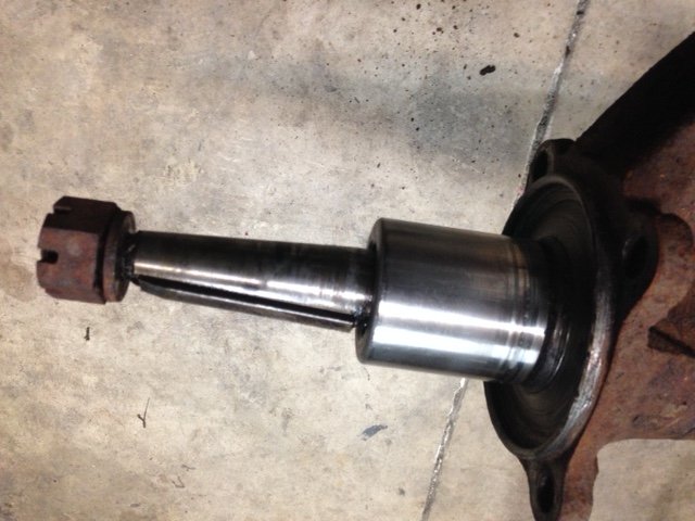

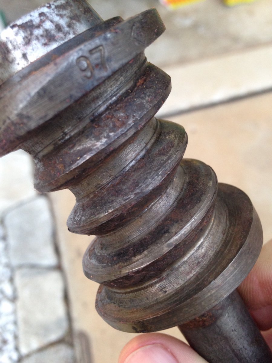

    Well like everything else on this car the steering box needed a complete rebuild. Opted to go with the aftermarket steering column and modified the drop to accept a fuel gauge because running out of fuel sucks.

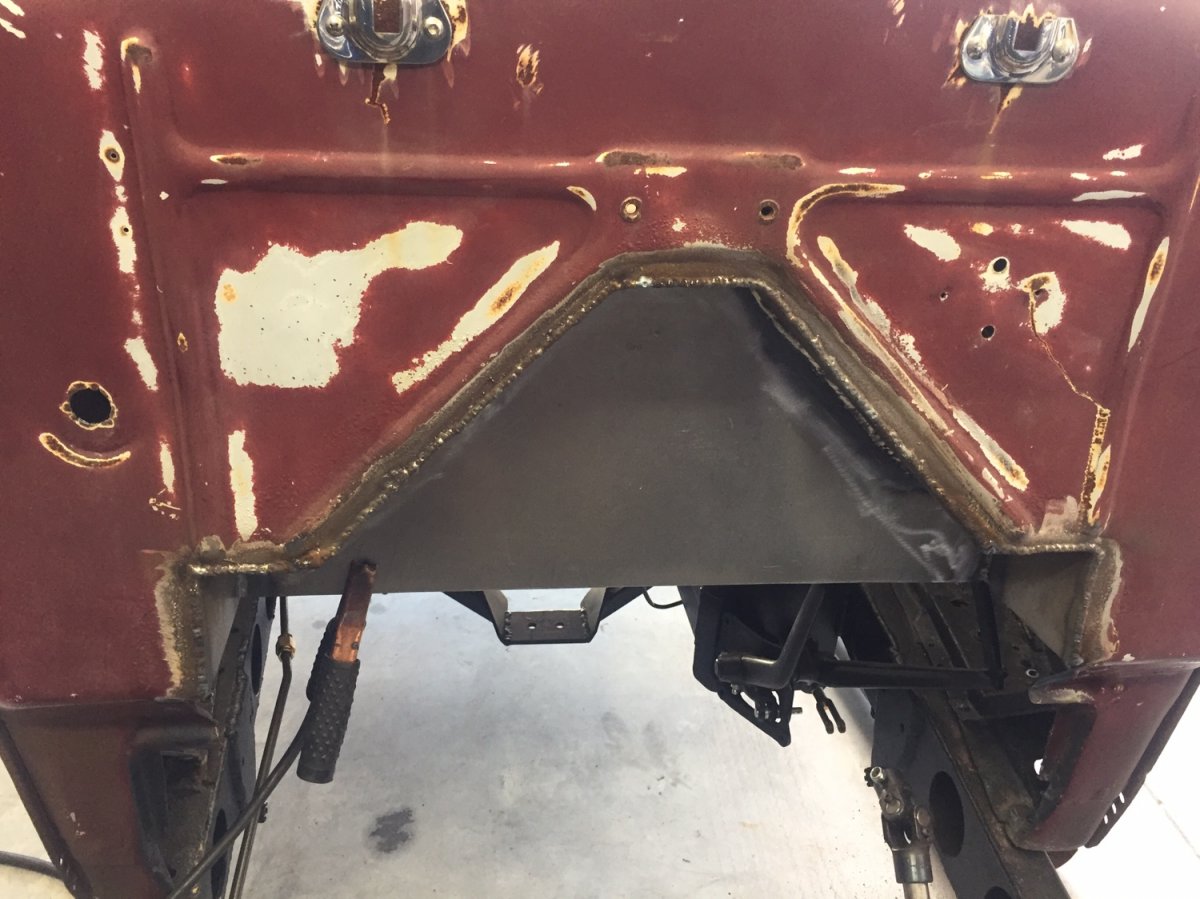

    When we decided to go with the 283 over the flatty we were pleased to find out the hurst engine mount allowed the Chevy to go right where the flathead was. But because of the stock model A frame and the fact we didn’t want to move the crossmember around , I had to recess the firewall. Also had to make a trans tunnel and toe board. This allowed us to use an original A hood and sides with the 32 grille shell

  28. slinginrods
    Joined: Oct 6, 2008
    Posts: 422
    slinginrods
    from florida
    It is an original f1 box I rebuilt connected to an Ididit aftermarket column.
  29. Stovebolt
    Joined: May 2, 2001
    Posts: 3,534
    Stovebolt
    Just wondering @sling392shot - how much meat was left on the original F1 steering shaft when you adapted the Ididit universal to the shaft?
    I looked into a double-D adapter, and there didn't look to be much in the way of the original shaft left to use - I may be wrong.
