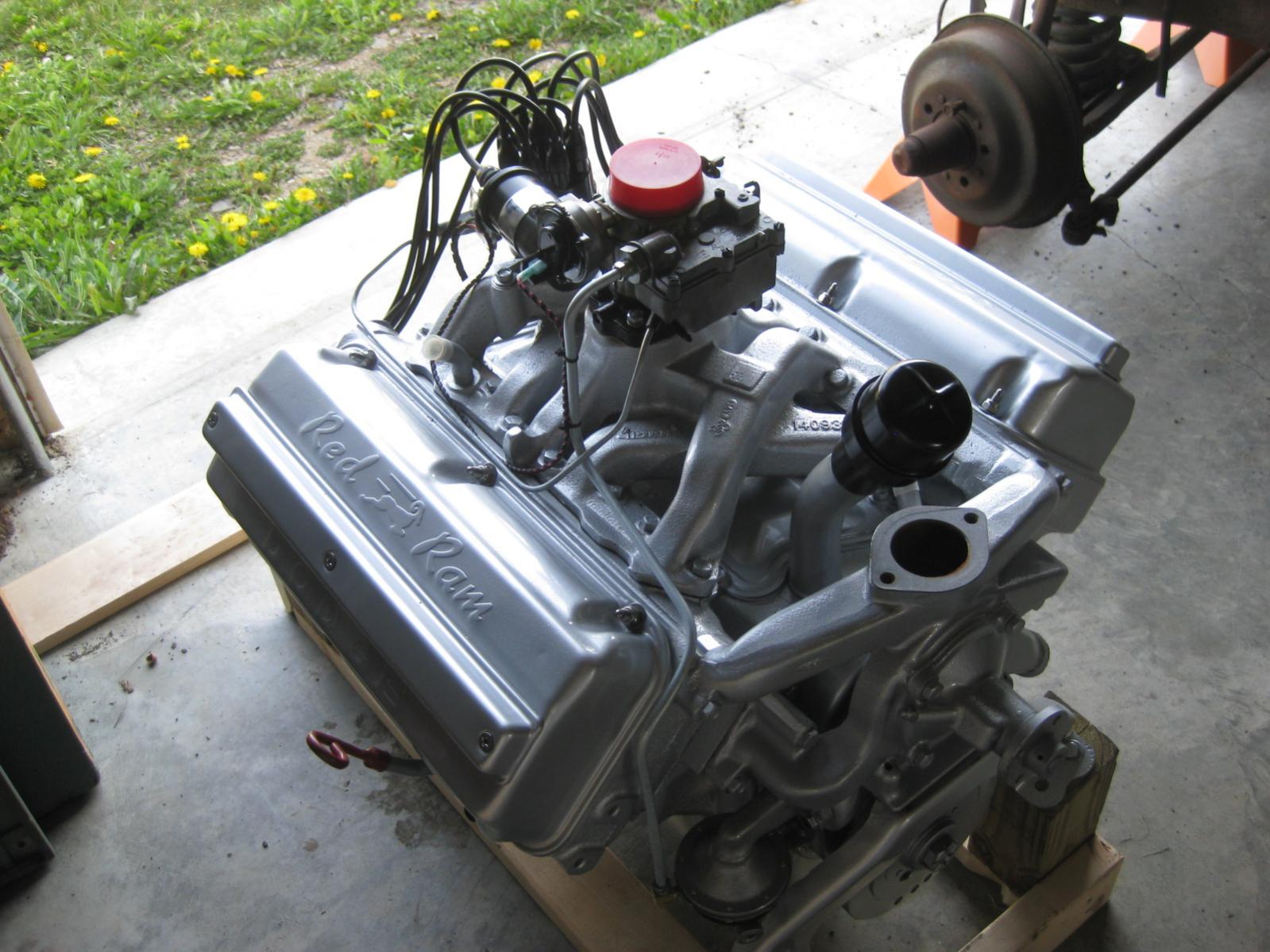

    I'm putting the final touches on my 241 Red Ram Motor and have a question. I stayed with the stock Dodge water pump but have a Mopar 318 Harmonic Balancer on the crankshaft. My crankshaft pulley which I need to replace because of the balancer measures 7 1/2 diameter. My stock water pump pulley measures 7 7/8 diameter. How important is it to keep with these sizes in my hunt for the crank pulley that now bolts up to the Harmonic Balancer. If it matters, The only 2 things the Crank will be driving is an alternator and water pump/fan. Thanks, Jim

    It's not very important to keep the exact size pulleys but they should be close. I would try to keep within 1/2" difference either way.
    Try to keep the sizes in proportion. If you change the ratio too much it could cause trouble. Driving the water pump and alternator slower will save some energy and possibly a little gas, but increase the possibility of overheating and undercharging at low speeds. At high speeds it won't matter, or maybe work better.
    Overdriving will have the opposite effect, better cooling and more juice at idle but more friction and more chance of cavitation and over revving at high speed.
