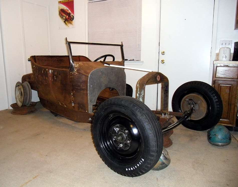

    As it was listed for sale, purchased from Flip in Santa Cruz via eBay. flips t 005 (800x600).jpg
    And delivered to me in Garland, Tx by BenD
    Not much room in the garage so it stayed in my living room until I moved to Rowlett. I collected windshield posts and chopped them, and a very nice polished V860 front axle.

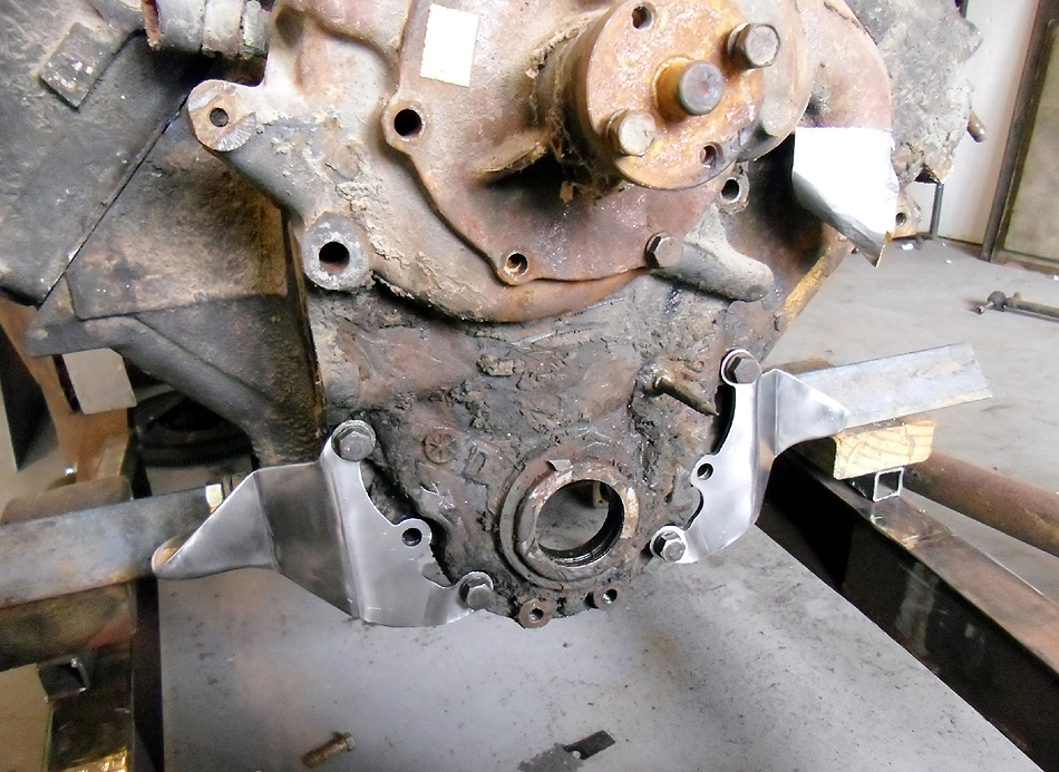

    Once moved the real work started. It was originally set up for a flathead but I picked up a '49 Olds 303 to use.
    Motor mounts modified from some available Hurst reproductions

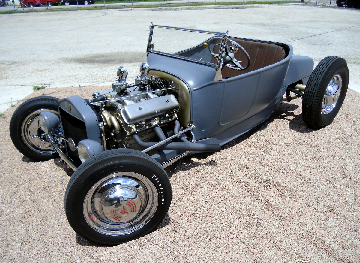

    The Monday after, Tim from Hop Up came and took some great pictures of the car. Then I just enjoyed it for a while, fiddled with a few things and getting it all to work right. I had a major driveshaft issue which I worked out, changed the fuel pump, added a couple leaves to the rear spring, some other odds and ends.
    This was a Dick Spadaro u-build it setup...guess the 303 had a little too much torque. It was replaced with a shortened solid shaft.
    Drove out to Wimberly with the Mrs. for some lunch
    It didn't take long for me to want to improve on the car though. I had gained a lot of sheetmetal fab knowledge and wanted to apply that to the car. Apart it came for a bunch of upgrades.

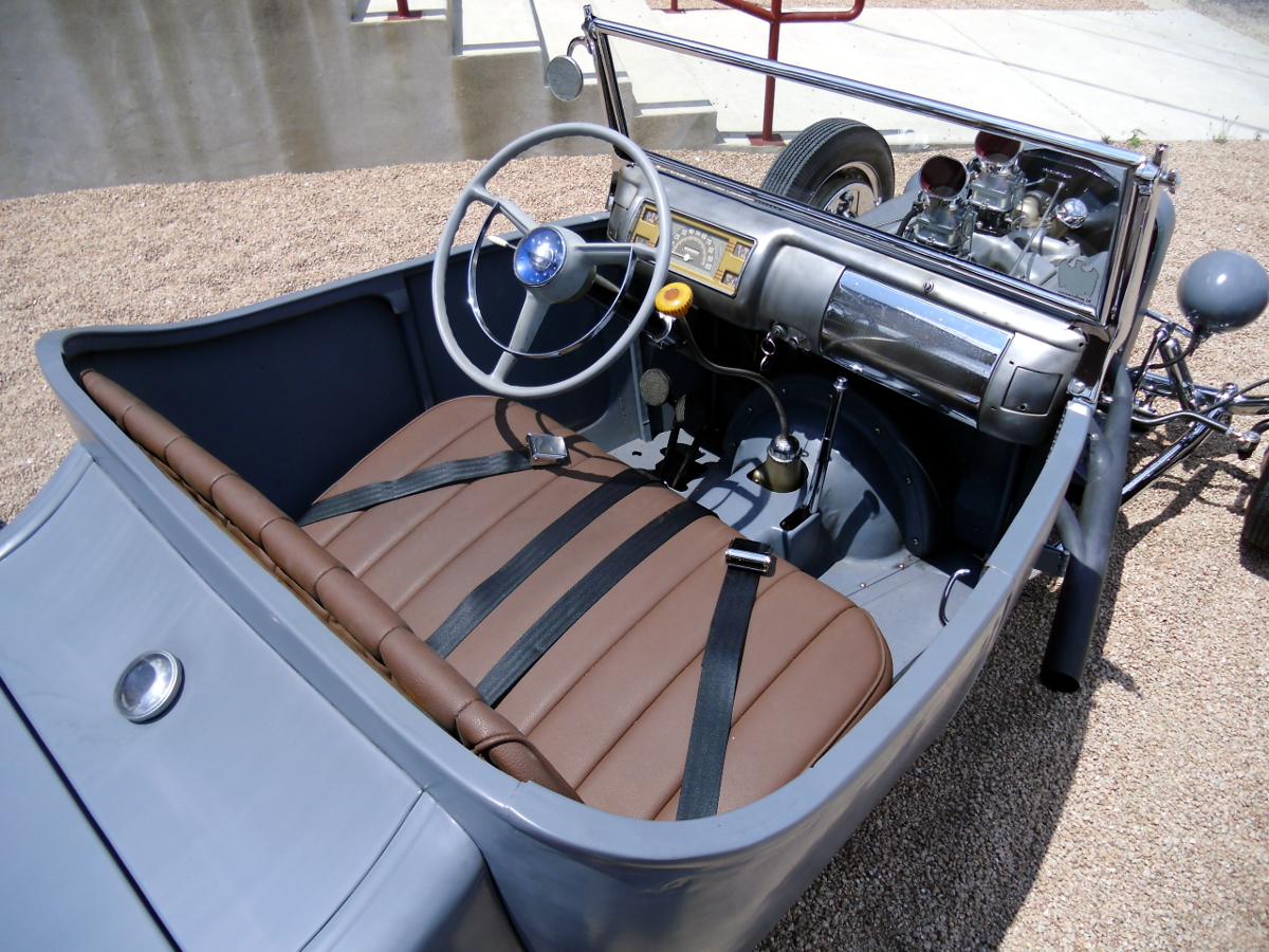

    Big change #1 was a '40 dash.
    The wheels I had on the car were 4.5" rear and V8-60 3.5" fronts. I worked a trade for a set of chrome 4" wheels and kept my tires.

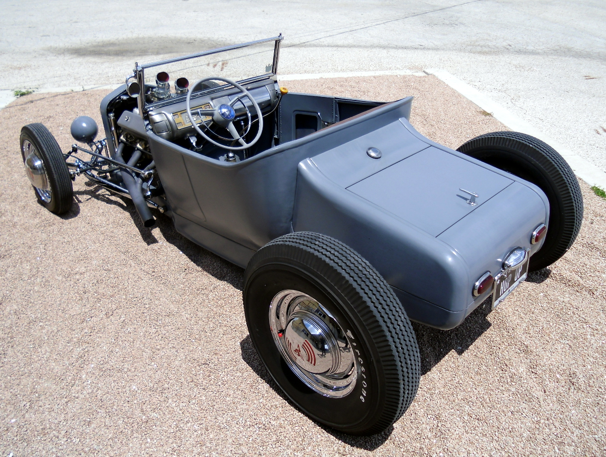

    I also wanted to try my hand at redoing the deck. I had seen a Ron Covell DVD on doing the same so I gave it a shot. Made hammer forms for the sides from MDF and plywood for the rest of the buck.
    I had access to a pullmax at the workplace and was able to punch the beads in the quarters.
    It was close in appearance as a stock deck but I didn't run a bead around the bottom or front edges and made the deck lid fit flush with model A style hinges and a '32 latch.
    Since I made the deck as symmetrical as possible, I found that the body tub itself was pretty far off from when I did the work the first time. Took a lot of cutting an filling to correct.
    I made new lower louvered filler pieces that fit much better as well.
    This sides belt line was never level to the driver's side as it should have been and the door was actually crooked in the body. I cut out and rebuilt most of this side of the car.
    I made a roll pan for the deck the same way as the deck itself and bolted it underneath. It has a notch just enough to access the quick change.
    Another change was putting a reproduction early Corvette steering column in. I wanted turn signals (though they were never wired) and to use the Oldsmobile wheel.
    I had to get another fuel tank to modify and relocate the filler to the center which I thought looked better.

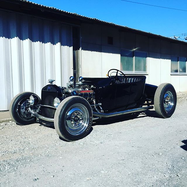

    Let’s see. Now we have this.
    382F6E77-2768-47C2-8D57-17A61483F977.jpeg 570E084B-3728-4672-AF69-376DD341424B.jpeg
    But first we had this.
    Maybe I’m the only one but I’m just not really liking the Japan version of the car.
    I thought it was pretty much perfect the way you built it to begin with Eric. :cool:
