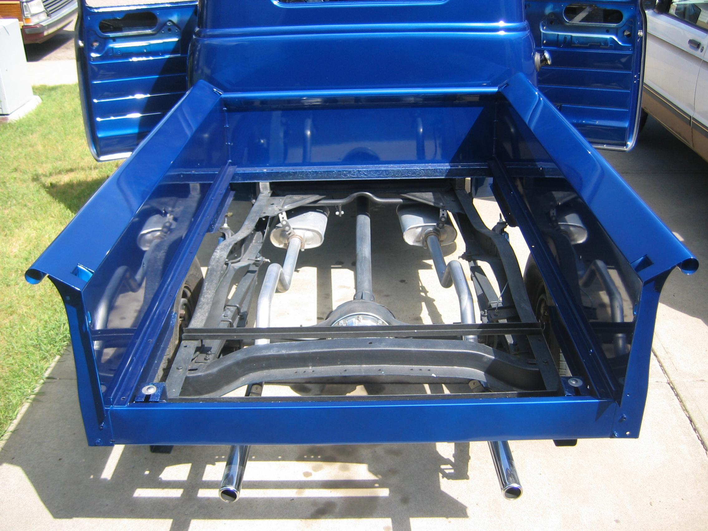

    I think you are heading in the right direction. Here's my thoughts coming from a daily driver only vehicle, close to 15 years over 70 k miles. 2" exhaust to an 'X-pipe' or an 'x-muffler' (Summit sells one, it's 2 in two out with a perforated "X" inside the muffler. I'd even send the pipes out the back on the same side (driver's). I LOVE the x-pipe, let me repeat, I LOVE the x-pipe, I'm going to try that x-muffler as I described above the next time.
    OH, presently I have Fentons, x-pipe just after the bellhousing crossmember, 6" of pipe then twin 30" cherry bombs ( don't know what they are packed with). This system has been on for over ten years, is not too loud, remember daily, only vehicle and I take my '49 1/2 ton on 1k trips several times a year, engine is a '56 235 as below....

    I'm not a fan of the raspy sound either. I went with 2-2" into a merge with a 3" outlet and a single flowmaster. It had a deep tone to it. Kinda sounded like a V-8 at idle and a nice mellow tone cruising. There are a couple you tube videos with this set-up, search 235 start-up and you'll find them.

    I know 'H' comes before 'X' in the alphabet. I have read about some of the pros and cons of each setup and decided for the H setup. Main reason was because the " do it yourself kit" I got only had the 'H' included in the kit.

    Didn't mean to come off as a wise ass. I have a'49 Chevy 1/2 ton as well, daily driver only vehicle for 15 years with a 235, Fentons. Think of two hard rushing streams running parallel, then you put in that 'H' connector, the streams are going to rush on by. Now keep those streams tight together and put an "X" in there do you see how the pulses cancel out and improve the flow?
