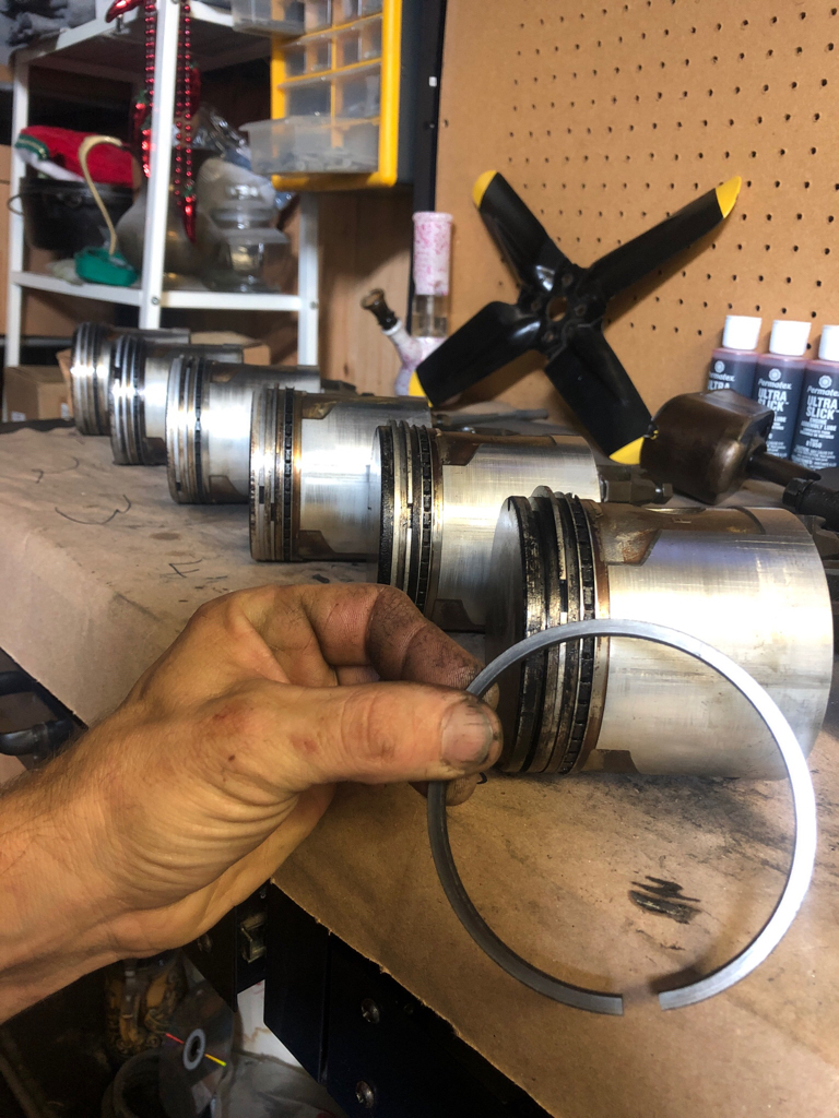

    My question right now is, what’s you guys preferred method for cleaning cruddy pistons? Once I got em out I realized they appear to be aluminum, so I’m leery about using a wire brush. The rings also look to be aluminum. I was able to get this one off just using my fingers... is it aluminum? I’m not planning on replacing them because I think they look good. Sharp corners, no scratches on the flat surface that goes against the cylinder wall etc...
    But how would youz guys reccomend cleaning these pistons?

    Nevermind on the rings, just hit em’ with a very weak magnet. They’re steel. Pistons are aluminum though.

    The rings are cast iron, except for the oil rings, which are either steel or stainless steel. Being cast iron, they will break if you try to bend them too far, so be careful. But you probably want to replace them anyways, of course you'll want to hone the block, and before you get too far you'll want to measure the taper in the bore, and you'll decide that since it has .007" taper you probably want to rebore the block and get oversize pistons...and it never ends. That's why I suggested you just put it back together again, before you got it this far apart.
  4. we used to soak em in diesel fuel and brush with a firm plastic bristle brush
    we also used a ring grove cleaner
    re-hone and re-ring
    enjoy

    Carb cleaner - the kind in a bucket, not the bomb can.

    I've good results cleaning piston tops with the 3m scotch pad. I'll see if I can find a link.
    No luck finding a good link, but basically a pad that I chuck in the drill.

    Thanks for the replies! Of course squirrel was right, I have new rings on the way. Taper is still good, barely .001 on the worst cylinder. So, new rings, deglazing hone, new bearings and back together she goes. Will update and post photos along the way.

  9. You’re gonna do great,,,,,no problem at all.
    I always clean the pistons in some Berryman Chemdip if you can find it.
    The ring lands are what is most important,,,get all of that area clean,,and the rest can be cleaned by hand. It will help the rings seat back in very well,,,if the lands and rear area are clean. It lets the gas pressure get behind the ring and help seal it against the bore.

    There is a ring groove cleaning tool out there, and they usually will fit several sizes of ring grooves. In a pinch, you can break one of your old rings, and use a piece to carefully clean the ring grooves.

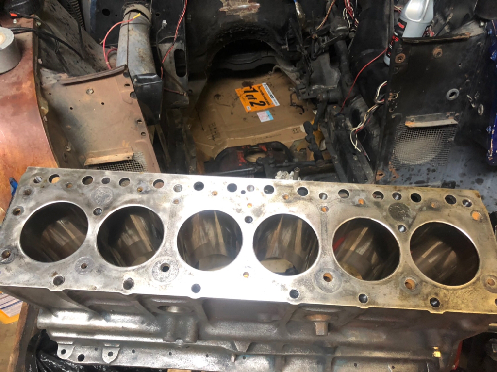

    I’m taking the block to be hot tanked and having the deck milled flat, new rod bearings on the way, and a very slightly lumpier cam coming. I want to replace the camshaft bearings too since I’m putting a new cam. Figure why do all this work and leave the old camshaft bearings. These seem like a pain in the ass to replace. I should just have the machine shop install these, right? [​IMG]

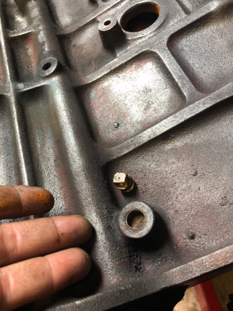

    Also, this plug... I took this plug out and there’s nothing behind it. Just more cast iron. What’s behind the cast iron? Is it pressurized, or is it return oil? [​IMG][​IMG]

  17. That plug is the drain f0r the water jacket. once you hot tank the block the cam bearings are ruined. So by all means have the machine shop replace them. When you get the block back from the machine shop it will appear clean. It isn't. You need to run a rifle brush thru every oil passage. then wash it with a high pressure washer. blow it dry and spray it with WD 45.
    indianbullet, prpmmp and Truck64 like this.
  18. Great to see a 235 being rebuilt. Great little engine. Can’t wait to see your progress. Love driving mine in my 53. Super reliable and a change from the usual 350 you see ...
  19. Camshaft bearings are not hard to install, but it requires a special set of tools. If you don’t build a lot of engines, have the machine shop that boils your block out do it. By all means, heed Oldwolf’s advice on using rifle brushes to go through EVERY passage with soap and water. Also use taps to chase all the threads in the block. Clean your head bolts off with a fine wire wheel. One day when my Babbitt banger 216 gives up the ghost in my 1950 3100, I’ll build a full pressure 235 for it.

  21. With that plug out,,,,check a little closer.
    Take a screwdriver or something and push a little on the area behind the plug.
    It is sediment,,,looks solid,,,but it isn’t.
    That has been my experience anyway.

    Oh yeah, I must have been tired. Thats where the return water from the intake manifold heater is going to go.
    Thanks!
