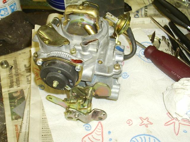

    A while ago, I posted wondering if anyone knew whether or not a carburetor from a newer Chevy 194, 230 or 250 six cylinder engine would work on an older Shitbolt six, and never got a clear answer, so I figured I'd just try it and see!
    The 235 came with a Rochester one barrel that, like all Rochester carbs, ran like shit, leaked like a sieve and delivered horrible gas mileage. Add in the fact that the previous owner is one of those folks who suffer from an acute case of filterphobia, and you know it won't be long till a new carb is in order!
    Having had plenty of experience in the past with late 70s vintage Chevy 250 engines in a plethora of Novas and Camaros, I already knew that the best carb for THOSE engines is the semi-ellusive (these days) Holley Economaster replacement 1v carburetors. These fit in place of the awful Rochester carbs and boost fuel mileage and performance CONSIDERABLY on a 250 Chevy six, so I reasoned that it might be a good upgrade for a Shitbolt six as well! The only questions remaining now were could I find one of those carburetors and would it work on this car (55 Chevy)?!
    Lucky for me, Mayfair Speed & Machine Shop just happened to have a selection of NOS Holley Economaster carbs on hand that Dan dug outta the back room, and in the pile was one brand new-in-the-box Economaster 1v designed as a direct repplacement for 1977-78 Chevy 250 six cylinder engines...just what the doctor ordered! I was able to buy it stupid cheap, so the next quandry to address was making it work where the original Rochester failed so miserably!
    The first step, of course, was to rip that leaky old stock carb off and throw it as far from the vehicle as possible! Then, I was able to cut the steel fuel feed line and install a Wix 5/16" universal fuel filter, as the previous owner should have done!

    The short answer is yes, the carburetor bolt pattern is the same on a late 70s 250 six cylinder 1v and a mid 50s 235 1v, so the Holley does physically bolt onto the 235 intake manifold. But, the throttle linkage is not compatible, obviously, which means some engineering is required to make it work.
    Whenever possible, I like to come up with a way to NOT modify the existing linkage, and also to NOT alter the carburetor itself...if I can! That way, a stock carb could always be put back onto this engine (why is beyond me, but it could)...and that obscure Holley carburetor could still be used on a much better 70s era 250 six if it ever had to be! Fortunately, after setting the new carb on the intake and staring at the linkage rod for a few minutes, I got an idea and set out to make up a linkage adapter that would bolt to the Holley using two existing holes on the carb linkage and also mate up to the stock 55 Chevy throttle rod.
    I found a piece of scrap metal (an old radio bracket of some kind actually) and cut, bent, filed, shaped and drilled it till it fit the need...then attached it to the carb using a coule screws, nuts, washers and lock washers. Naturally, I built a little bit of adjustability into the bracket in the form of slightly oversized holes so I could fine-tune the fit if neccessary...I mean, the car was in the driveway, and I was making the bracket in the garage at the workbench, so a little bit of my trademark "eyeball engineering" was employed, but the bracket turned out great and, as a bonus, it even fit and worked as I'd hoped!
    (the silver piece on the goldish colored bracket is the new piece I made, just to show you what you'll need to whip up to do a similar swap on your 235).

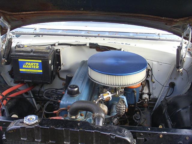

    Hey! The rain finally stopped today, so I could button up the carb swap on this car! All that was really left at this point was to hook up a keyed 12v power wire to the electric choke on the new carburetor, and then put an air cleaner of some sort on it!
    The wiring was a simple task, so lets take a look at the air cleaner installation:
    Luckily, Holley is gracious enough to provide you with a nifty thick white plastic air cleaner spacer/adapter, which slips over the carb opening and accepts a GM two barrel air cleaner opening. I placed a common Mr Gasket 2v to 4v air cleaner adapter on top of the Holley 1v spacer thingy and that paves the way for you to run any common aftermarket 4v air cleaner you wish!
    Here we see the pieces laid out for your inspection, followed by a photo of them set in place with a typical "low profile" 14" aftermarket performance air cleaner base.

    I had an old Mr Gasket "Rodware" 14" blue annodized air cleaner lid on hand (one of several parts designed for Mr Gasket by the late John Buttera back in the 80s), so I picked up a new 14" air filter element from work today and made a receiver for the "smooth top" air cleaner lid by using a short stud and a 1/4"-20 treaded 'barrel nut' with a jam nut to keep things tight. The filter top spins into place and snugs down to seal the air cleaner assembly without a wingnut sticking through the top.

    After starting the engine and adjusting the idle speed, I drove the car around town for a couple of hours and although it's still a Stovebolt (single-digit horsepower with 0-60 times measured in minutes and delivery-truck gearing!), it didn't spew gasoline, didn't flood out and stall, and probably got better fuel mileage than it's ever gotten in it's life! The Economaster is a big improvement over the stock Rochester carb, for sure...and (if you can find one!), it makes for a simple and affordable upgrade!
    Maybe this'll tide the car over till a new motor takes the place of the old six banger?!

    Gee what the heck is the grenade attached to the manifold for
    ..... just in case the mods don't work and you want to make the stovebolt into a steaming pile of twisted metal or what? :p
    Or maybe in case of zombies attack :eek:
